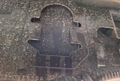

I don't have a 7 pin, but I'd say it's normal for Ford. Look at this photo where the 7 pin would go if I had one. probably no way to accidentally put it upside down.
Ford Ranger Trailer Connector Upside Down -Is That Normal ? j2ntuuot
