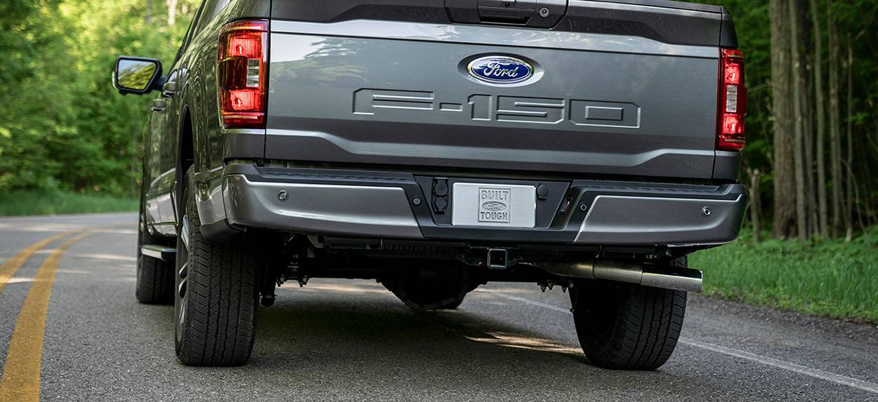

On my F150 Platinum from ground to top of ball was 20"
Ranger with same drop and ball is 22"
Is the Ranger higher at the hitch than the F150 or am I overlooking something.

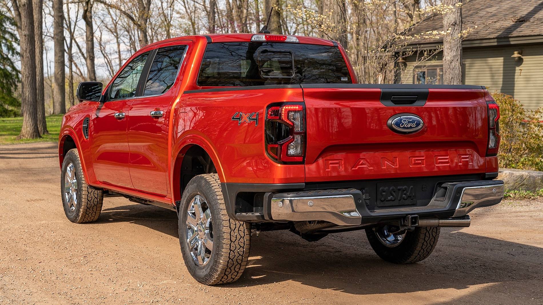

I don't think you are overlooking anything. Just because a truck is larger, doesn't mean it has to be higher off the ground. The factory hitch is also really tight to the bumper on Ranger. The top is even with the step in front of the license plate.
The F-150 receiver is below the top of the step.

So to get the same ball height with the Ranger I need to drop 2 more inches.
