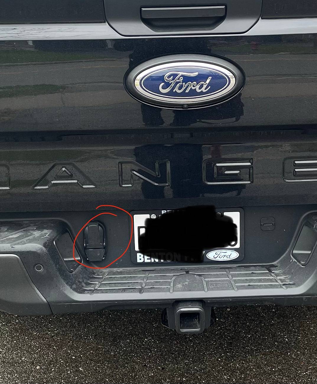

I don’t see what you're trying to show me. Can I get a close-up? Maybe I got that as well

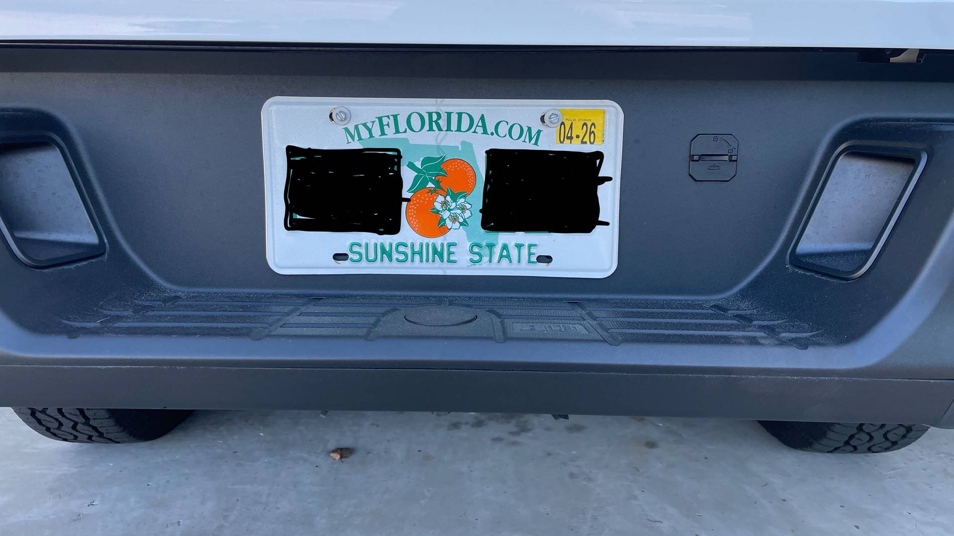

On mine as well, they put the wiring pins besides the license plate as opposed to underneath the truck.
Just left of my licence plate is the 4/7 pin connector. Just click on my pic and it should enlarge so you can see it.
Yeah I see it now. I don’t got that. I should have gotten the hitch during the ordering ?

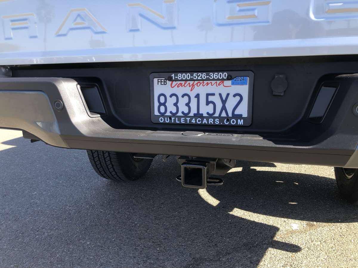

I have the same cutout or what have you on the right side of my plate which you can see in my picture. I’ll poke my head underneath tomorrow and report back with a picture.

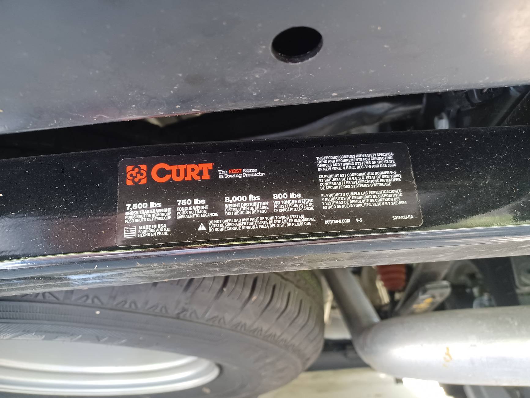

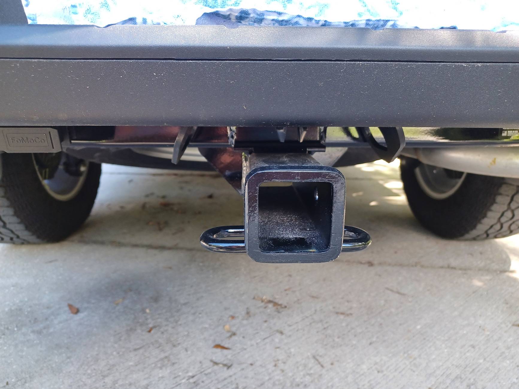

I bought the Curt C82ZV hitch from etrailer and it's an easy install with only 4 bolts.
Post some pics, so that others can see. I bet it looks good and gets even more attractive when people see how much easer it is to install than the OEM version.

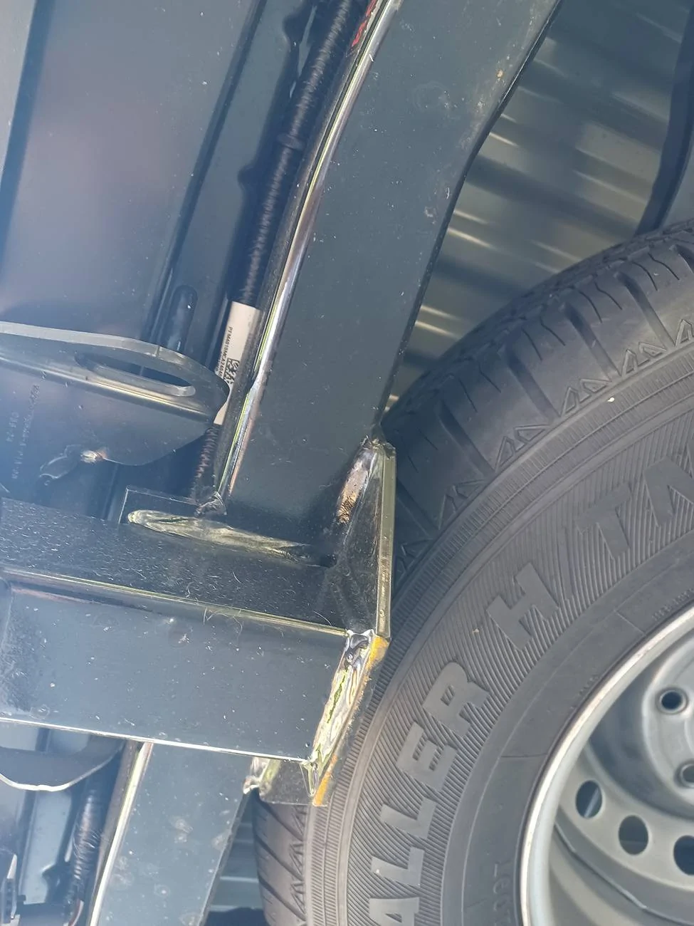

The install looks the same as it was on my 5G. I clamped the tabs off the side of the bumper bar to keep it in place. Torquing the bolts to 196 ft lbs was not fun lying on the ground, but doable :)
You're lucky you got that type of hookup, they put a female 4 pin flat connector up under the bumper and I smash my hand trying to pull the connection from the trailer out. This is going to change very soon!

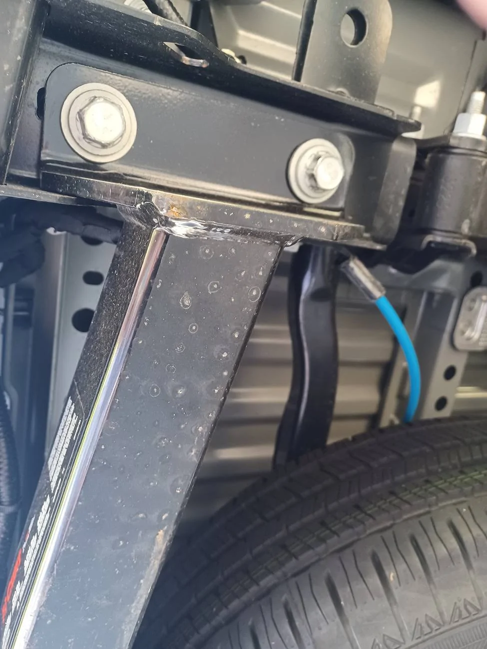

This was a very easy install even with no help available. The hitch is pretty heavy so I jacked it up in place with my floor jack. As you sad, torquing the 4 bolts (2 on each side) to 196# is not easy! I attached 4 pics

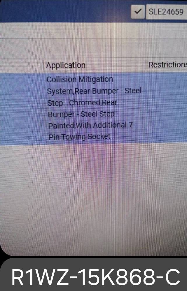

That is the # needed for the harness for rear bumper to plug into a pin 7 outlet you put on the rear bumper. 2025 ranger xlt
Part # is hard to find because description describes something different. But indeed works. Just installed.

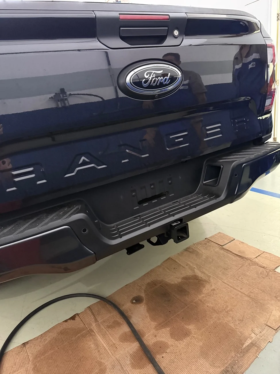

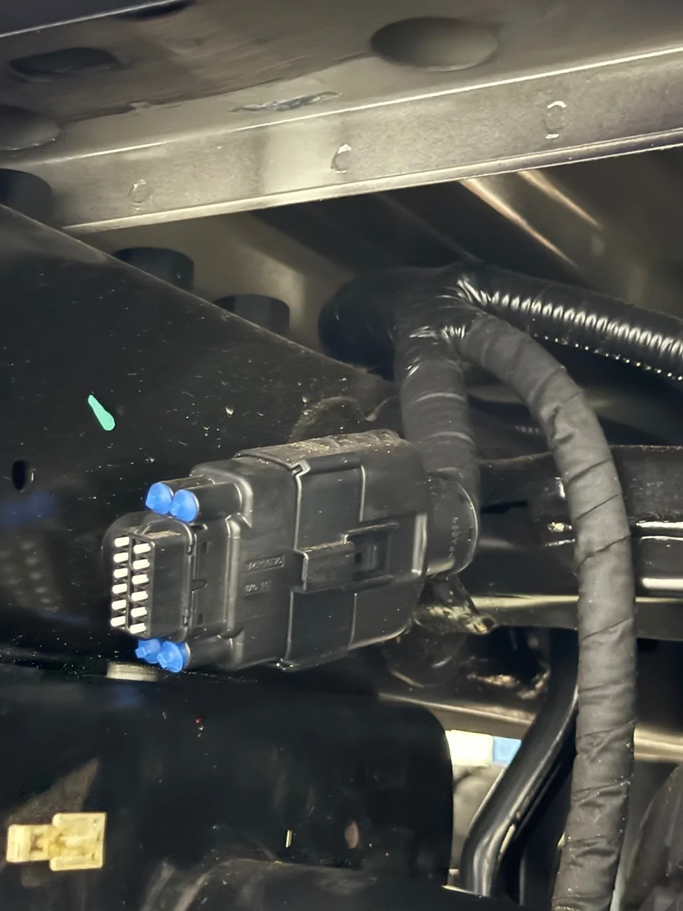

I was able to buy the towbar and the 7-pin outlet from a crashed ranger and when installing it I found a connection plug under my car and connected it hoping it would work right off because I have the towing menu in my sync4 screen.
It did not work so I decided to scan a friend's Ranger to see if there was something I could change on Forscan so it would work. I activated everything related to trailer but nothing changed. Then I realized my friend's car had a module called TRM (Trailer Module), and mine didn't.
