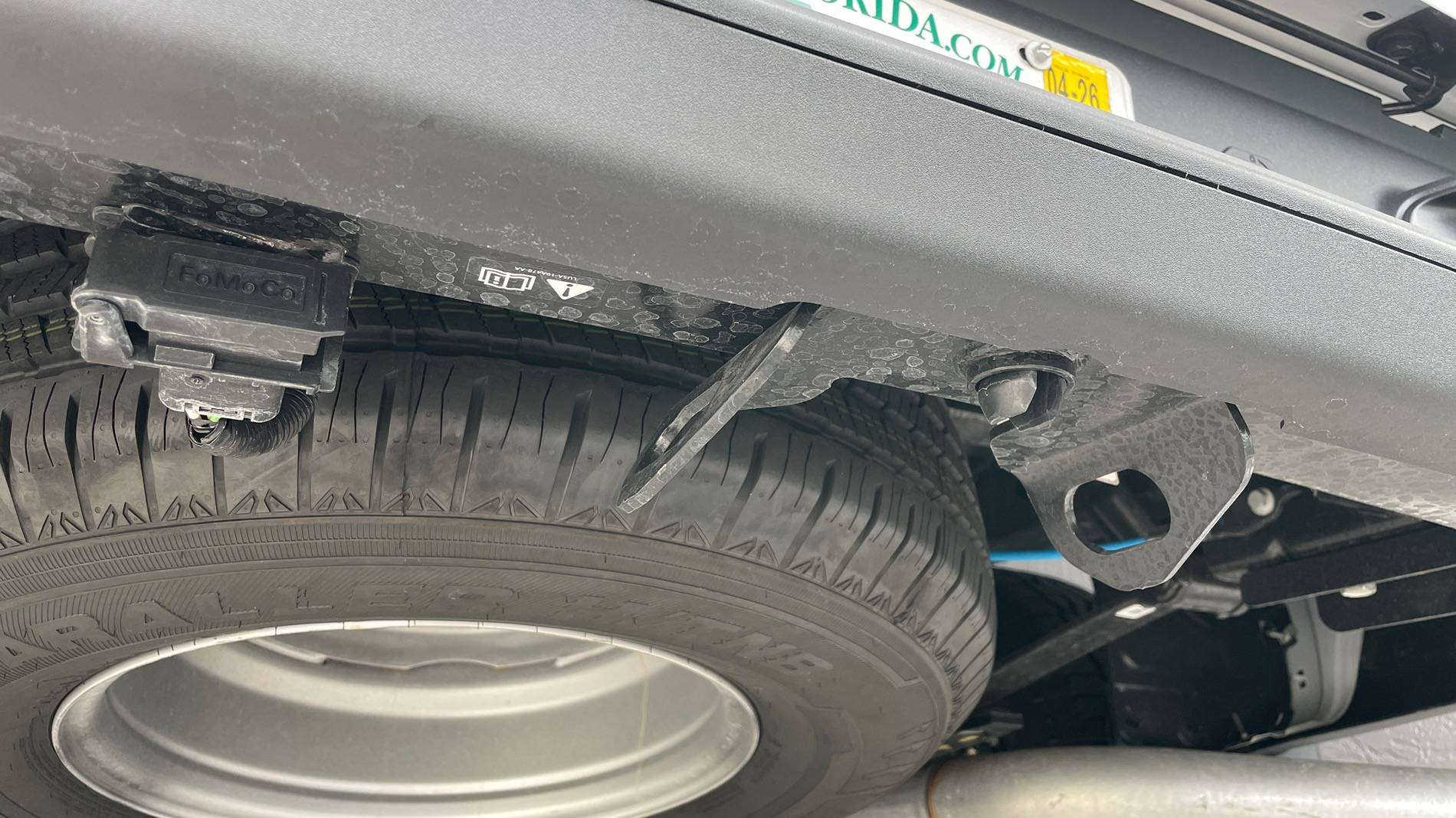

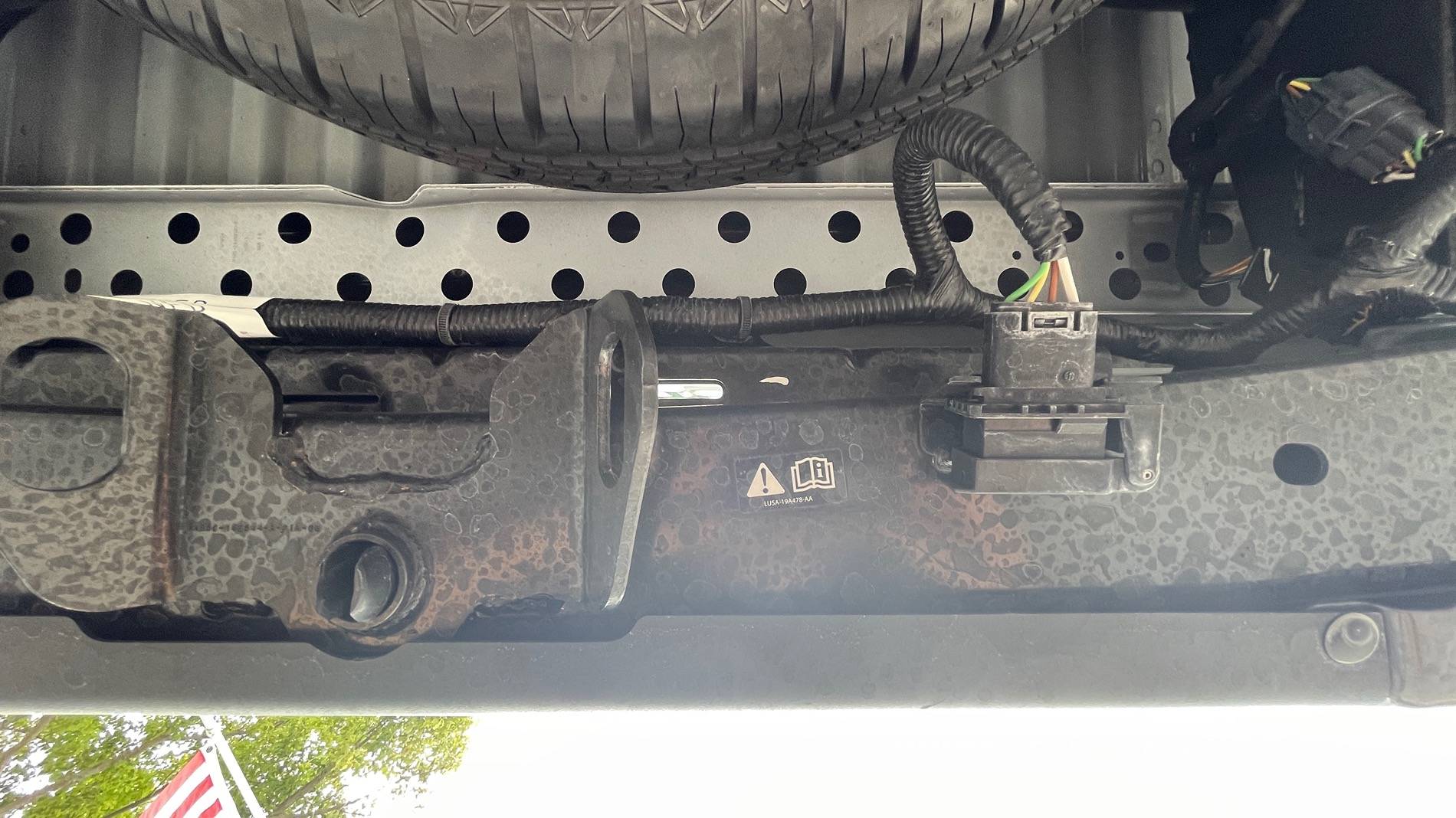

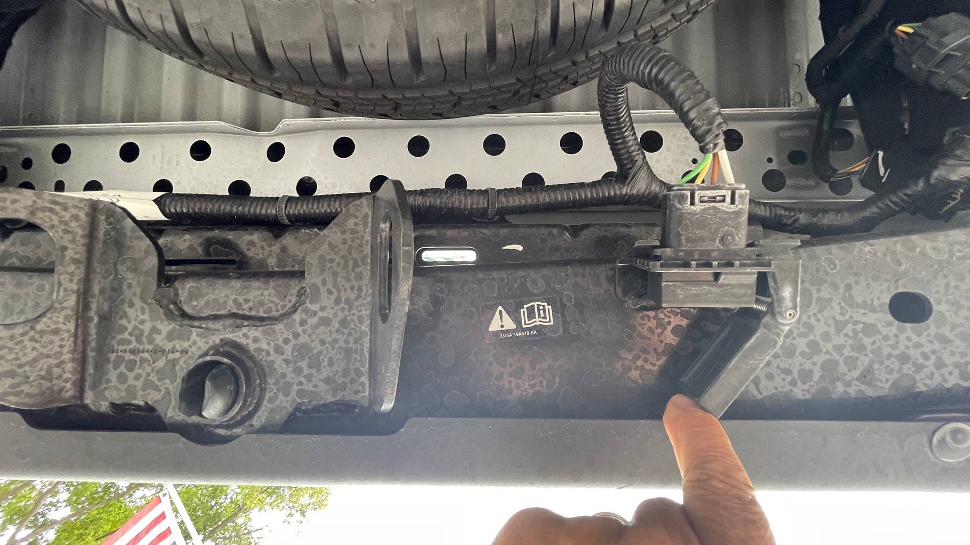

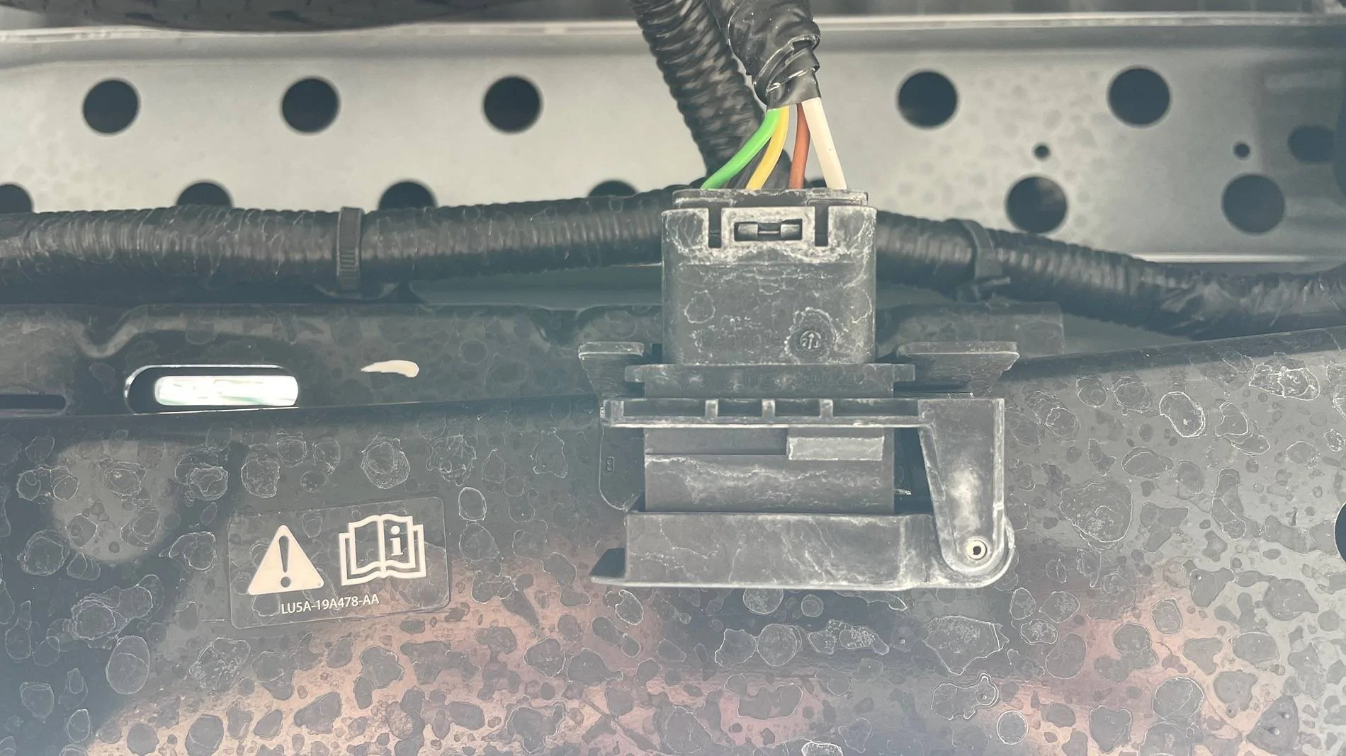

So while I was under my Lariat looking at how to drop the exhaust system to paint it black I noticed this electrical outlet on the back underside of the bumper and I think, and please correct me if I’m wrong, that is where you would plug in the trailer hitch wiring for breaks and blinkers only. Thoughts?

Yes, you are correct the same is on my 2024 even though I didn't get the trailer towing package. Even my dealership told me I was better off buying an after market IV. hitch than paying big bucks fr the Ford hitch. I am installing a Curt #13607 that is made for the 24-25 Ranger.
