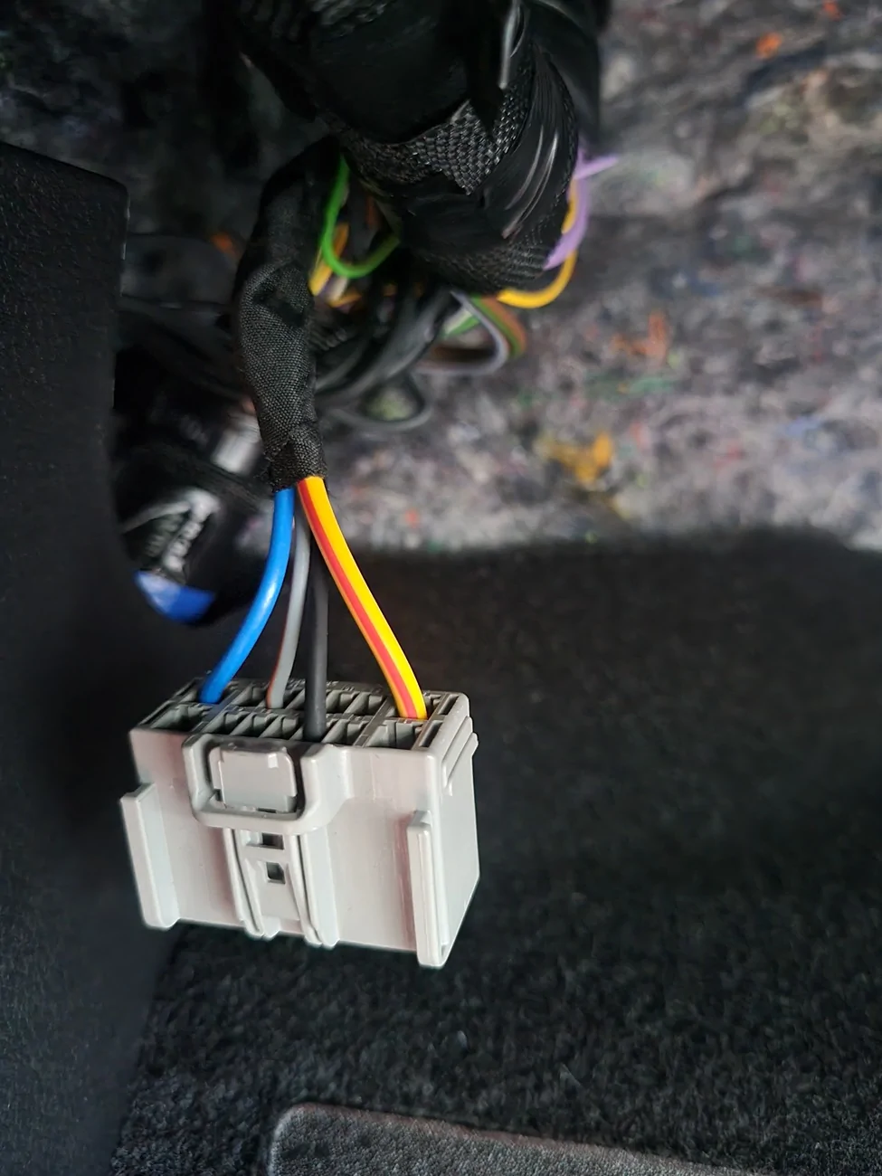

I will take a pic tomorrow, you also should have a connector that looks like this as well, it is the one that is for the 7 pin. New harness plugs into as well.

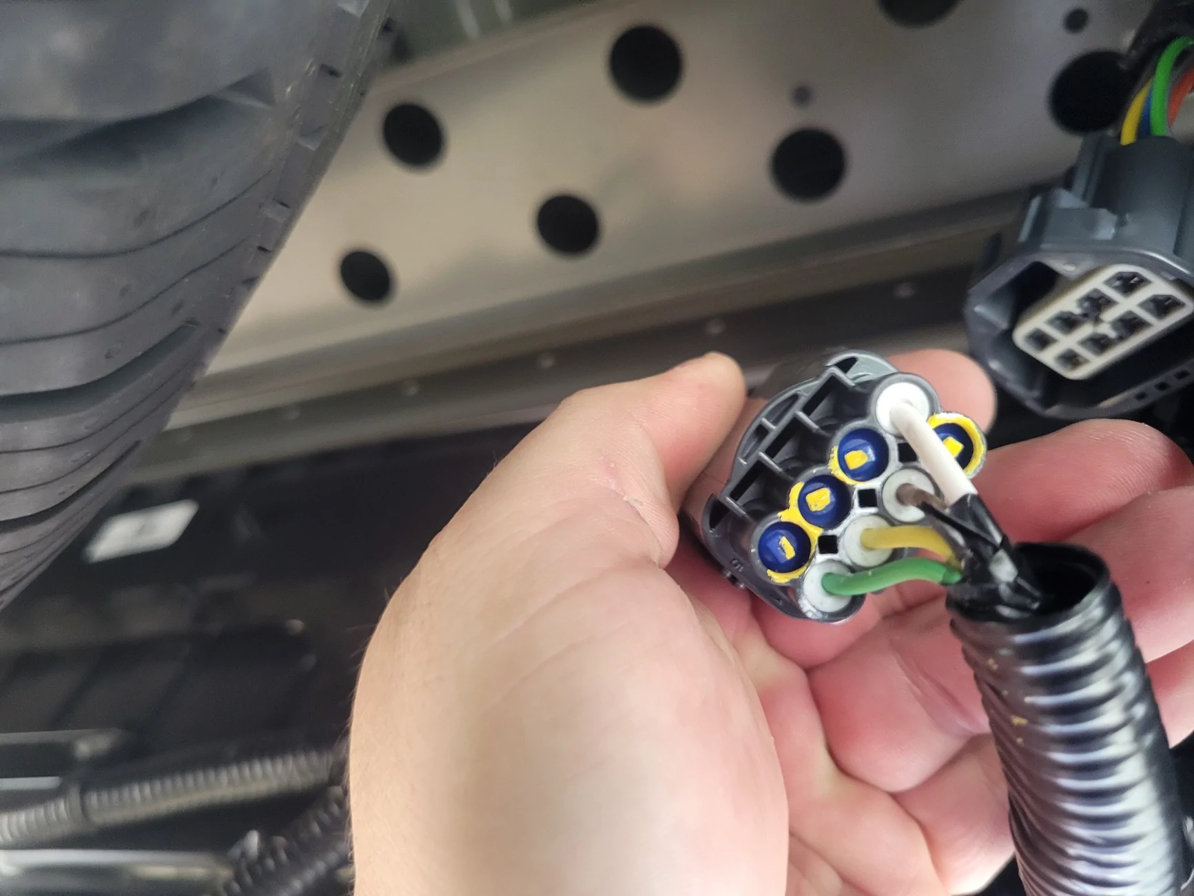

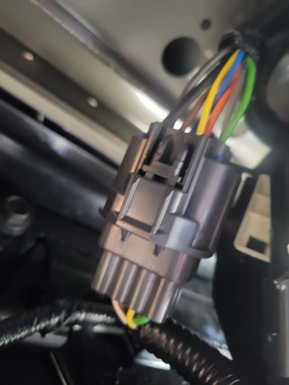

This is the harness I removed that was for the 4 flat.

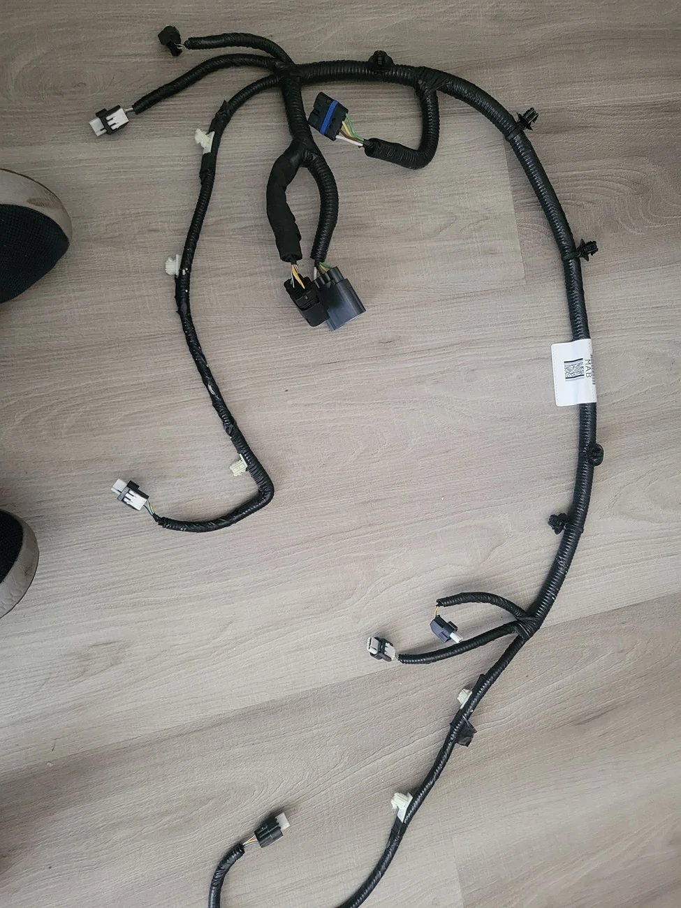

This is the new harness on the truck

Don't forget you still need a brake controller. That get plugged in next to kick panel on driver side.

Well unfortunately Ford has that harness bundle into the the back up sensors, so that is what I had to get.🤷‍♂️

Yeah, I took another look at the harness on my truck. I see that the 4-pin wiring is also wrapped in with the rest of the harness.

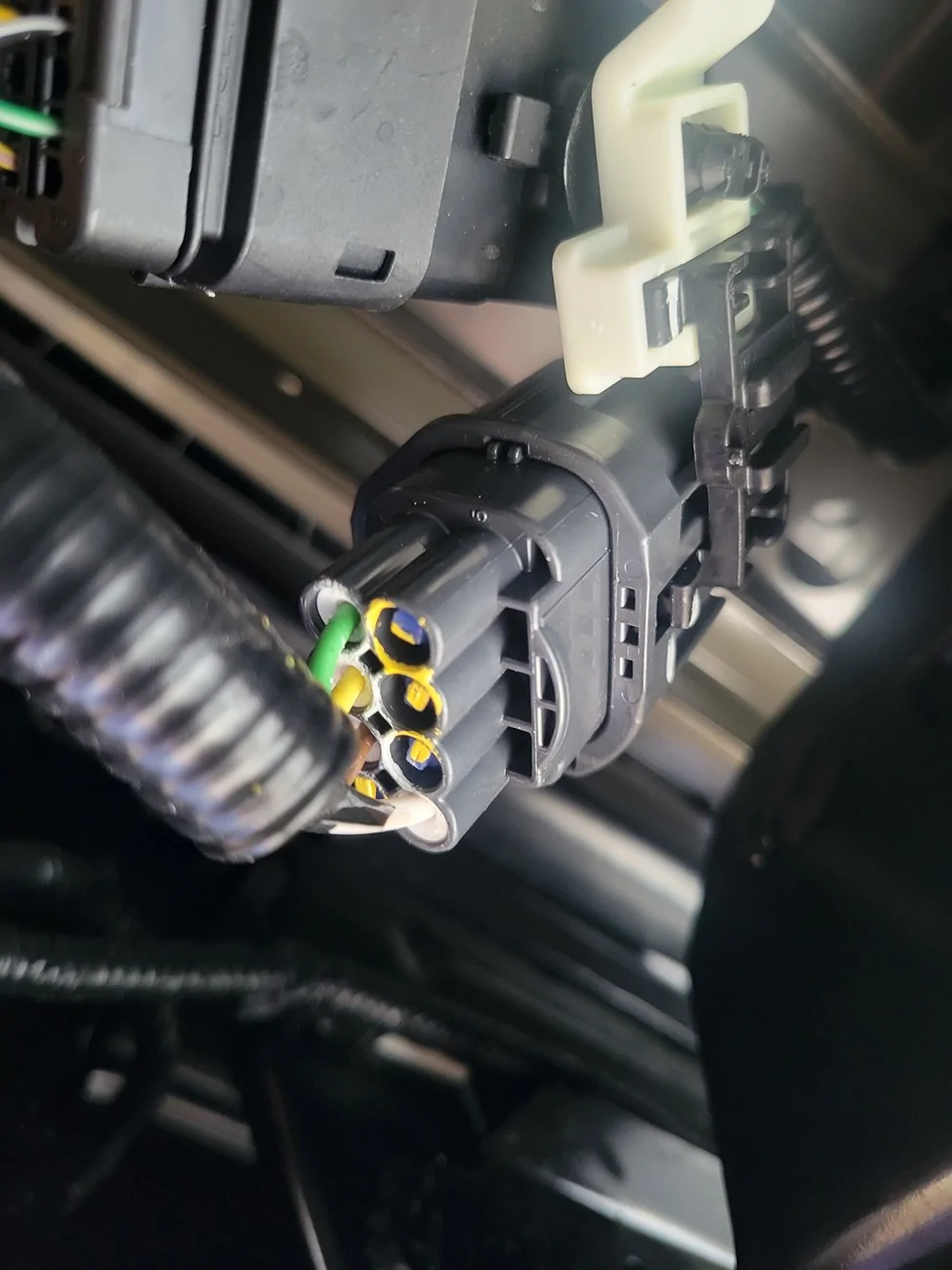

I cut the OEM 4 pin plug off (under the truck by rear bumper), I left about 6" of wire from that plug.
I took the Curt 7 pin plug and pulled the plug apart (it's the same plug as the OEM 4 pin plug)I also pulled the OEM plug apart and used the OEM pins and inserted them into the Curt 7 pin plug.
Once all the wires I needed inserted into the 7 pin plug I soldered the wires together. The 7 pin Curt plug already has 4 wires inserted into the plug and 2 wires that are not inserted into the plug (Break and 12V Power). I just took the OEM wires and stuck them in the Curt plug then soldered all wires together. It looks like an OEM plug right form the factory. Everything works except the backup wire, I did not have an extra pin for that one and I never use the backup wire for anything, so I left it blank.
FYI. The factory 12v is orange and break is blue. Match what the OEM plug pin location for the Break and 12V and you should be good to go.
