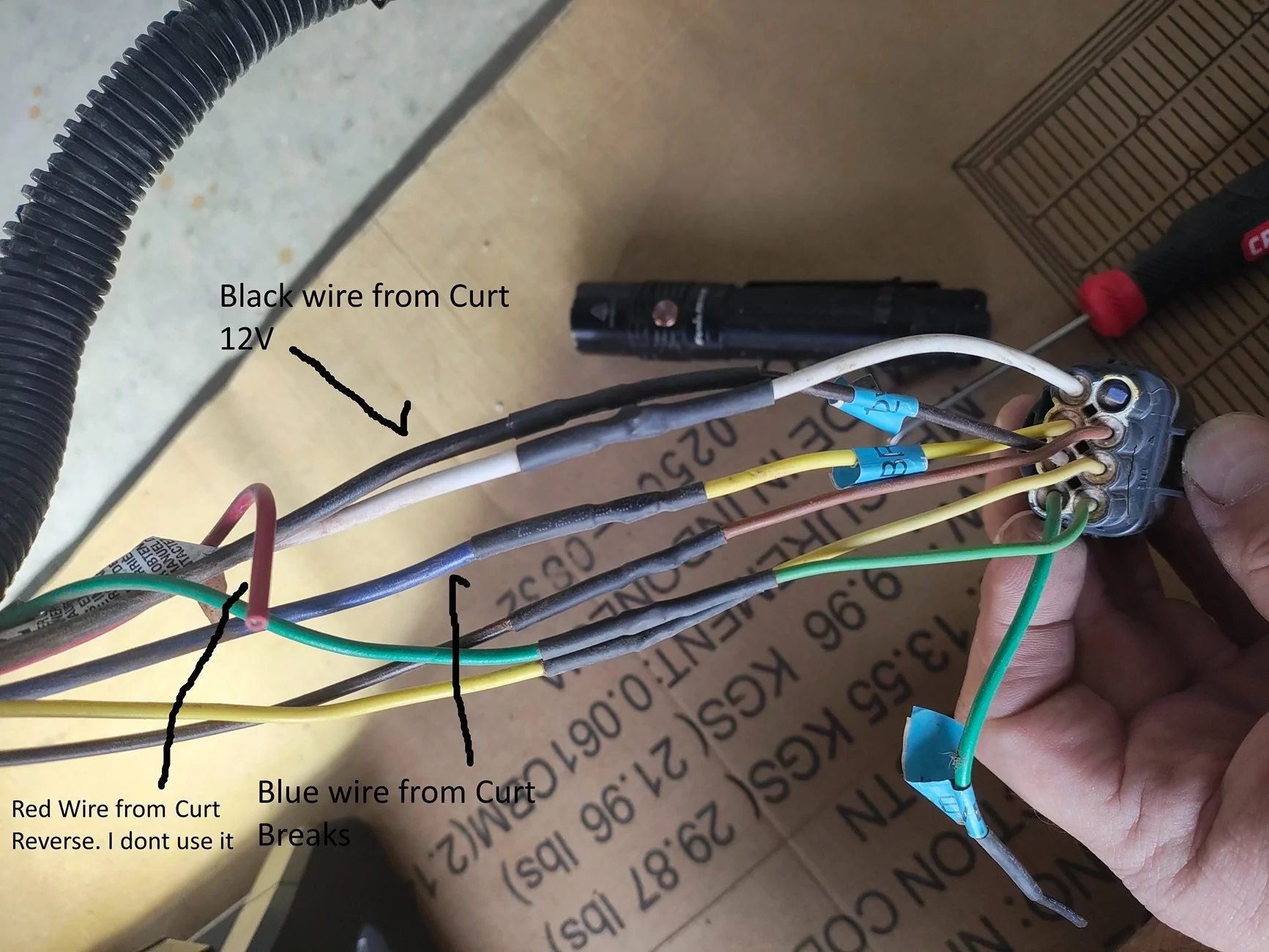

I've been chatting with another user and he confirmed the Ford OEM 4/7 will connect to the Curt harness. This is really good news and will allow for the 4 pin to work also. I'm waiting on the part number he has and I will order it and then place it in the rear bumper. It should look like it came from the factory without needing to run wires all over the place.
For the life of me I don't understand why Curt didn't not pin in the 3 wires, it would have been so easy for them.
Here is a picture of how I did my plug. The White wire is the ground wire.

Oh thanks for this! Visuals are super helpful. It looks here like you spliced every cable inline? So you cut the plug from the 4 pin, took it apart, pinned those wires into the Curt plug, then spliced all cables as well? Sorry to keep at you on this!

That's right I cut the plug from the 4 pin and took it apart I pinned those into the Curt plug I'm going to butt connect the red wire once I get the 4/7. I was just being lazy, I will connect it once I install the 4/7, I ordered it from ebay so thanks again for that.
Also, I think I said to just ground the white to the chassis. I pinned it as you can see the white wire is connected.

I did check all the wires with a voltmeter. The red wire is for reverse which I also checked with my meter. I was not sure what wire was which, so I had to check each one. I got it right the first time thank goodness.
