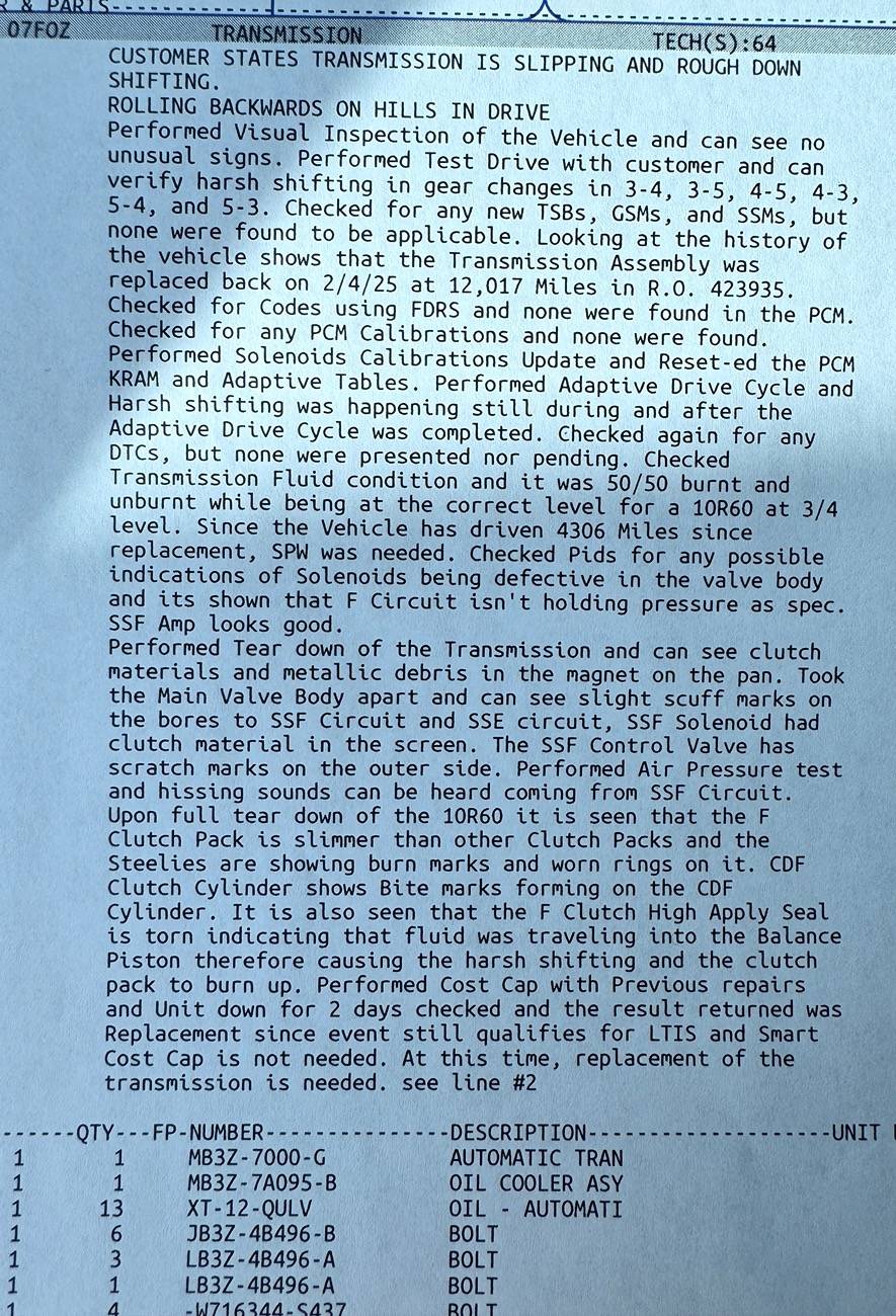

I posted this in another thread about my transmission issues that required a third transmission replacement in my truck in under a year.
This is wild, that's too many failures.
Also, the fluid should be between 2-3, 2.5 is perfect. 4 is too low.
On this next trans try that to start.

Right?!
I am wondering if it is a tuning issue and the transmission faults internally are a result of transmission shifting out of tune with engine if that is possible.
The rough downshifting and stalls coming to a stop started again right after driving the 1000 miles "adaptive drive cycle" as the service tech put it learns to adjust shifting to my driving? 3 transmissions with same mechanical faults in under a year? In one vehicle? What are the odds ?
