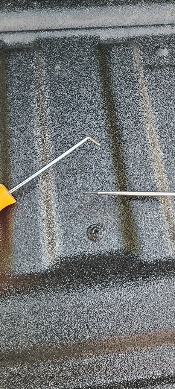

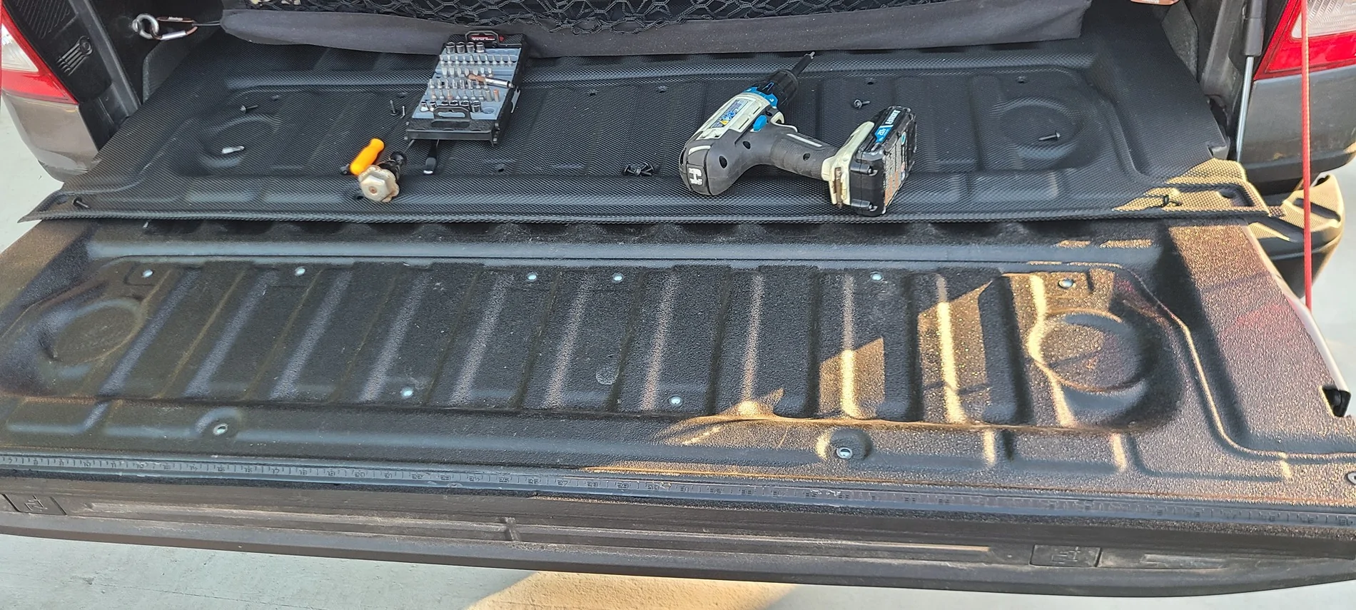

If you have a spray in bed liner, you need to pick the liner out of the bolts that hold the panel on the tailgate, those little torx head screws.
Ford Ranger TripleAliners tailgate mat 20260320_181823
I used an ice pick and it worked pretty awesomely.

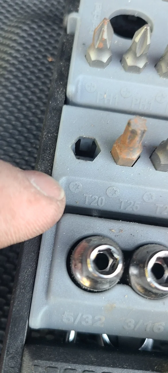

They appear to be a t20.

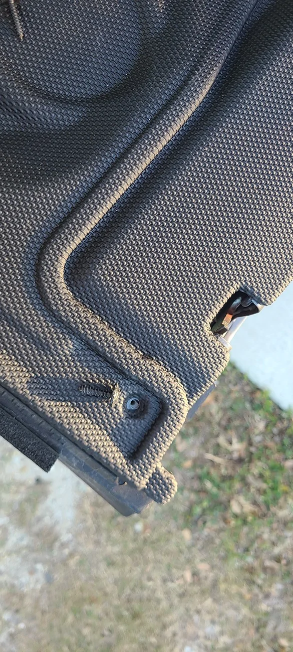

Lay the new tailgate mat out and make sure the holes are aligned over where the screws came out. The mat is still kind of cool so i had to kind of stretch it out and start in the middle, working outwards on the screw holes and they all aligned perfectly. I pulled the edges out and started the screws by hand and once they were all started, i zipped them down with the screw gun.
Ford Ranger TripleAliners tailgate mat 20260320_184522
Ford Ranger TripleAliners tailgate mat 20260320_184527

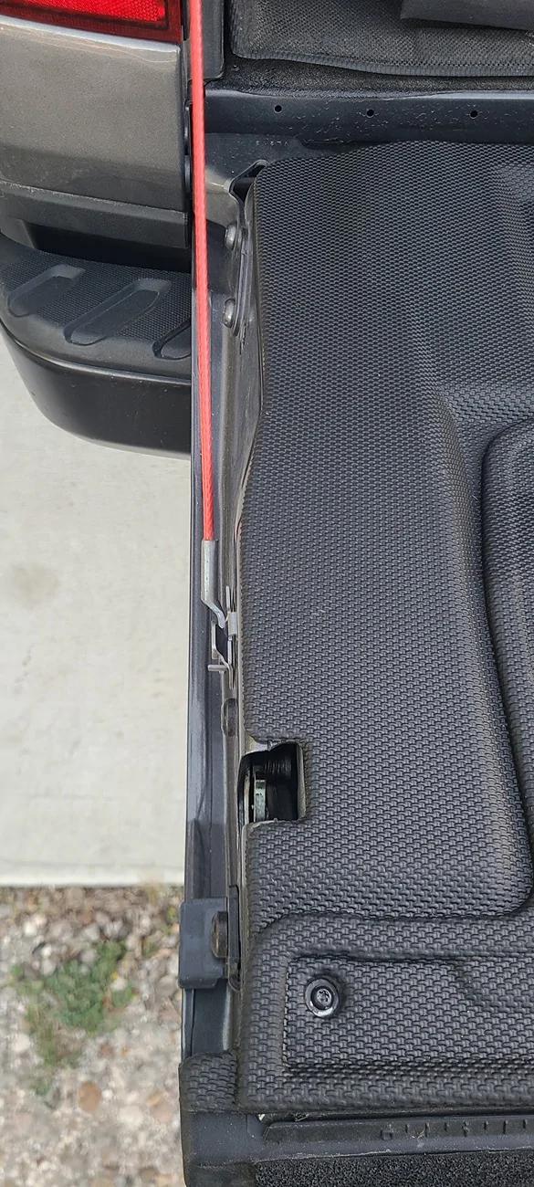

This thing fitd perfectly and, of course, matches the TripleAliners bed mat like they were made for each other.
Ford Ranger TripleAliners tailgate mat 20260320_190809
Ford Ranger TripleAliners tailgate mat 20260320_190818
Ford Ranger TripleAliners tailgate mat 20260320_190824
Ford Ranger TripleAliners tailgate mat 20260320_190829

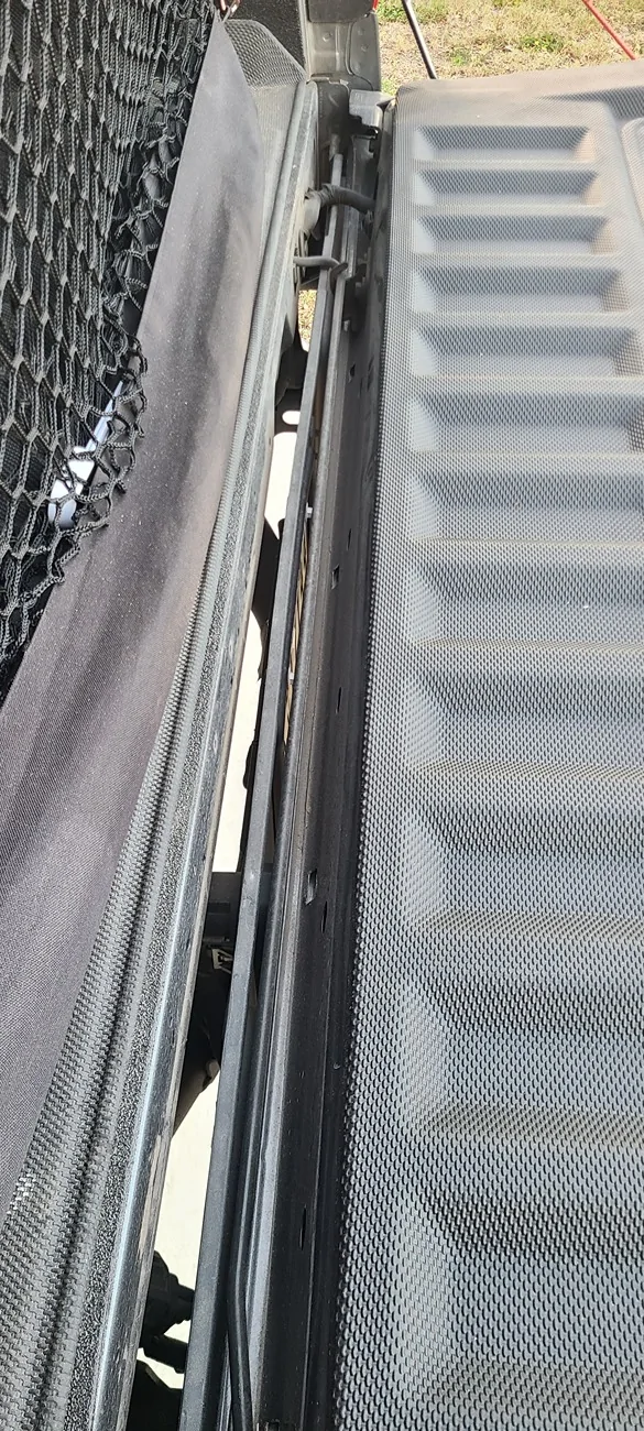

All the edges line up great!
