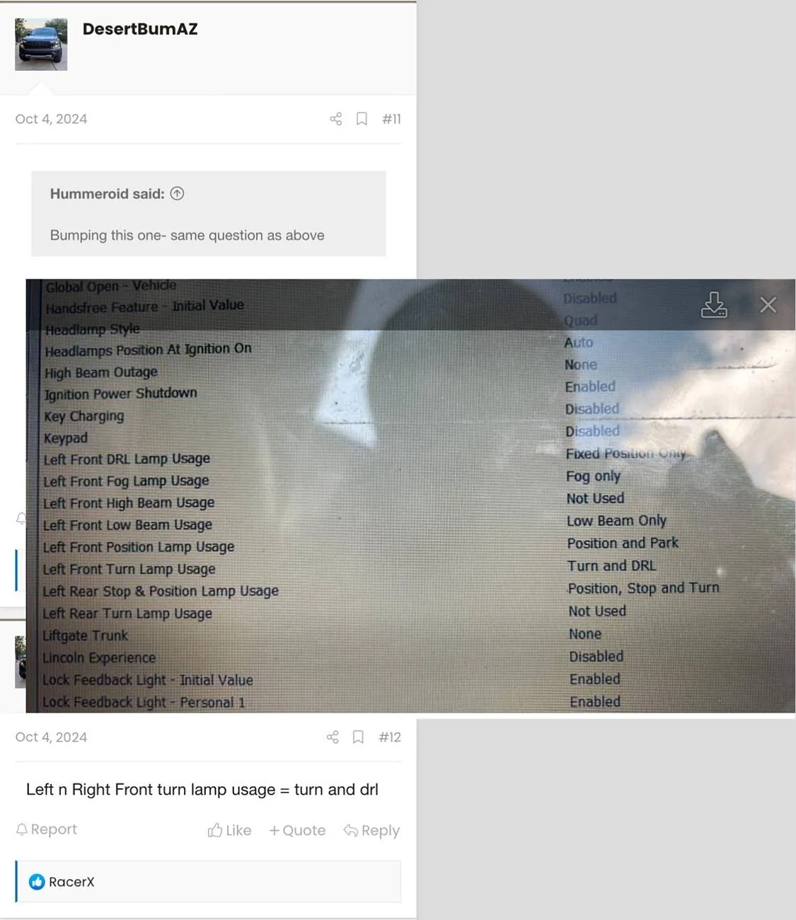

If you haven’t already, download your as built data. Go in a play with the modules. I take pictures and try not to make too many changes at once. I refer back to those other spreadsheets and look at my as built data on my other vehicles to compare. If you mess anything up you can always go back and change it.
this member did it on the front turns. Looks good.
Maybe ask @DesertBumAZ
