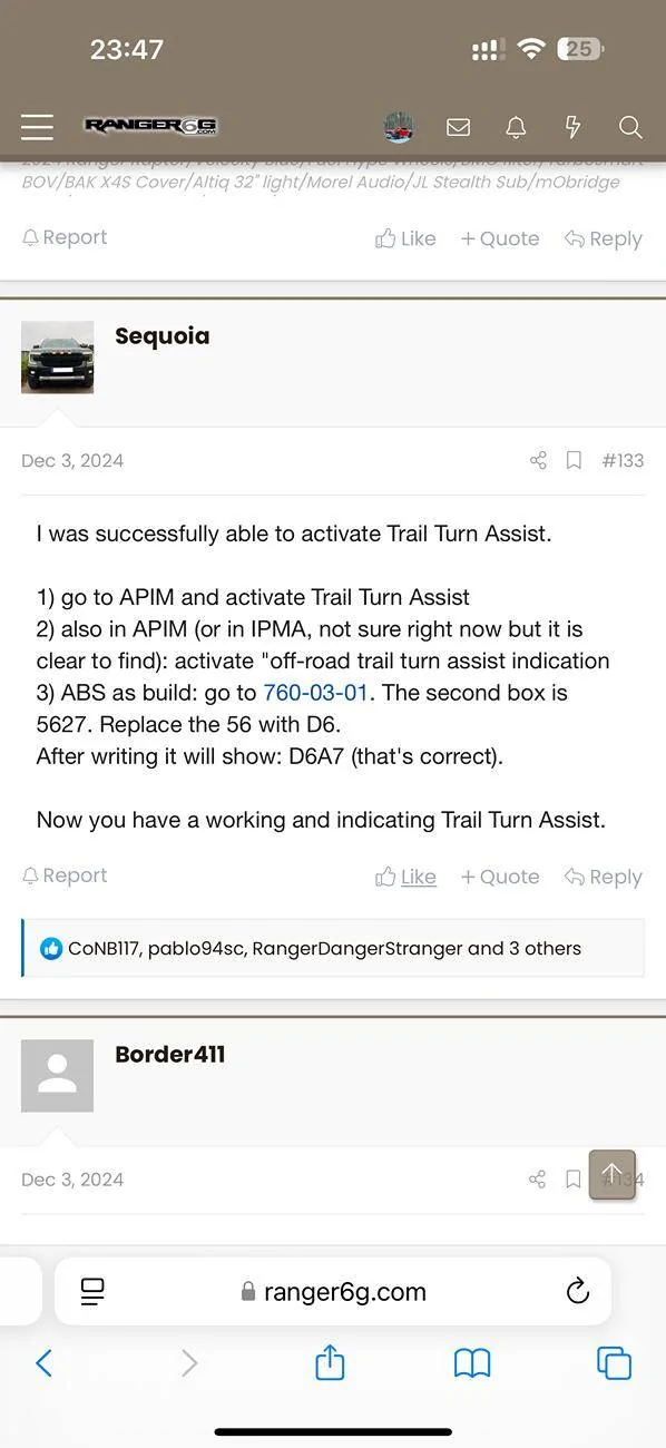

No launch control that I know of. I activated trail turn with Forscan. Need to make a change in the APIM module to get the option on the off-road screen with the lockers and make a change to the ABS module to turn it on.
In the video he just turned off the traction control and foot-braked to his desired launch RPM.
what was the change in the ABS module?
