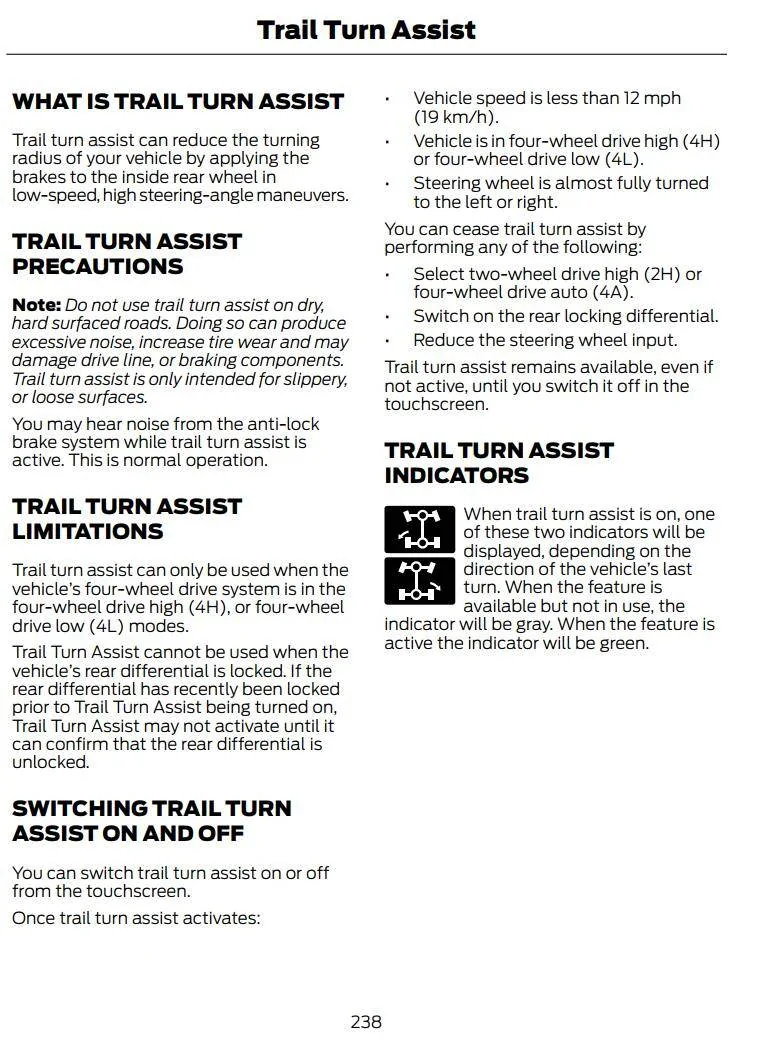

Trail Turn Assist on my Wildtrak, here is how:
Changes are needed in APIM and ABS module;
APIM 7D0-10-02 was 0000 00A2 00–, changed it to 0000 00A5 00–. This adds TTA button to offroad screen.
ABS 760-03-01 was E87C 56–, changed it to E87C D6–. This enables the TTA on ABS module.
After the changes, I have performed a short test on a not very suitable surface and it worked. If you want to give it a try, please do it on your own risk.

Tried to update my previous post and ended up deleting it. I did confirm today thhat the changes to the APIM and ABS module did add trail turn assist to my Ranger Raptor and it seems to work just fine.
APIM As-built 7D0-10-02 was 0000 0E71 0068 changed to 0000 0E75 00xx
ABS As-built 760-03-01 was F67C 7653 changed to F67C 06xx

Are you getting any notification when it starts to grab the inside brakes? I made these changes as well and I can't really tell if it's working or not

It only works at slow speed with steering wheel at full lock. You will hear and feel the inside rear wheel skid and you will turn on a dime.
