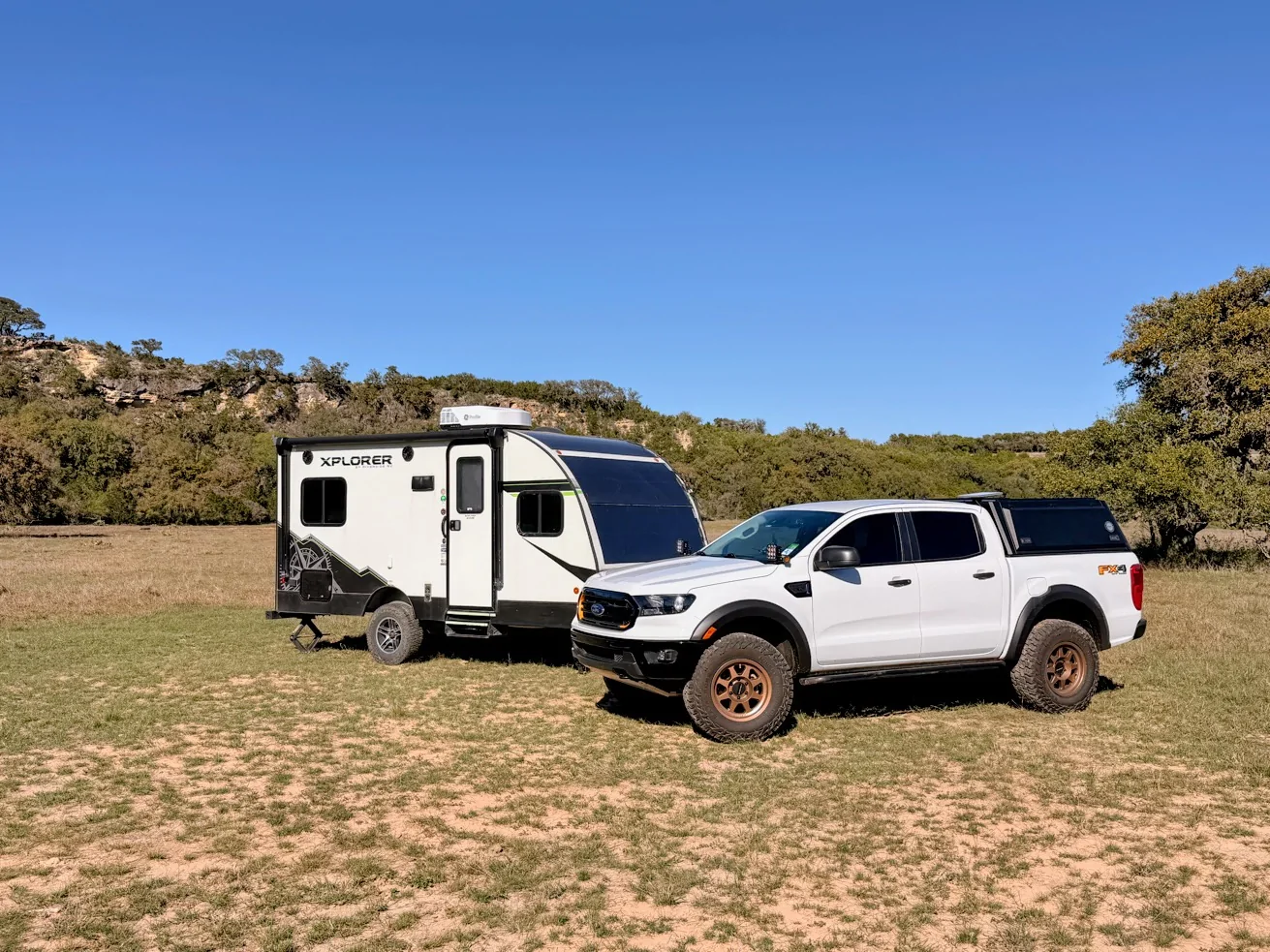

Getting the 50k mile service on my 2023, the dealer let me test drive a 2026 Raptor Ranger. Yeah I'm sold. So, before I sign paperwork I have some questions.
I literally just purchased Method 701 bead grip in bronze. 17x8.5 with 0 offset. Running Mickey Thompson 285/70/17s. The tires still have the nipples on them. I assume they'll rub at full lock, but is there a solution for that like higher clearance crash bars? I'd love to keep those as the dealer said at trade in, they can swap the rims/tires from the Raptor to my XLT and vise versa with zero hit on trade in.
I also have a Overland Vehicle Systems truck cap. I measured the truck and the beds are the same size, so it should fit?
I also own a 16ft camper trailer that weights around 3200lb fully loaded. I assume that won't be a problem if my current Ranger tows it now with zero issues?
Picture below is my current 2023. I want a Carbonized Gray Metallic 2026 Raptor.

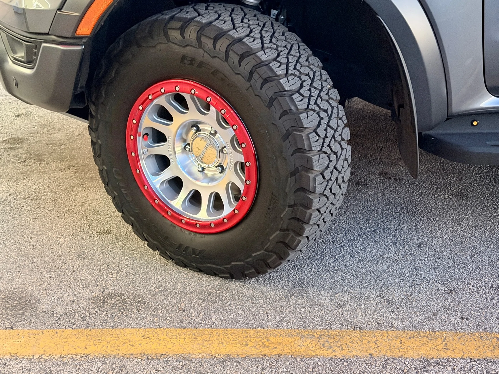

Pella
I just added some 709'S with the stock rubber it did rub at full lock but removed the front only crash bars and no rub

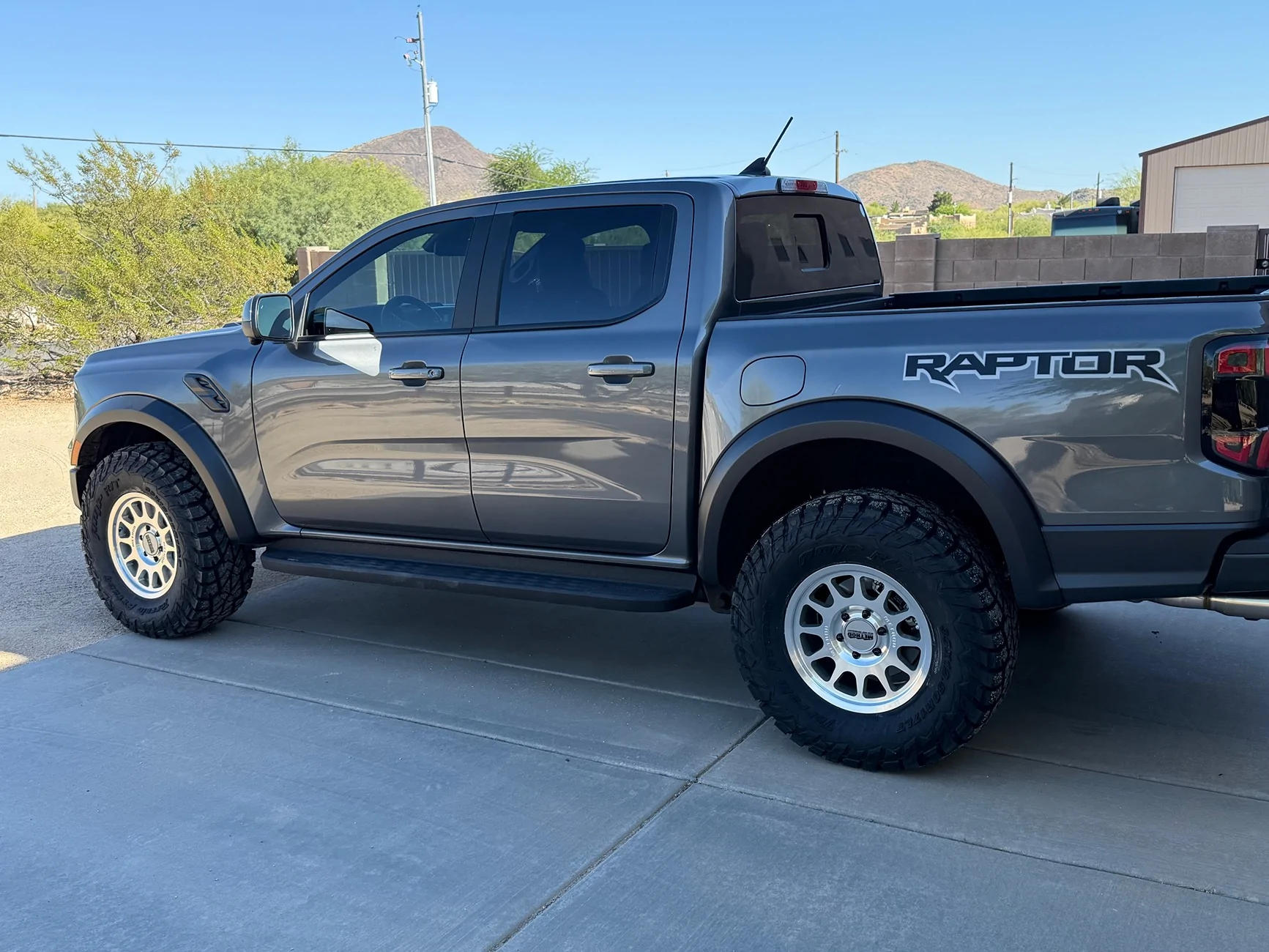

Yes, there are high clearance crash bars. I am preparing to install a 2"/1" FordRangerLifts.com lift next week, got the Method 703 Beadgrip wheels and mounted 35x12.50 R17 tires. I purchased these on Amazon, they also available on eBay: ReadyLIFT 67-2900 Anti Intrusion Beams for Ford Ranger RWD, 4WD.

@freakshow999 Which folding & locking tonneau cover did you get for your '26 RR? I am at that point now as I got my tires and wheels sorted out. Will put the 2"/1" lift on this week, but the 35s fit with the high clearance crash bars.
