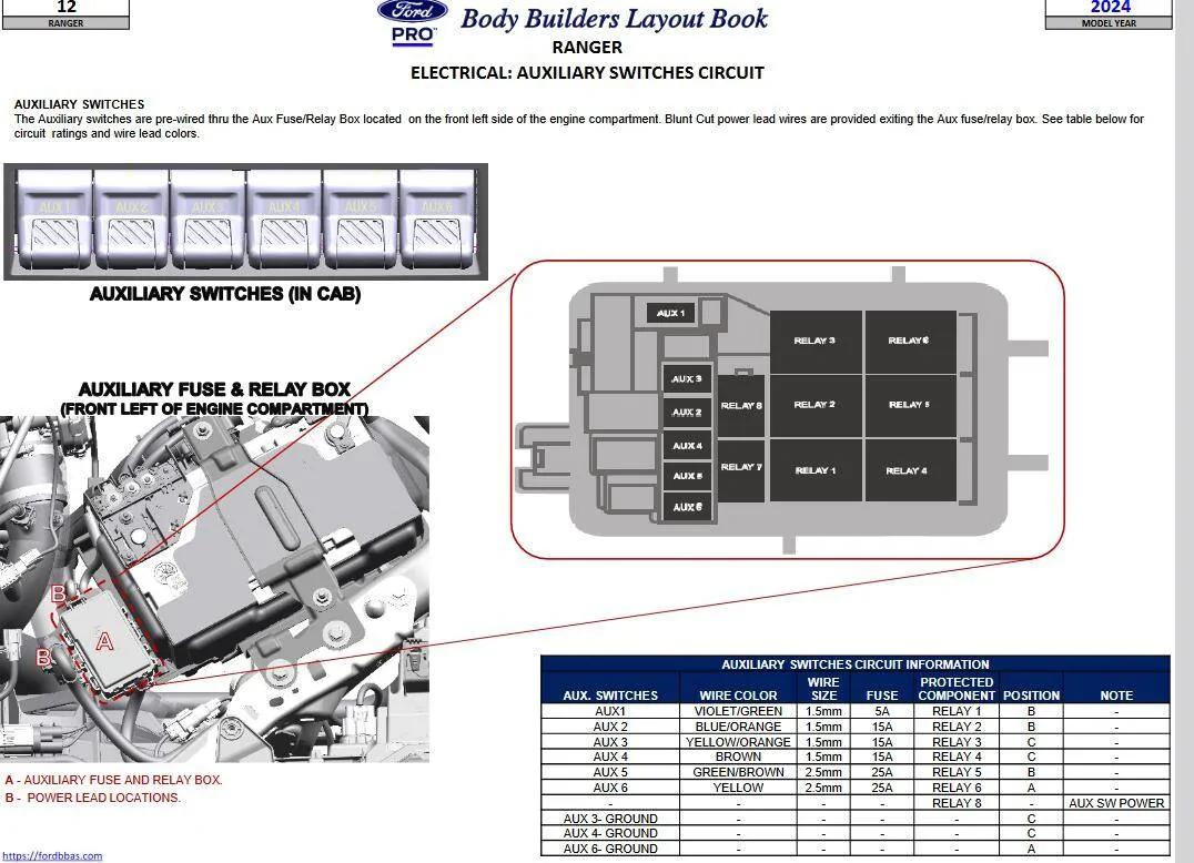

this is a page re aux switches in the builders guide. It doesn't seem to indicate 5 and 6 interconnected with the high beams. The full builders guide has a link somewhere on here. Good luck.

this is a page re aux switches in the builders guide. It doesn't seem to indicated 5 and 6 interconnected with the high beams. The full builders guide has a link somewhere on here. Good luck.
Screenshot 2023-07-12 at 20-53-23 Body Builders Layout Book - 5.31 builders guide revised.pdf.png
Well damn. Thanks for the info though!

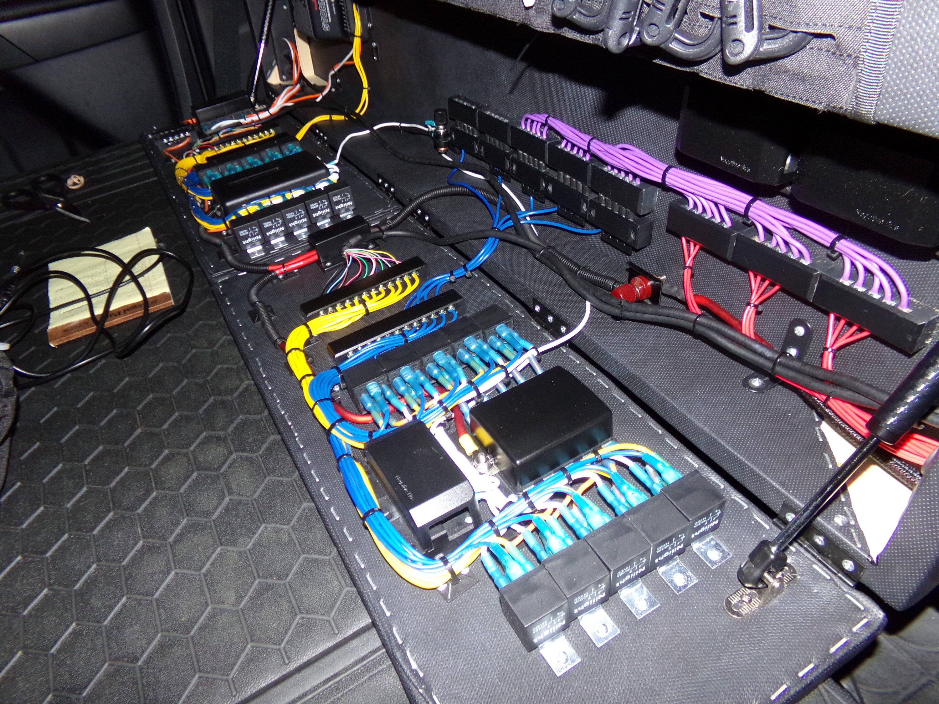

Nah even easier, I'll do it like I have now and just pigtail tap the high beam harness, but also another pigtail to the actual up fitter switch. Use relays as triggers. Put one way diode blockers to prevent back feeding. That gives me dual functions (high beam triggered or switch triggered) that operate independent of each other.
I have a bit of a scratch when it comes to custom electrical wiring lol

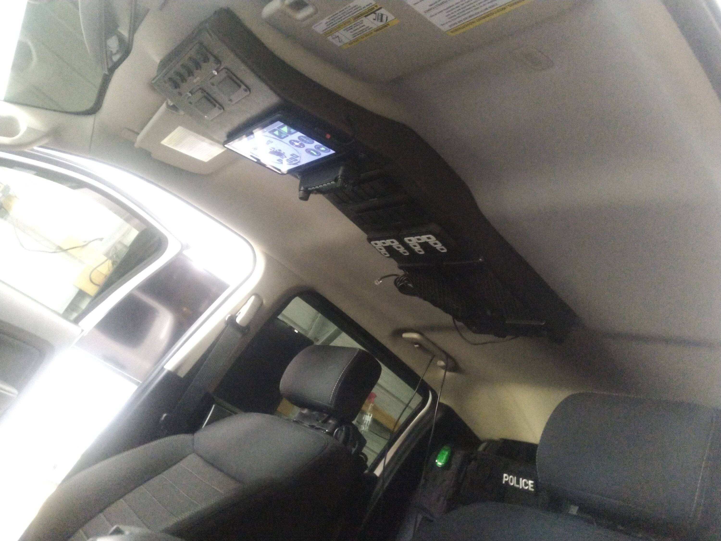

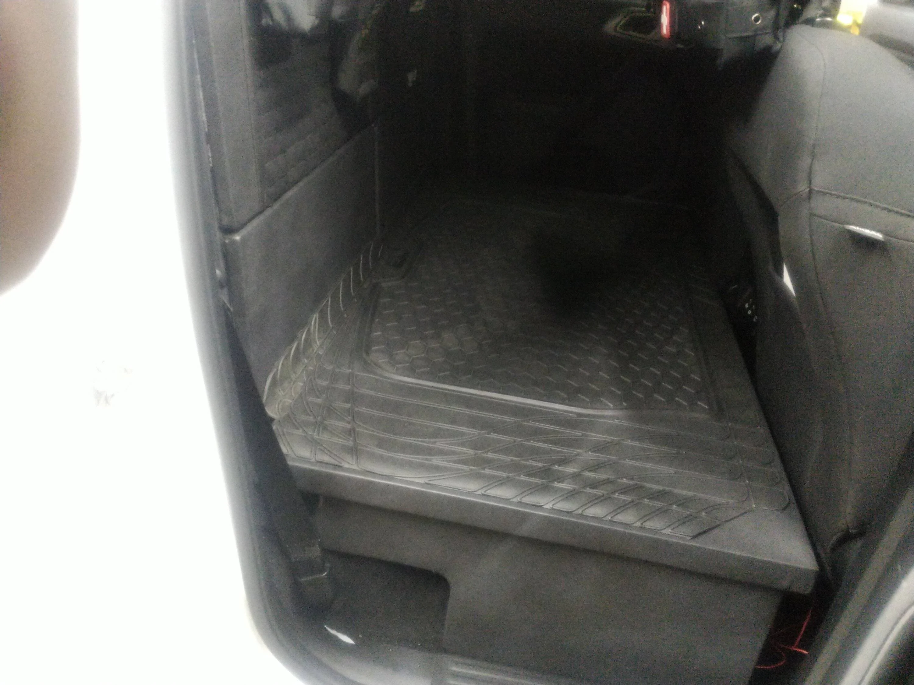

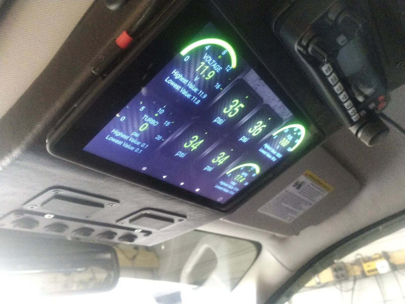

How about a custom ceiling console for the current gen ranger?
Only one of its kind in the United States.
No? How about custom rear seat delete? With hidden armory accessed by hidden RFID locks?
My shenanigan's over the last 3 years reached absurdity at some point. It got to the point of just trying something to see if it could be done.

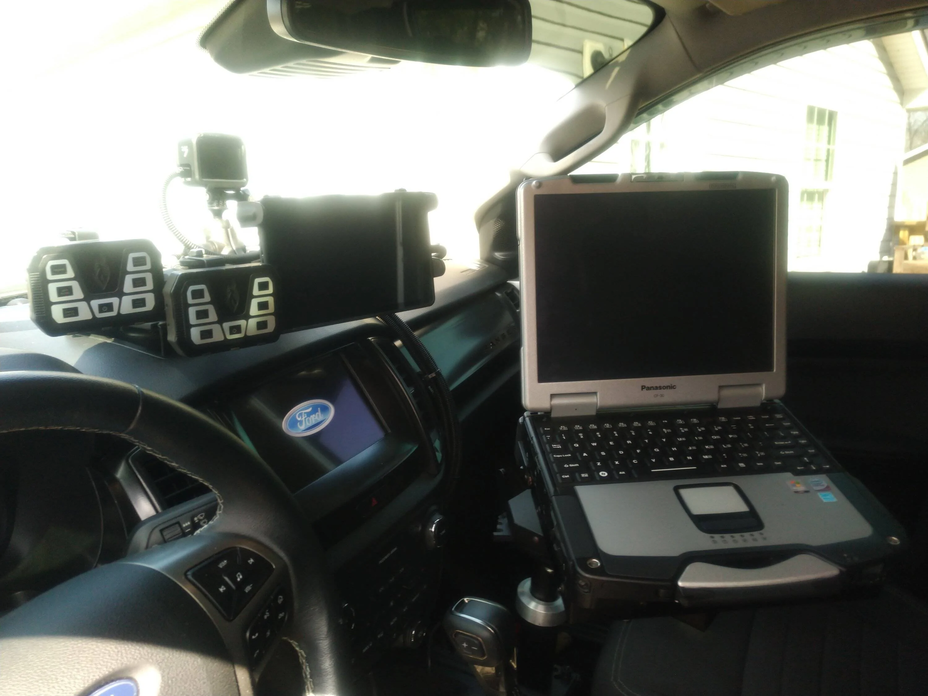

At one point at beginning of 2022 I wanted to see if I could convert an old patrol vehicle laptop mount to work in the Ranger. I could it turns out with a little chopping and refinishing. lol
