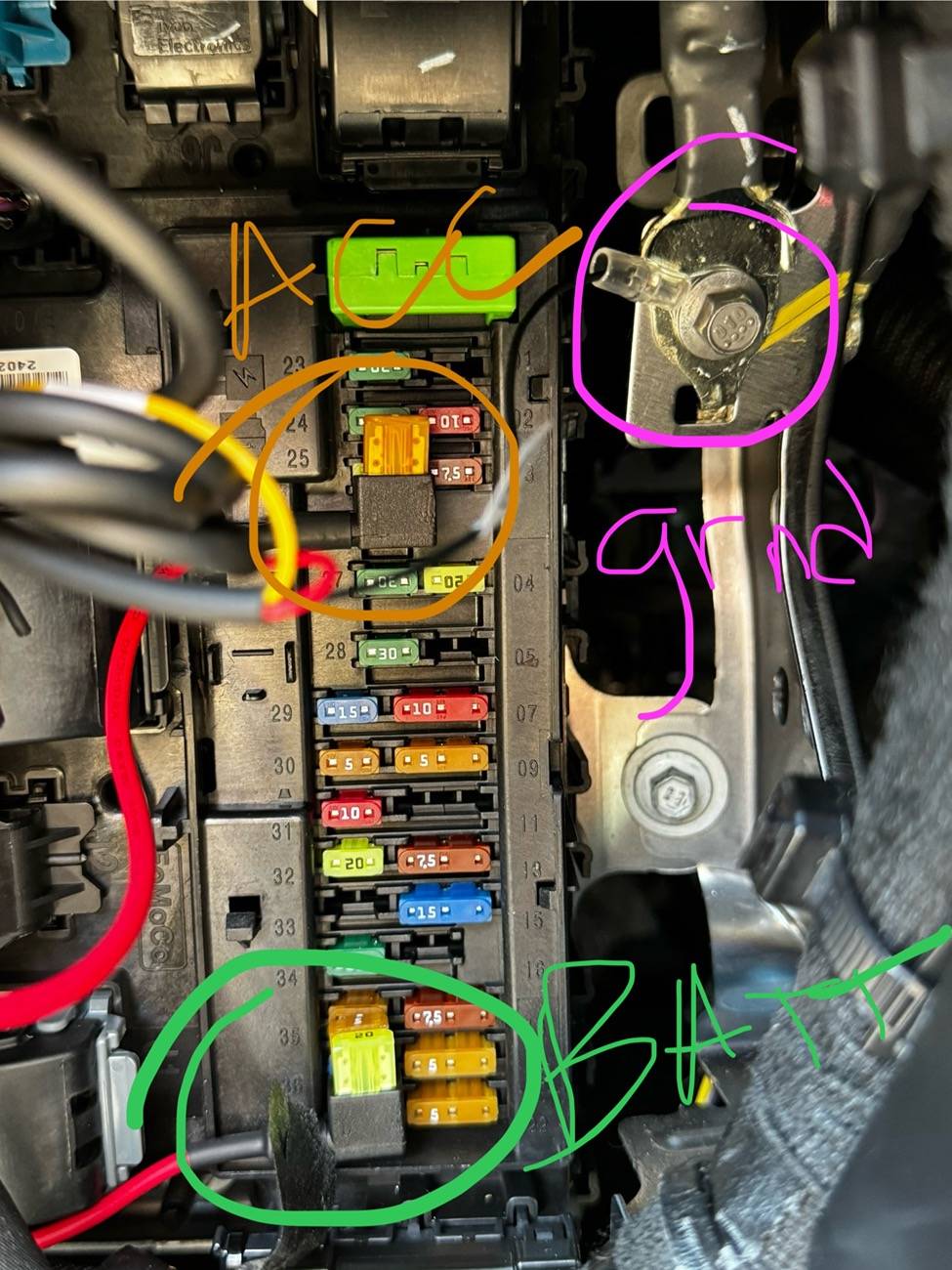

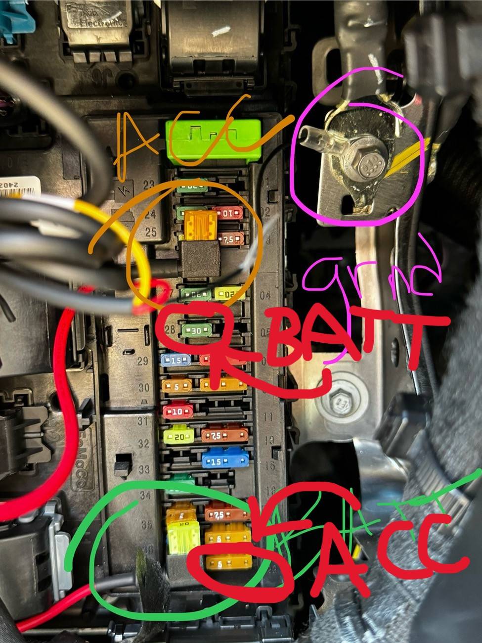

Pretty sure #26 is always on. I can confirm later.
Here's what I used.
Ford Ranger USB power question that turned into J-Brace conversation IMG_0535.1
The shaving needed was the fuse tap itself. If you pull a fuse out and compare it to the fuse tap, you'll see the difference and should hopefully be able to tell what needs shaved. Couple minutes with a dremel or a razor blade will fix the fuse tap.
I'll also try to take a picture of my actual fuse box to help eliminate confusion.

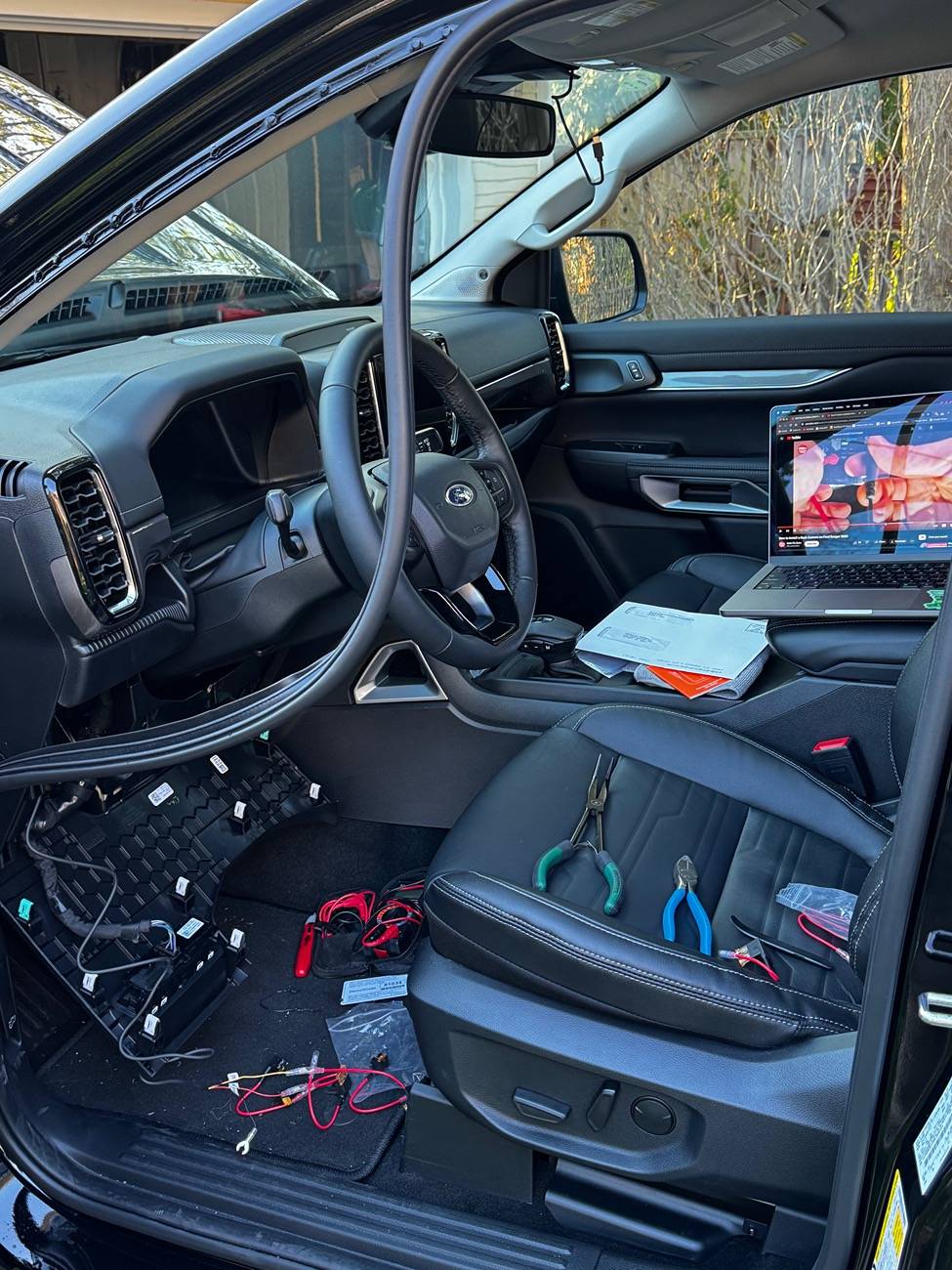

It's the channeling of the wiring that Im curious about - you got a lot of tools out there and electrical panel out. Not that confident in my electrical skills so I'll pay someone to take ownership on the job. Just hoping that while my back is turned they don't break anything and quickly hot glue it back together.
I used to do everything myself, but multiple back surgeries and 26 screws later, I'm more inclined to pay someone.
Plus, the older I get, the more my confidence in my skills vs new vehicles erodes.
