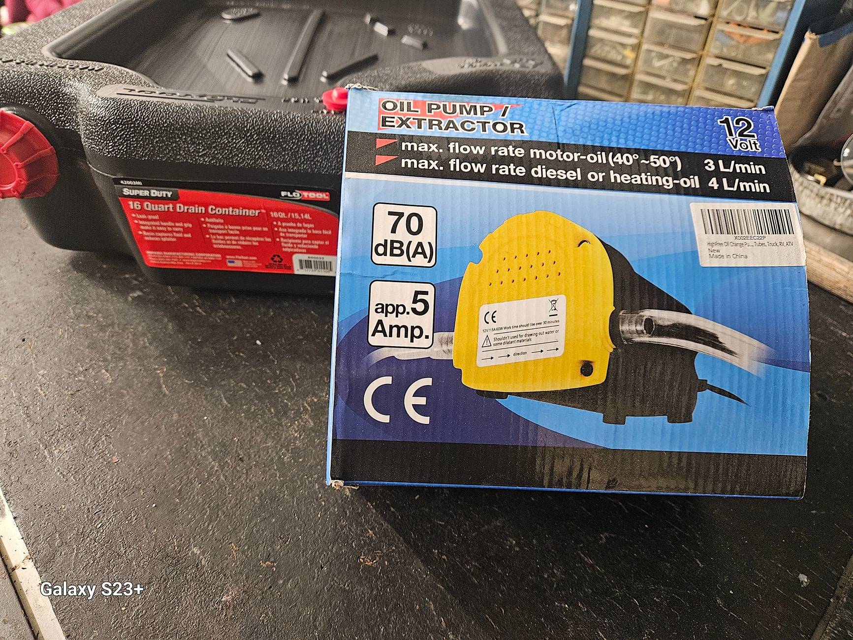

Dipstick. You have to be able to pull a vacuum. Attempting to do so from the oil fill, won’t produce the necessary vacuum pressures required in pulling oil from the crankcase.???
Johnny 35 I use this from Amazon works great just make sure the oli is warm no priming required. https://a.co/d/7vQ8rIu
