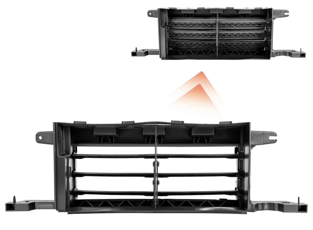

It does it because there are flaps in the grille that close at interstate speeds. This doesn’t allow enough air for the cooling system to cool the oil to normal levels.
Really bad programming on Ford’s part, just to chase an extra 0.1 MPG. The flaps should open if the temps start to rise.
The shutters must open when the AC is on because all my temps drop with the AC on, the coolant drops about 10 degrees F according to my SGIII.
