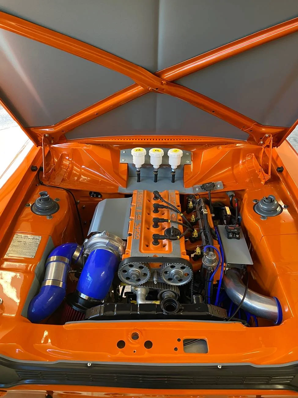

It is an issue but it’s not just these trucks , all stock turbo vehicles run injectors just large enough to cope and fuel pressure behind them also at just enough pressure.
I’m experimenting at the moment with fueling , larger injectors and higher fuel pressures to try and max out the stock turbos to see what they can actually achieve.

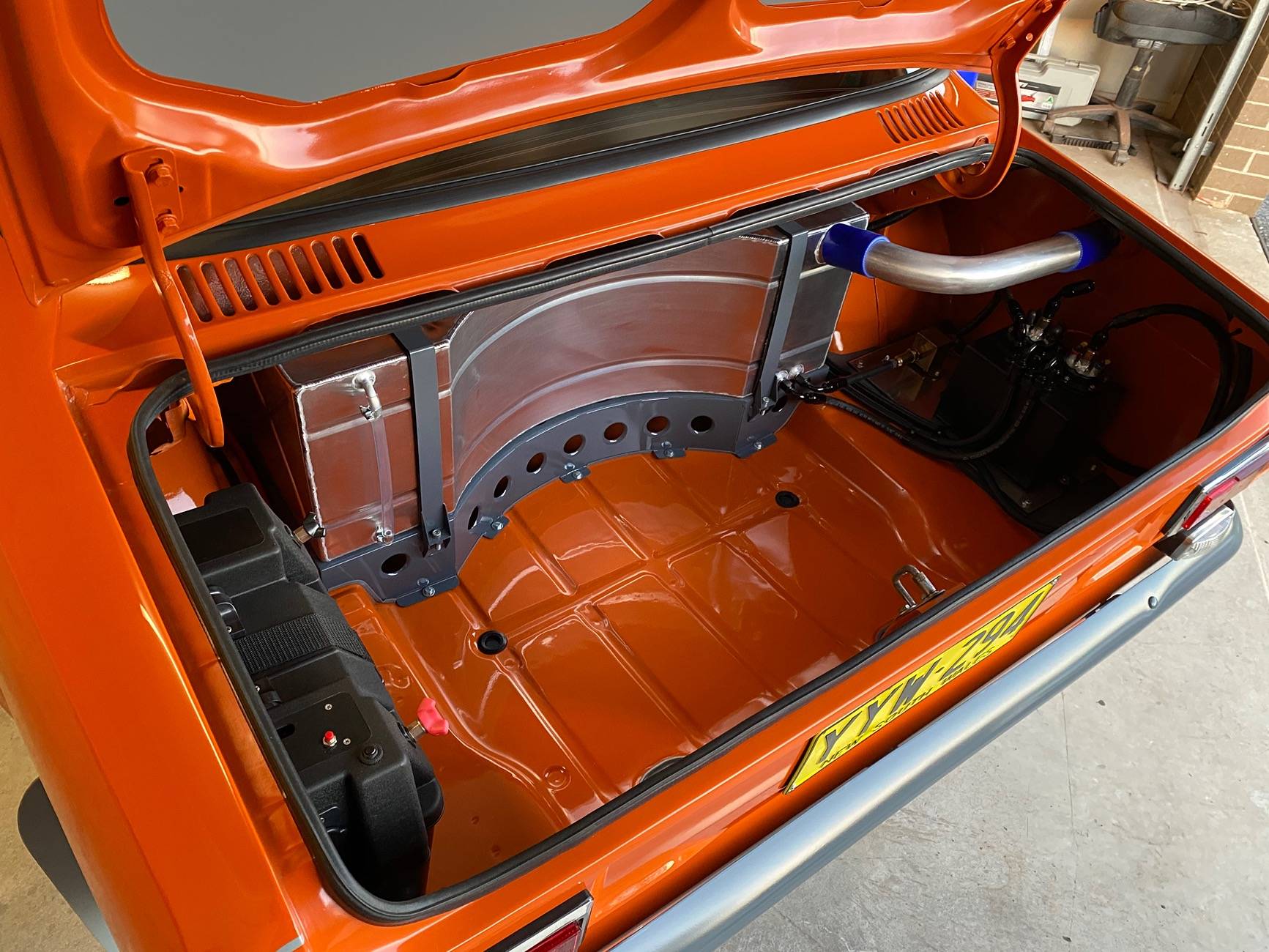

I’ve just upgraded the fuel system in my escort which now runs a surge tank alongside the main tank with a low pressure pump to feed the surge tank then 2 big Bosch 44 high pressure pumps to feed the fuel line .
it also runs a high pressure fuel pressure regulator and now 1200cc injectors.
im happy with that set up and I doubt the raptor will ever need it to this degree but a scaled down set up is on the cards.

Bonus OZ that is a clean machine. Love the attention to detail

Thank you .
old girl goes well for 52 years old
