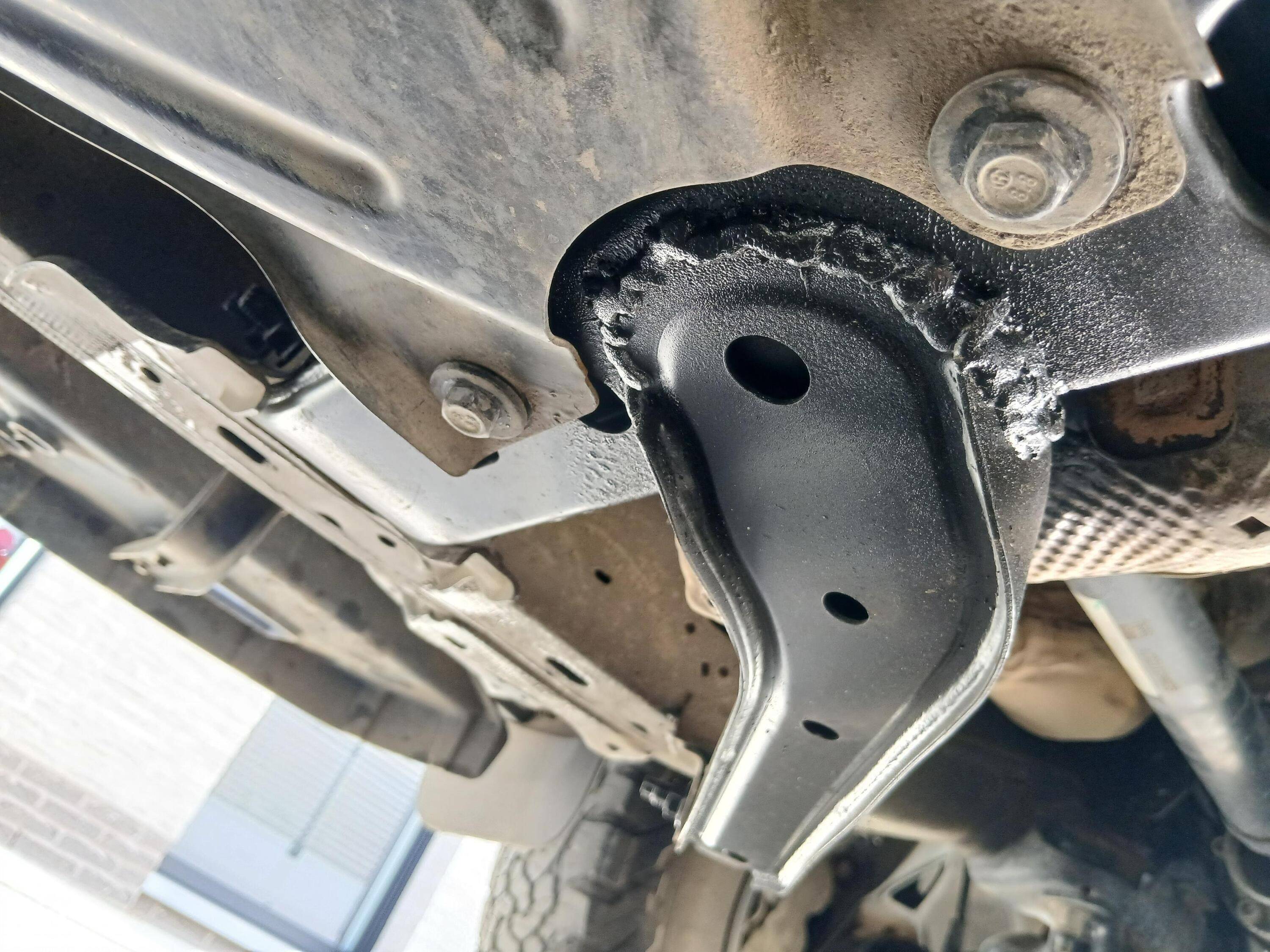

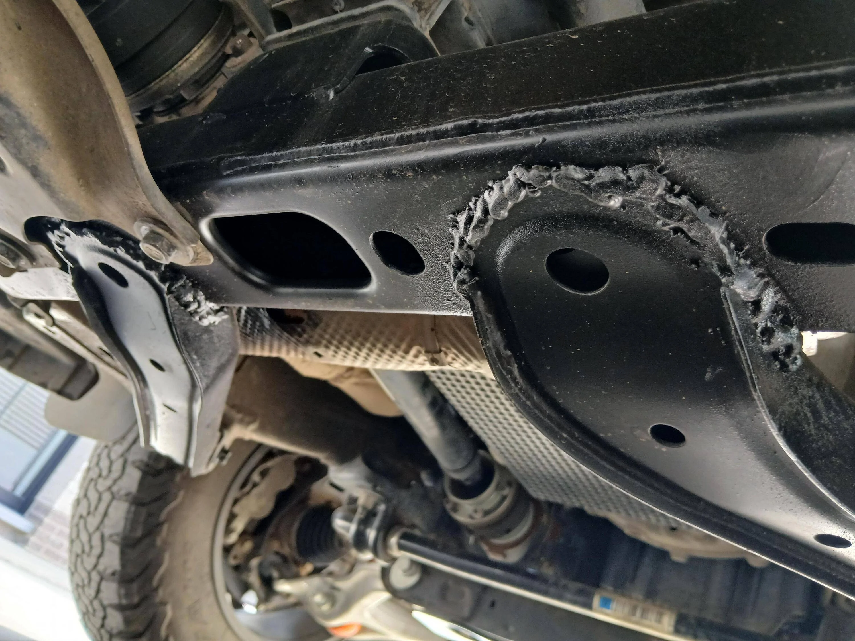

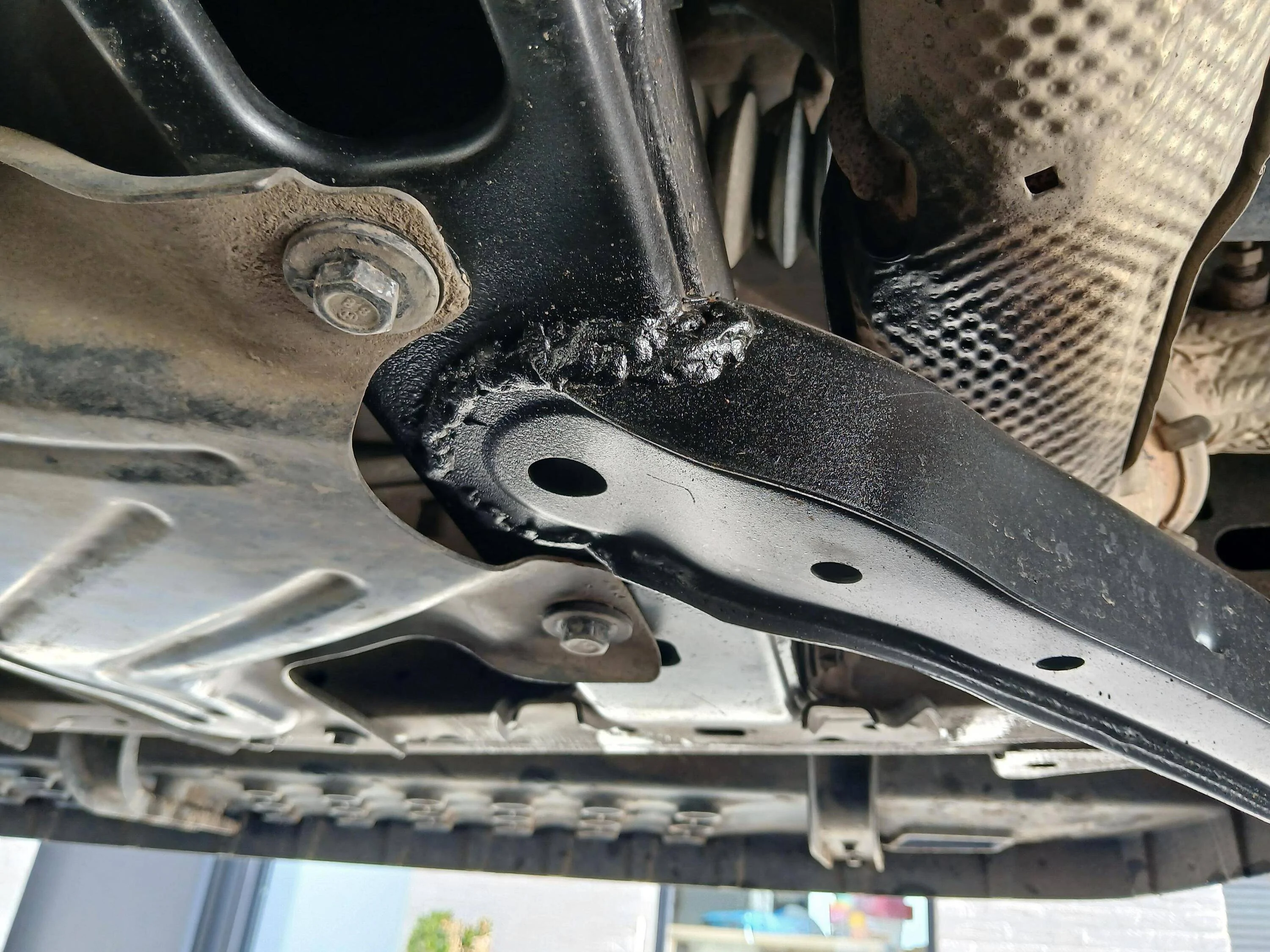

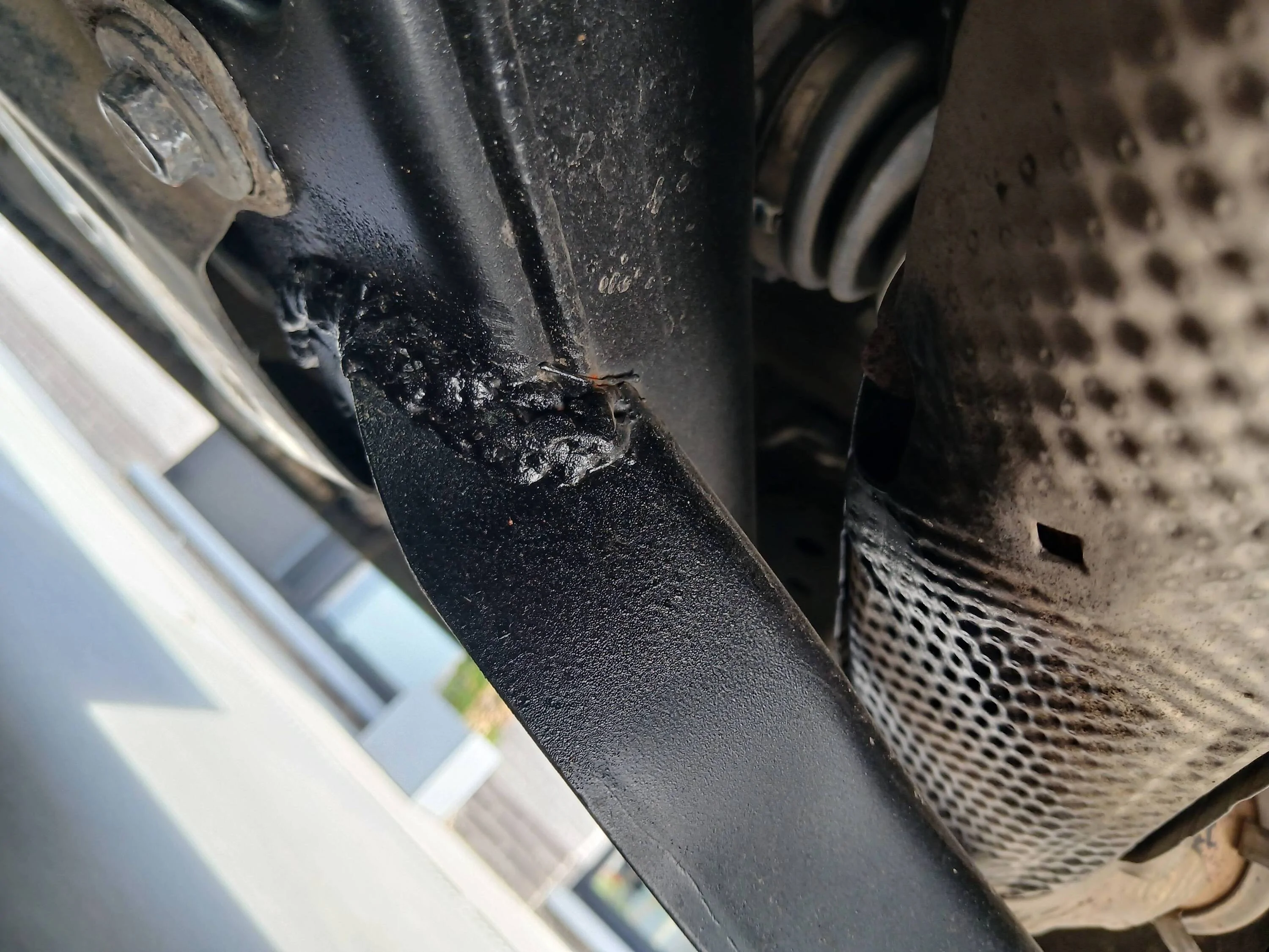

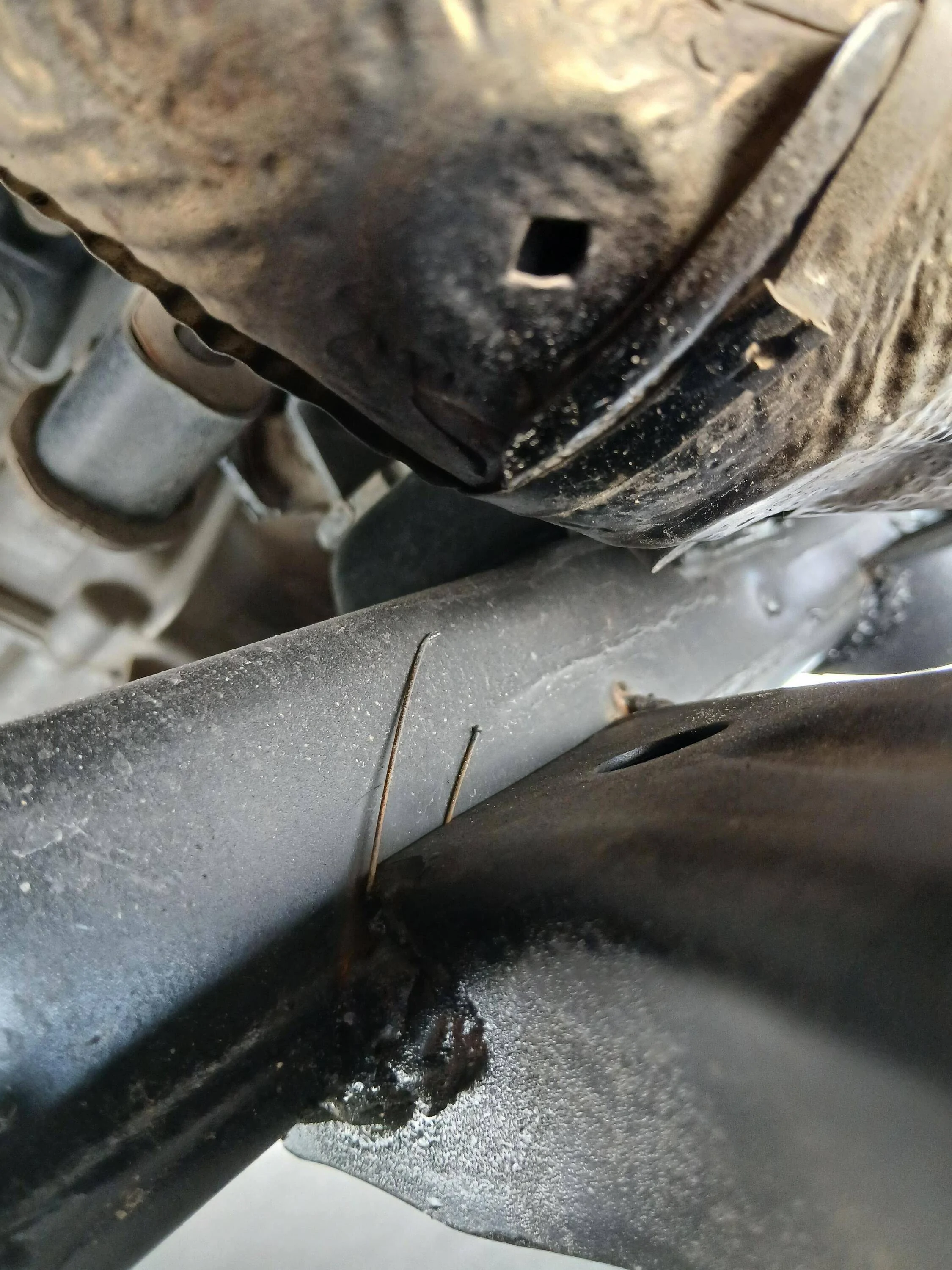

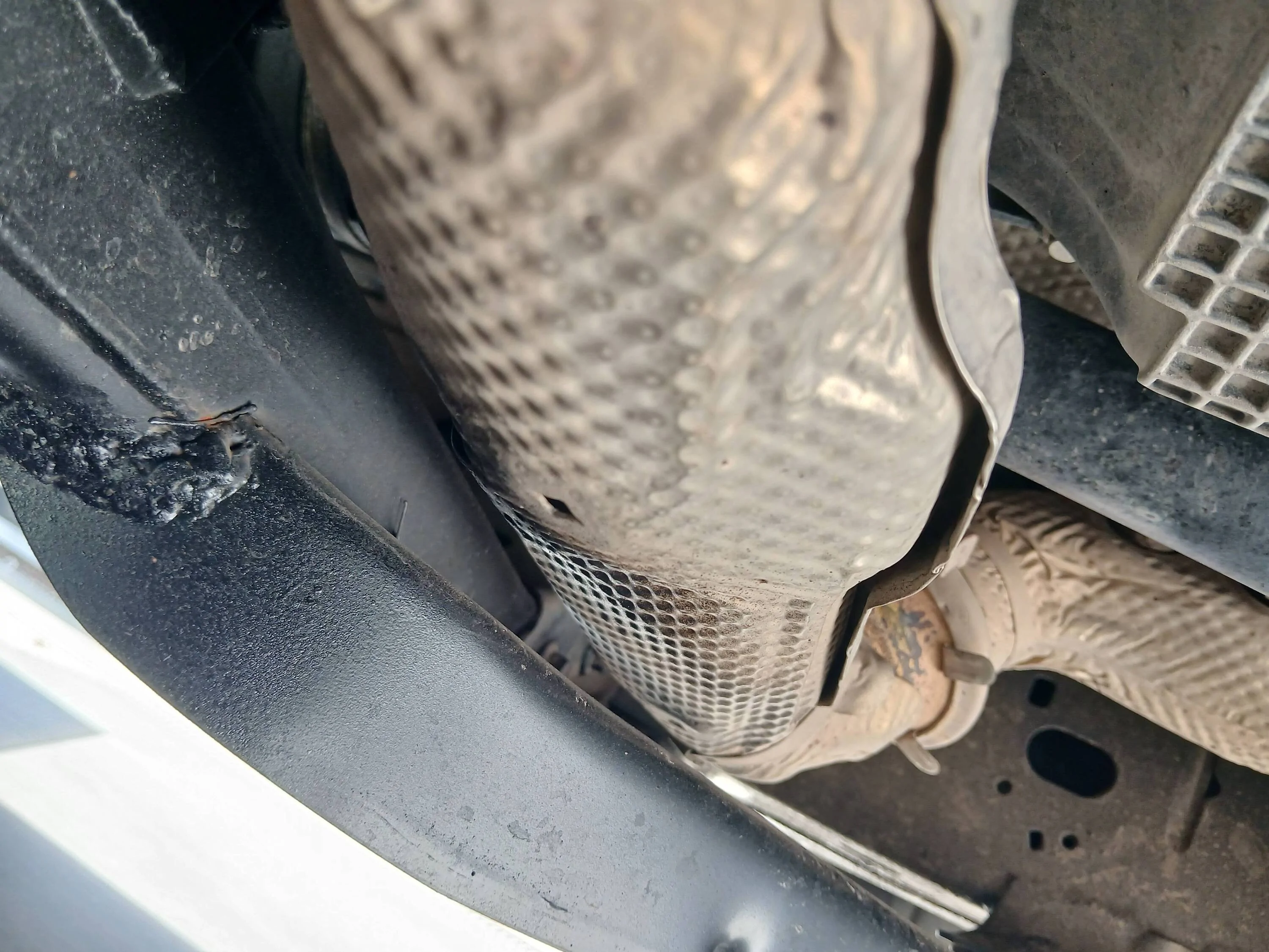

But, they also replaced the transmission crossmember which apparently arrives new in 3 parts and should be welded. The old one had a small edge bent, I wouldn't have mind if they didn't replace this part but hey, it was "free" so why not. The tech assured me he welded it better than factory (Spoiler: he did not)
Look and shiver about how badly a Ford dealer fucked this one up. I was literally getting nauseous when I saw this.
Not even welded at the top, welding wire all over the place, piss poor "welds". I even suspect this would be a no go at the yearly inspection over here.
I've asked for my old crossmember back and I'll be replacing it myself. JFC...
