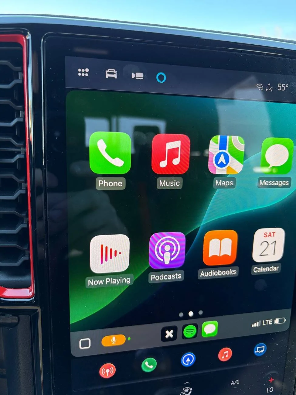

My Raptor did an over air update today the console looks a little different. Apple Car play seems more stable so far.

My Raptor did the over the air update and I updated to iOS 18.2 and all seems to be working the way it should (yes this violates every rule to software upgrades). Everytime I get in and start it up now the phone connects like it is supposed to. Before it would get lost and require turning off Car Play and then turning it back on. And the issue with no sound anywhere is gone. It did require resetting up Siri on the phone.
