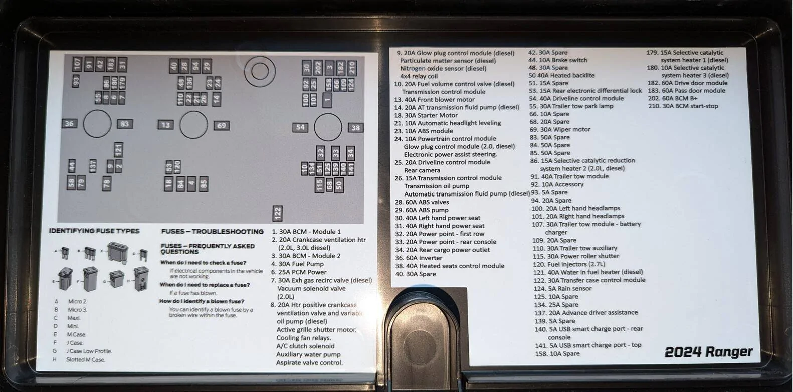

Little things can make a big difference! ? Is there anyway to check that those are accurate fuse labels? I didn’t see much info in the paper manual… trying to figure out what type of relay (1,2,or3) I have for the starter..
Fair question, and I have no idea. I know the vendor has some standing with the Bronco crowd, so I took it on faith and slapped them on.

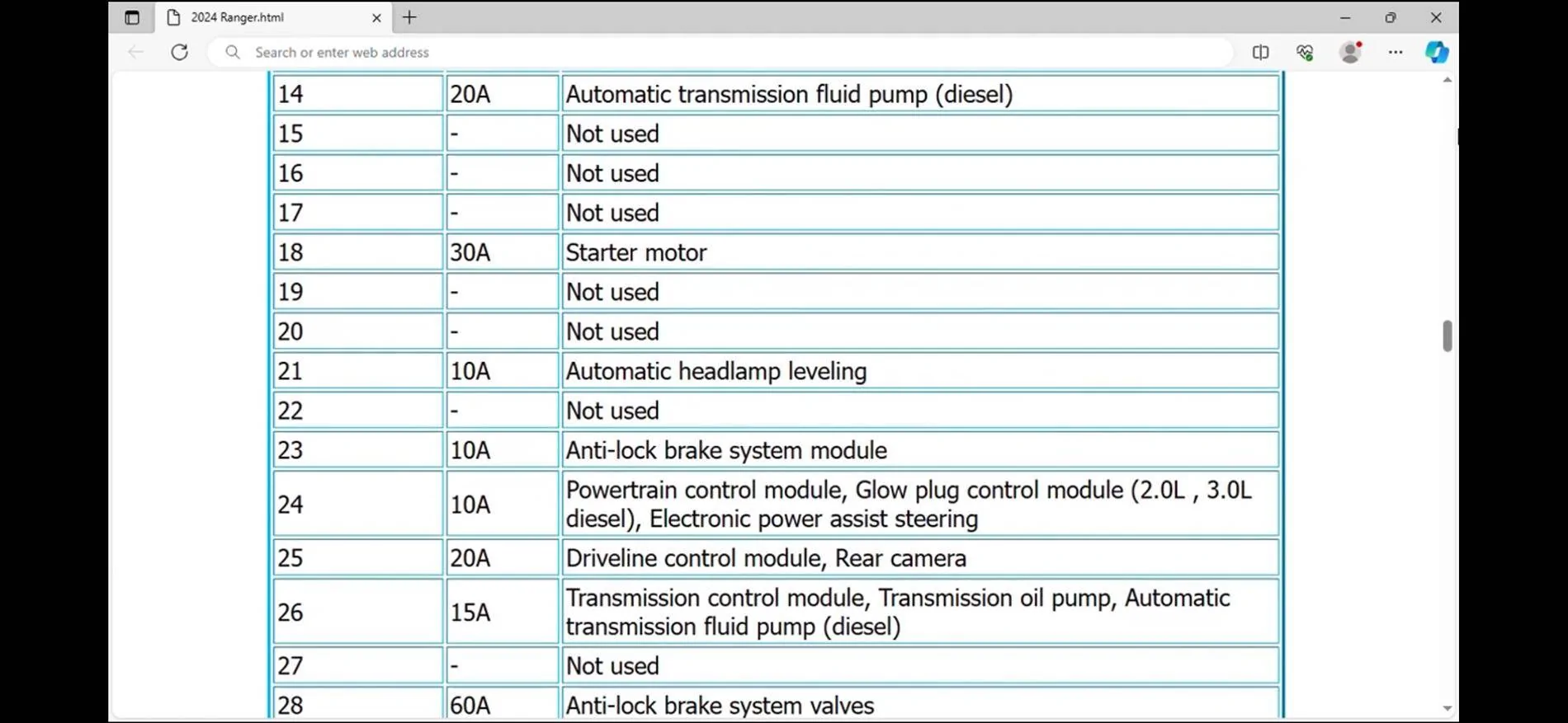

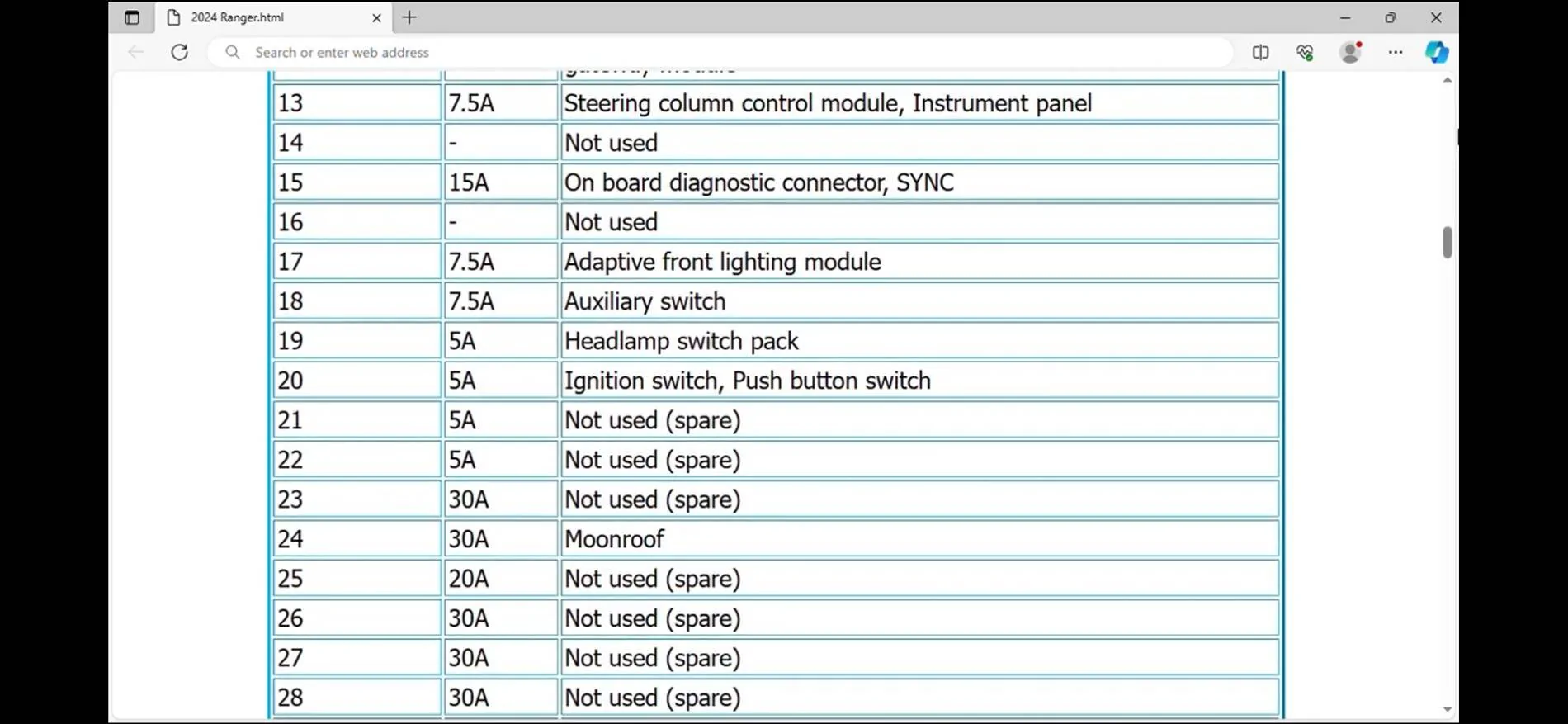

Would you mind posting a picture of the labels close up? I don’t want to blindly pull relays if I can at least get an idea of where they are.. so far this is all I found and didn’t really help (first pic is engine bay, 2nd is interior)

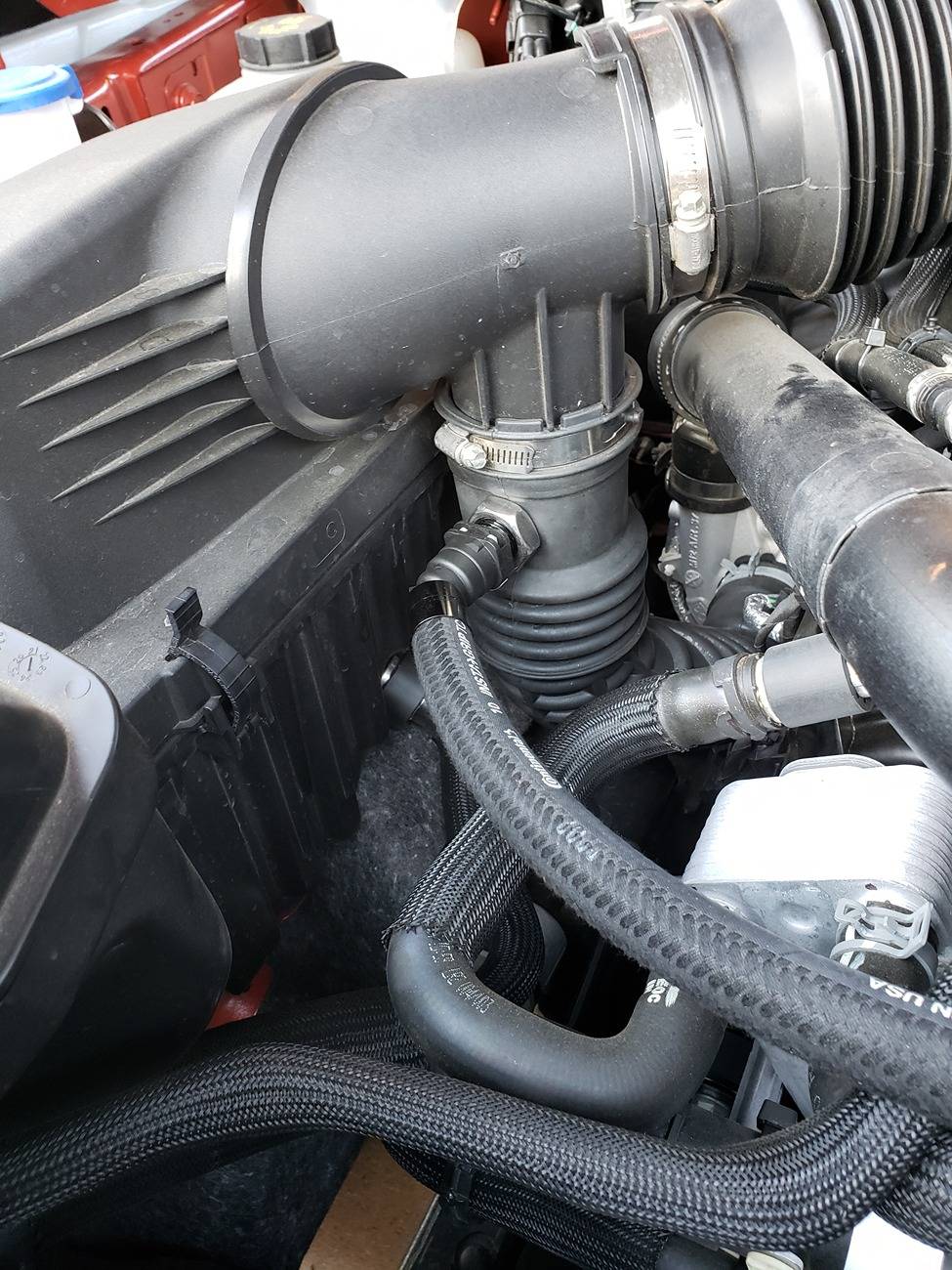

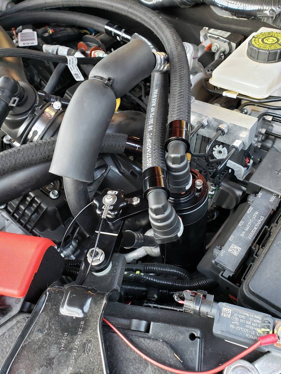

Added upr dual valve catch can. I'll tackle the clean side separator tomorrow.

A question if you don’t mind;
The additional tube for the intake, did you have to drill into the intake tube as shown? I haven’t looked at the intake tubing right yet and simply don’t know. ???

The additional tube for the intake, did you have to drill into the intake tube as shown? I have looked at the intake tubing right yet and simply don’t know.aUOR doesn’t offer the install instructions online that I can see.???
Yes I drilled a hole with a 7/8" bit.
