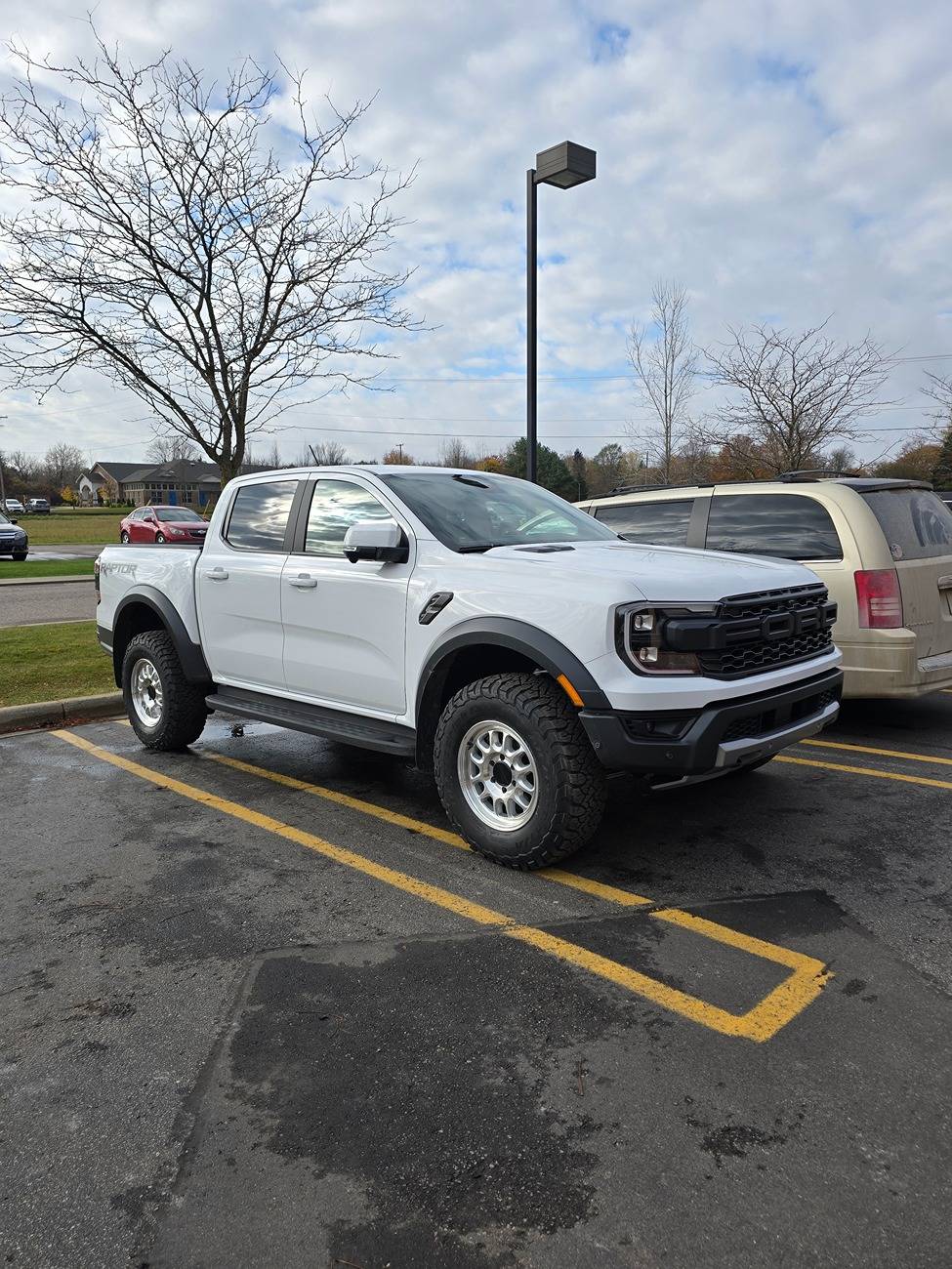

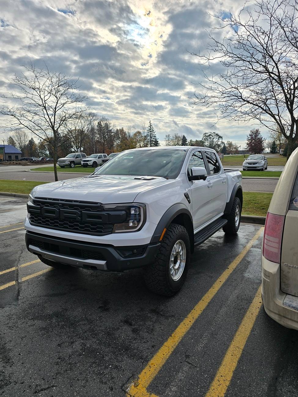

I am trying to find wheels for my 2025 Raptor not having any luck. Is there a company that makes wheels with the factory offsets or close to them? I want to stay with the factory size wheels and tires. Right now I have the beadlock wheels. Thanks..
I bought these Raceline wheels for my Ranger Raptor. They are +35 offset. I called up my local BelleTire store and asked them if they could get me a set of these and they could. So I had it all done right through the local wheel store. Some wheels, they have these offsets, some of them they don't. Look their whole site over and over.

Is -25 a typo? Those look like +25 offset.
You are somewhat correct. They are actually a +35 offset. Man am I glad they aren't a - offset !

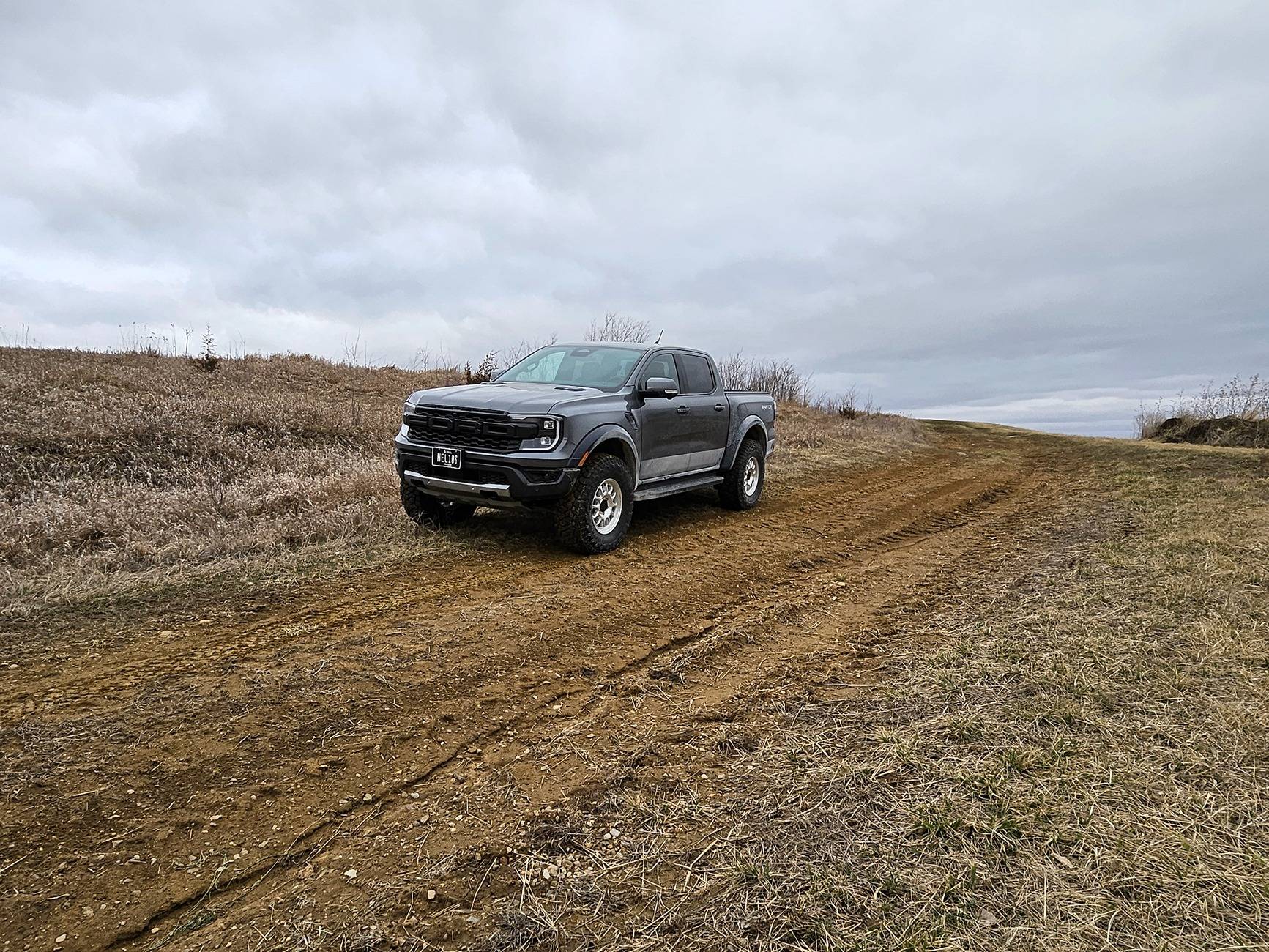

Just got a set of those wheels for mine, what tire size are on them? I'm going to do 35/12.5r 17
Those are the OEM (stock) tires. Post some pics when you get them.
