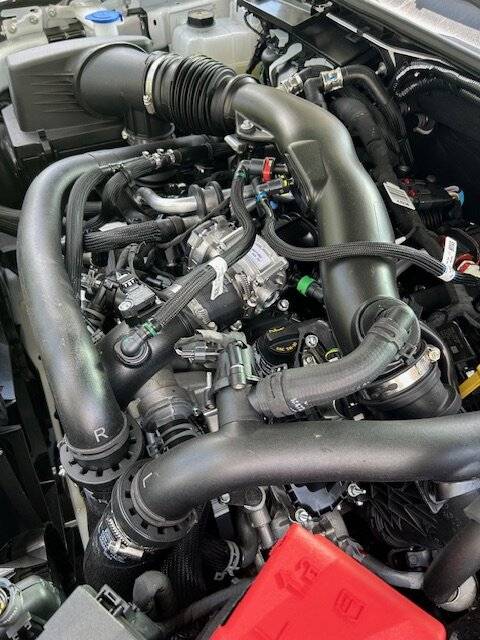

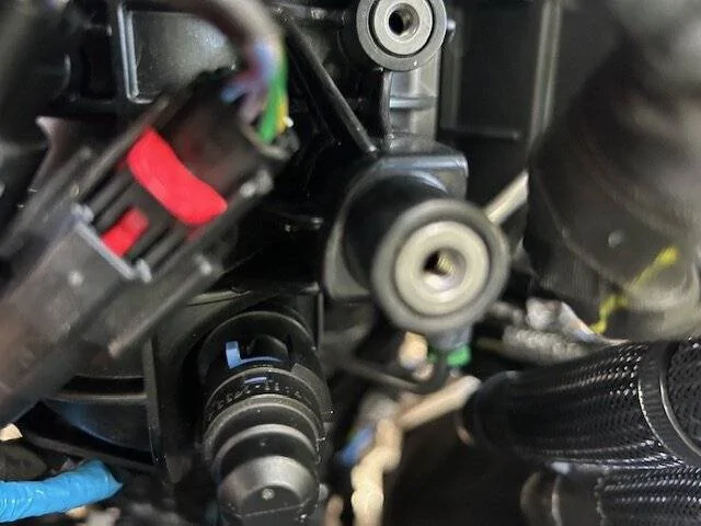

I recently took delivery of my 2025 Ranger Raptor was checking fluids and noticed two unhooked connectors left side is drawing vacuum when vehicle is running. The right side doesn't have any vacuum. I looked all around the area and cannot find where they should go. Does anyone know where they should be connected?

Based on one is male and other female? Do the connection!

Unfortunately they don't fit together. The connectors are incompatible.

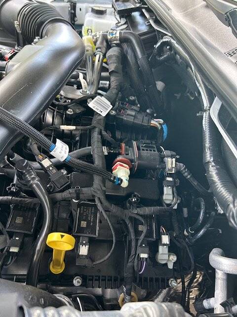

Dre' Dawg
Dec 31, 2024
63
Magnolia, Texas
2013 GT500 Shelby; 2017 F-150 Limited & 2023 Titanium Escape

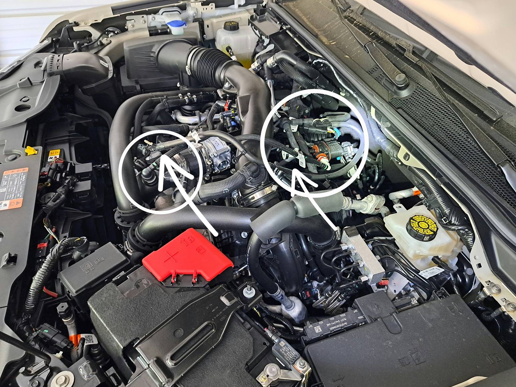

I checked engine as well and don't see anything like that. I included a picture for you to look over.
Ford Ranger Where should these lines connect in engine bay? Raptor Engine 6.23.25
WarScar
Jun 21, 2025
RhodeIsland
Thank you, that photo is a bit too far forward. It's behind the top center pipe, not the ones with out the R & L on them.

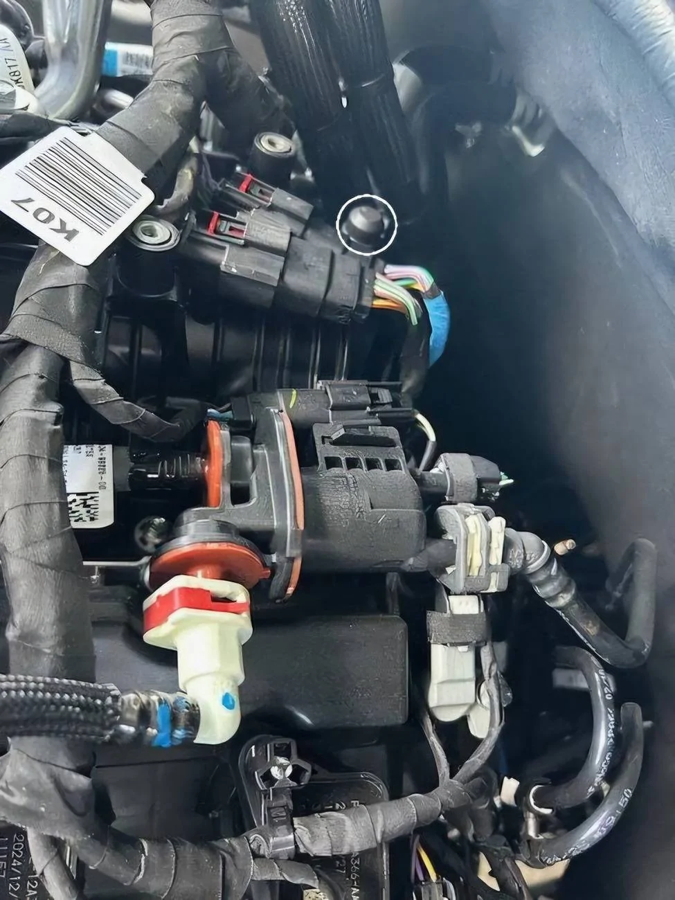

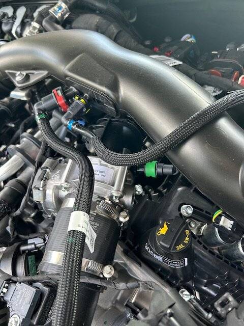

I took two more shots one further back and one of where they went to. Let me know if you need
more infor
Ford Ranger Where should these lines connect in engine bay? Raptor Engine Vacumn line1
Ford Ranger Where should these lines connect in engine bay? Raptor Engine Vacumn line2

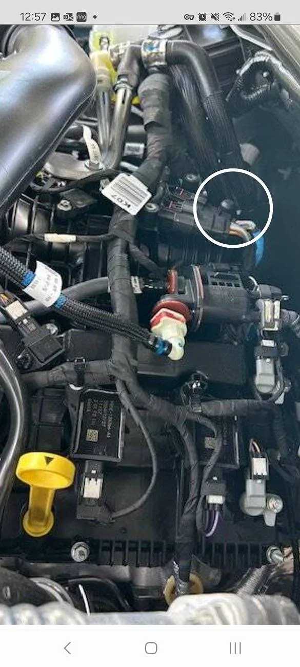

This is where this line connects the white circle. Looks like you don't have a line off it. My line does not connect to anything which makes be belive it was a factory error and needs to be capped. Is there a cap on this spot on yours or solid plastic?

What you circled is a 2 port electrical connection, no vacuum lines. I took a closer shot of my set up. When did you order and take delivery of your RR. It appears they made a change to their vacumm setup. Good luck let me know if you need more pics.

My build date was 3/25. This area where circled looks the same as yours but just has a line connected. The electrical lines sit next to it. Possible to take a top down photo?

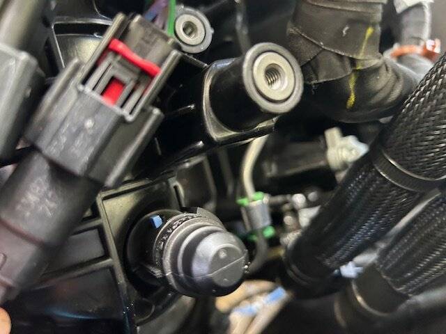

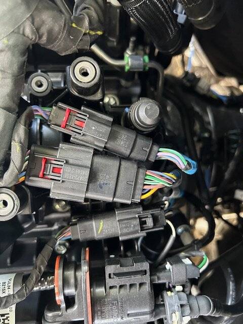

Dre' Dawg
Dec 31, 2024
63
Magnolia, Texas
It looks like the capped a nipple where they tapped the vacuum. It is a hard plastic cap and hard to get a good pic of it.... 3 attached.
