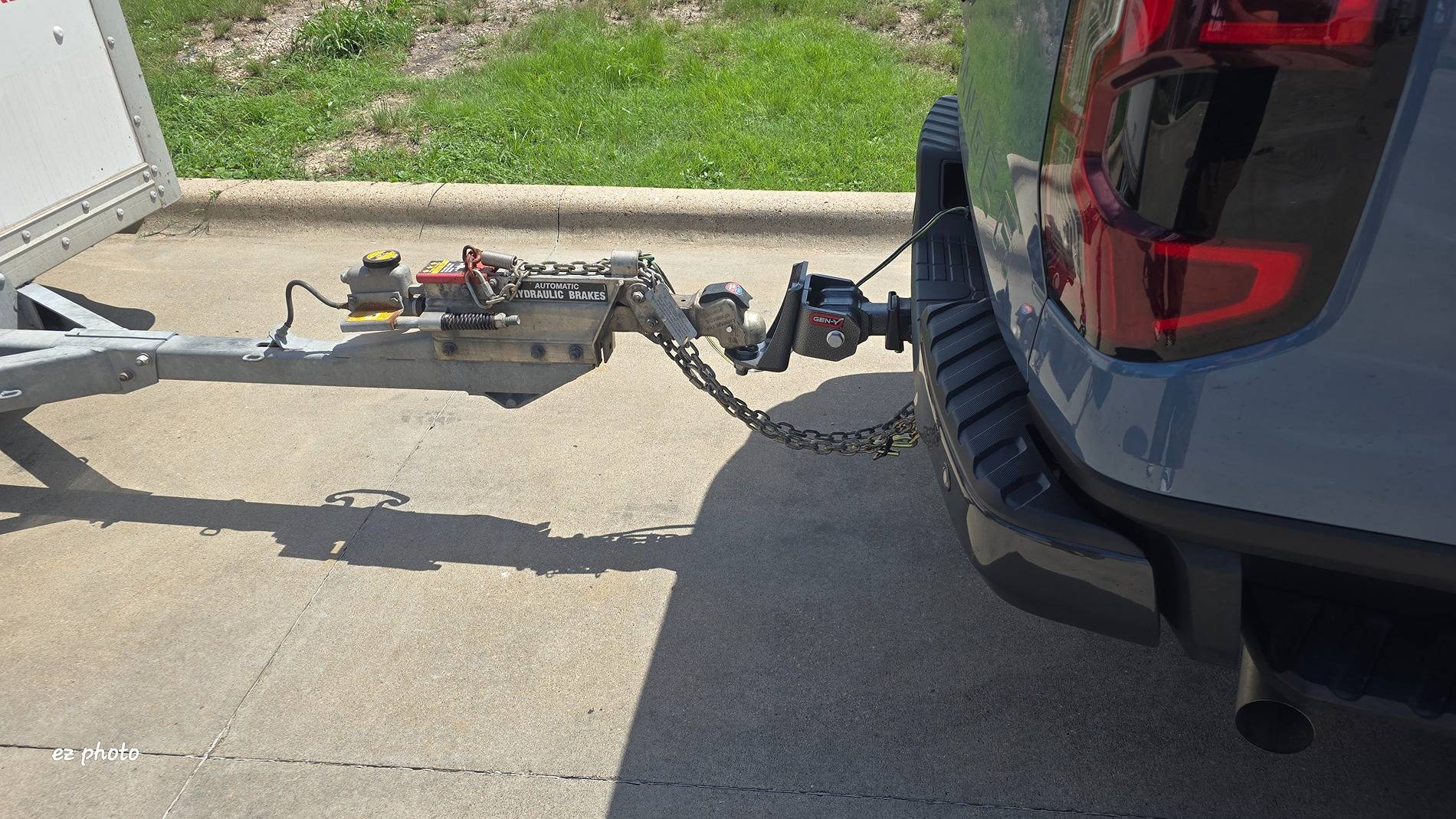

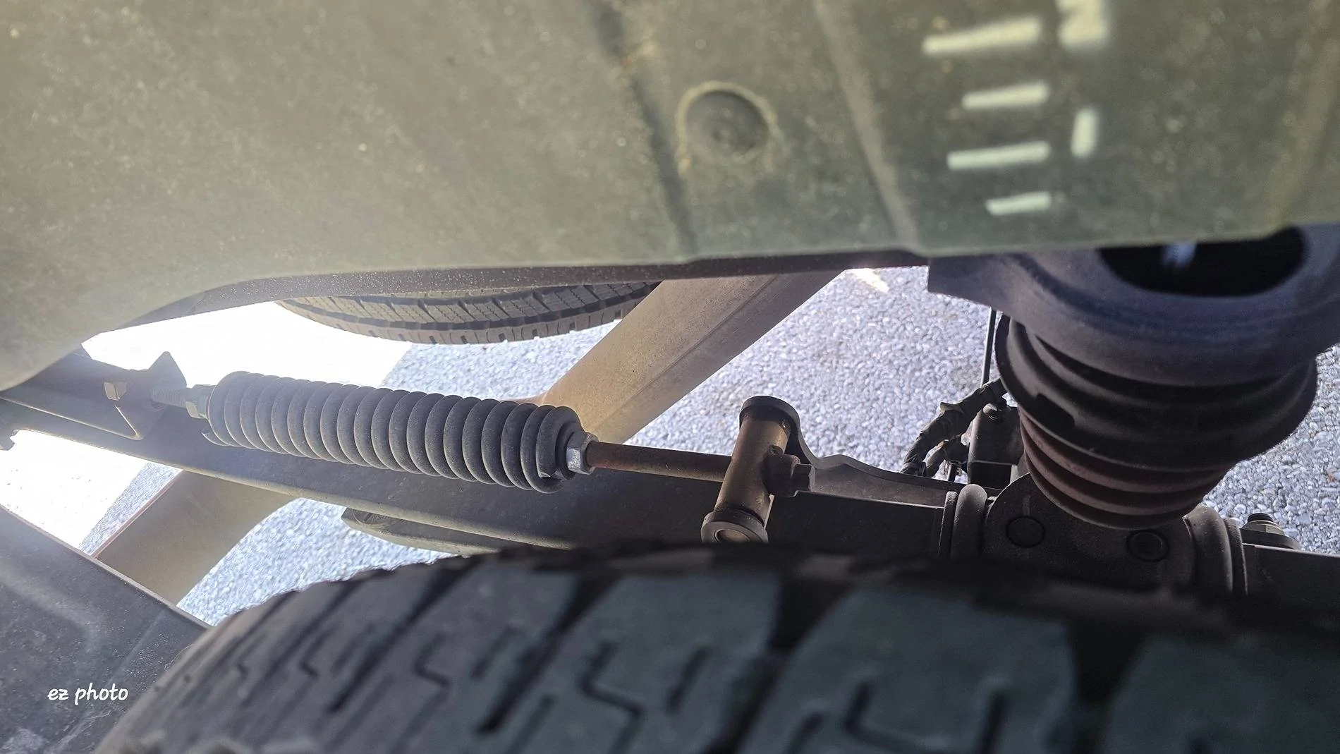

I did not go with a sway bar but i did use the Road Active Suspension. It has helped a lot with squat and sway. Huge huge difference with cargo and towing.
I went with RAS rather than a sway bar to help with load when carrying cargo. Made a big difference with towing too.
Of course with towing, the torsion hitch was a night and day difference too! Smooth smooth tow.
