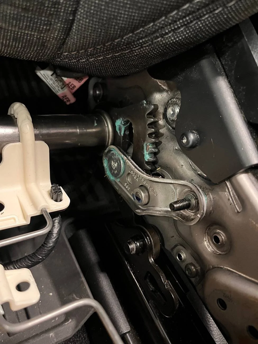

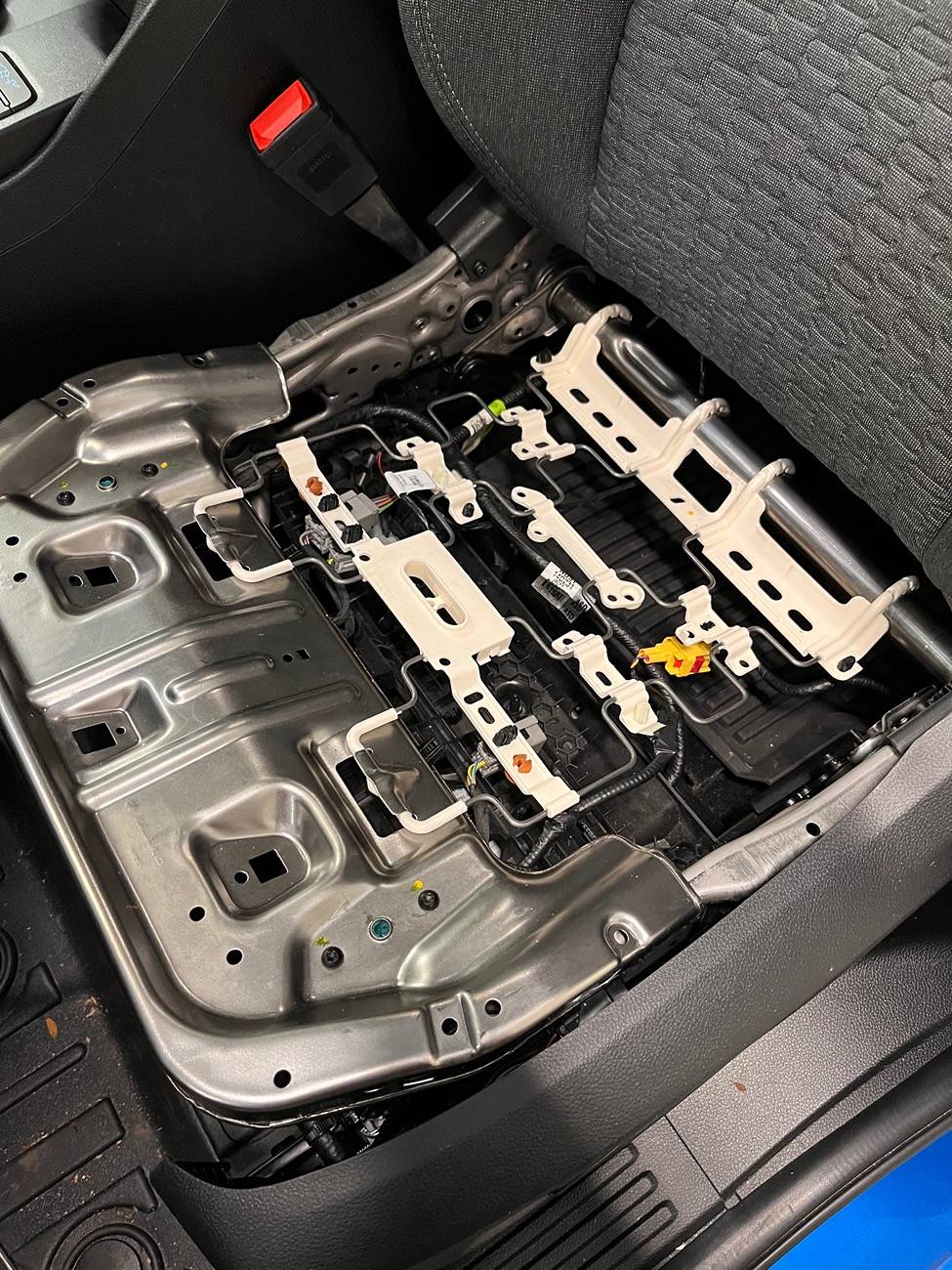

Thanks for the pictures?.
What could be moving in there, the whole part where the white plastic pieces are ?
In my case, I really have the impression that only the center of the seat is "moving." Even when trying to force it with my hand, nothing moves.
so it’s in the mechanism, the motor that drives the seat up/down has a small amount of lash to it. i gotta pop the outer trim off to get the last cushion clip on, when i do that i’ll inspect it ge motor. from what i can see, nothing is broke, or worn in any way. part just might be slightly out of spec.
