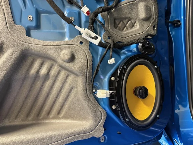

Hoelwiring.com sells a wiring harness for Mavericks and F-150's that will plug directly into the stock tweeter harness. of the Ranger. I recently installed Powerbass S1S 1-inch Silk Dome Tweeters in the front pillars. of my 2024 XLT using this wiring harness. The Metra 72-5602 speaker harness will directly fit into the front and rear speaker stock harness. Crutchfield does offer speaker recommendations for the 2024-2025 Ranger.
