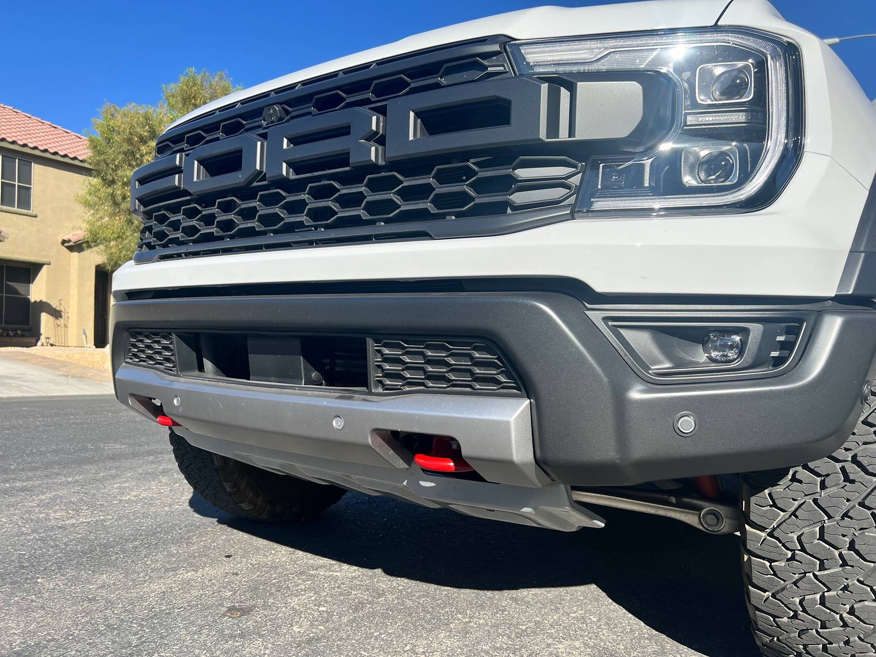

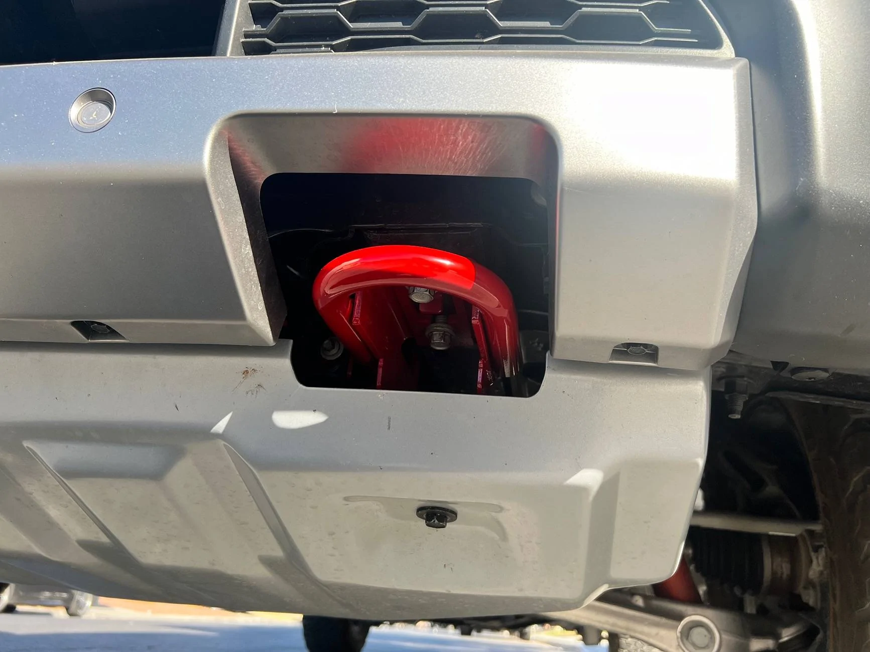

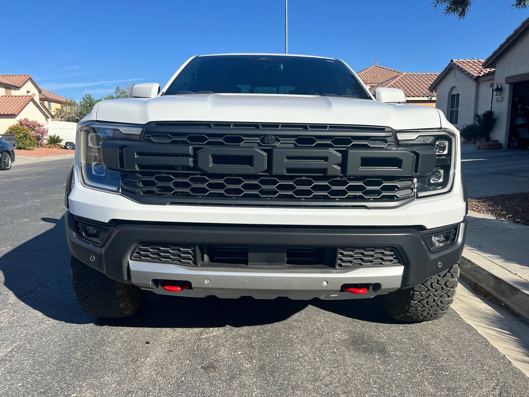

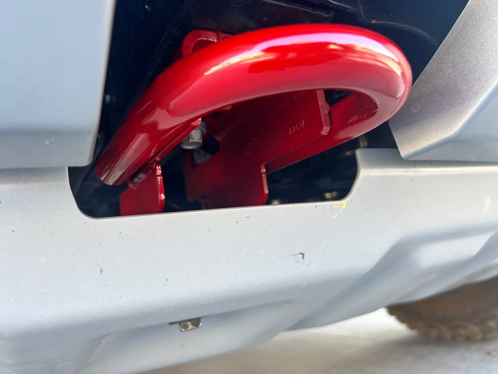

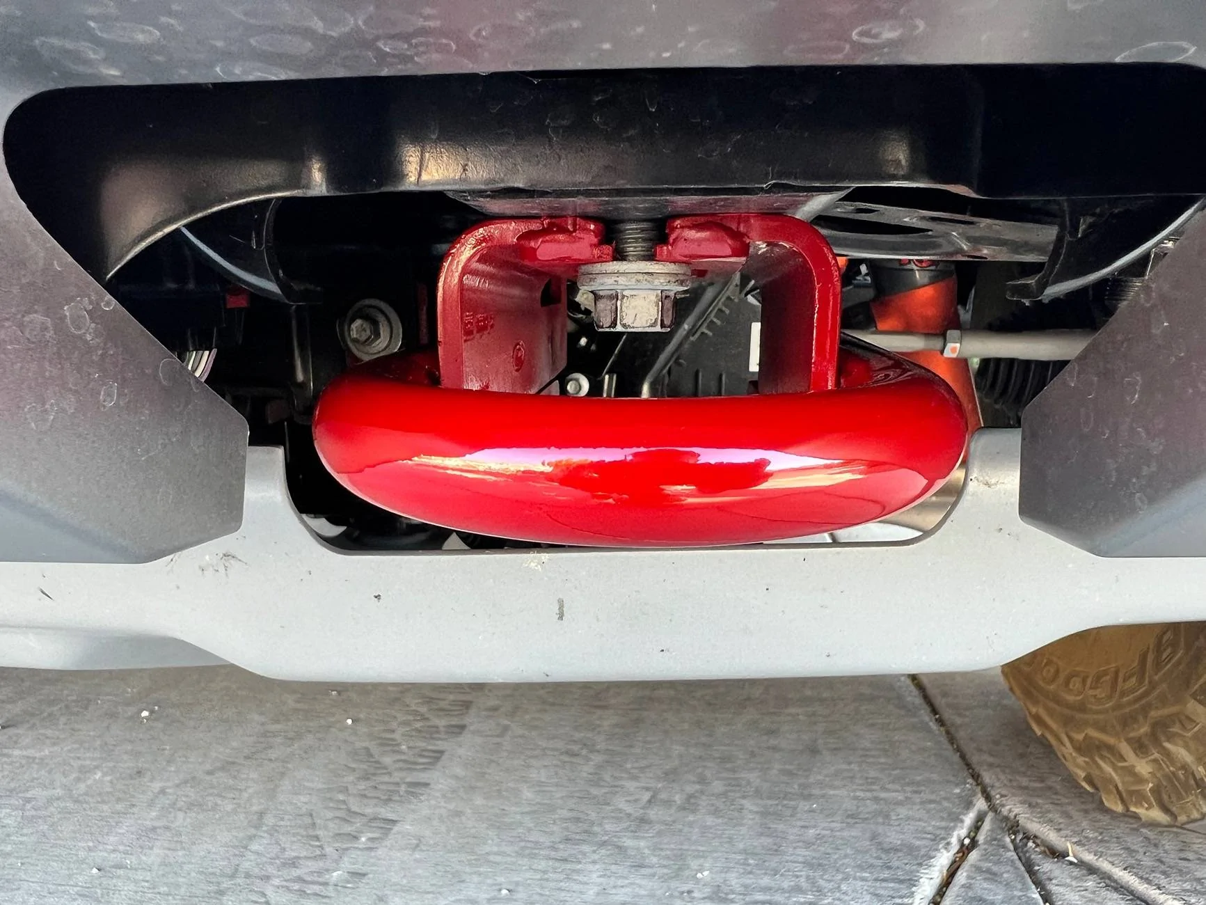

So just as I did my exhaust tips, I decided to paint my own parts instead of buying new stuff.
I removed my skid plate..
Unbolted the two 15mm bolts and the single 8mm holding the intercooler bushing (each tow hook is the same) and removed both tow hooks

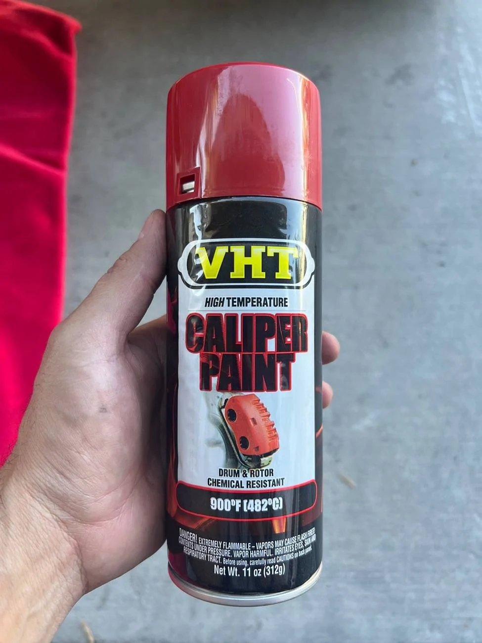

I cleaned up the metal abit but just using degreaser and using soap and water to clean before applying paint
I used VHT gloss red caliper paint. I decided with this cause I heard it resists chipping and it’s pretty thick paint. It cost me $13 at a local Autozone
And results were awesome!
The red looks super bright and it does look pretty thick. I did only 2 coats
What do you guys think?
