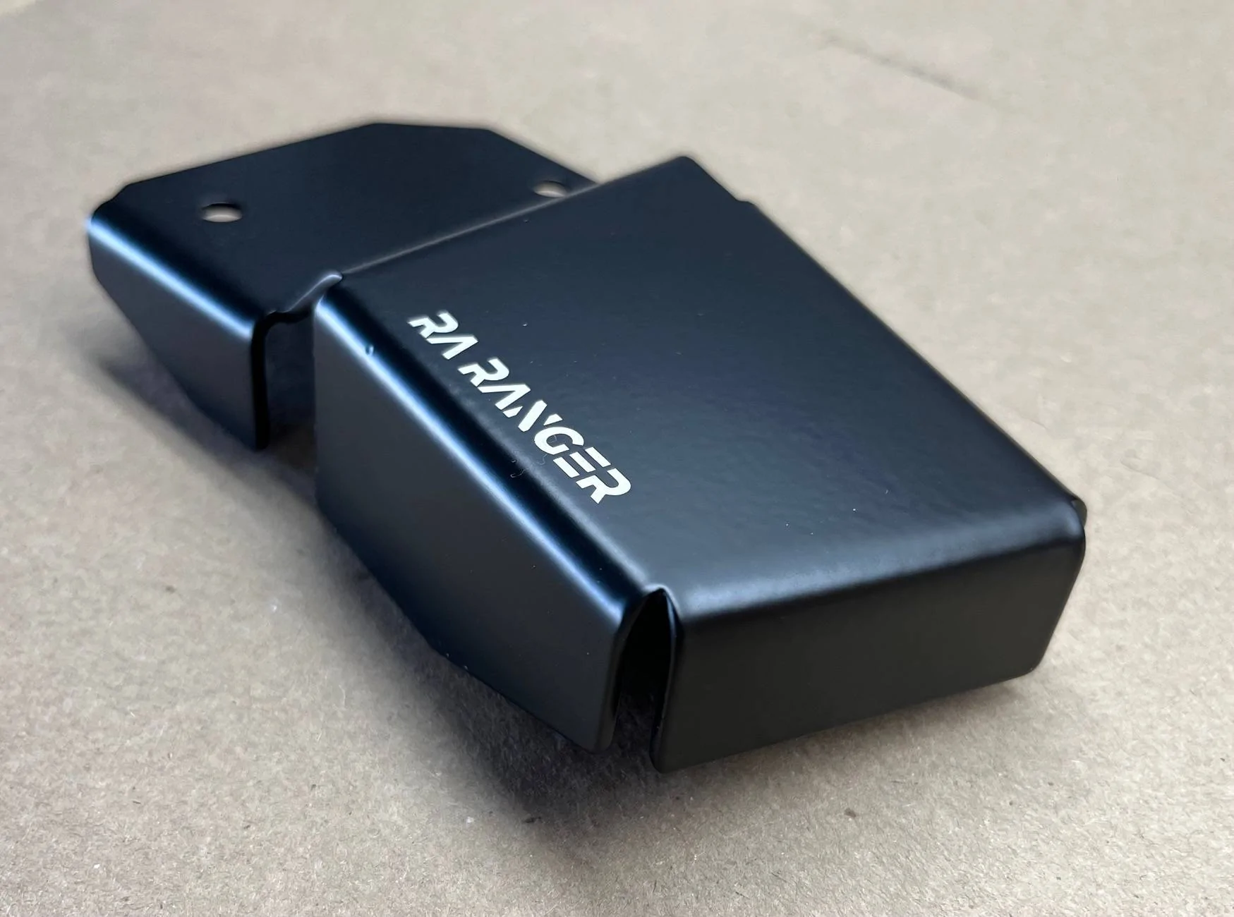

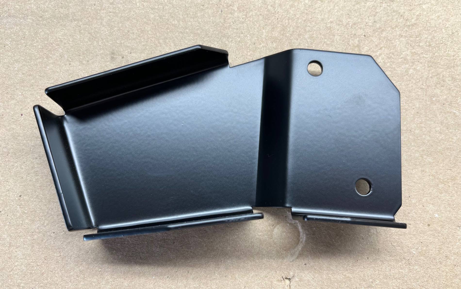

Cost was US$144 shipped, with no sales tax. It shipped the next day, but took about ten days to get here to Washington State. They are nicely made and I think the cost is fair. They are powder coated stainless, in a very heavy gauge.
https://raranger.com.au/products/2022-ra-ranger-raptor-vehicle-travel-sensor-protector-pair

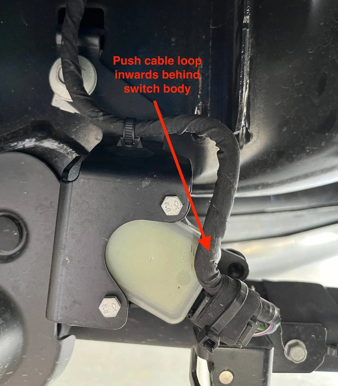

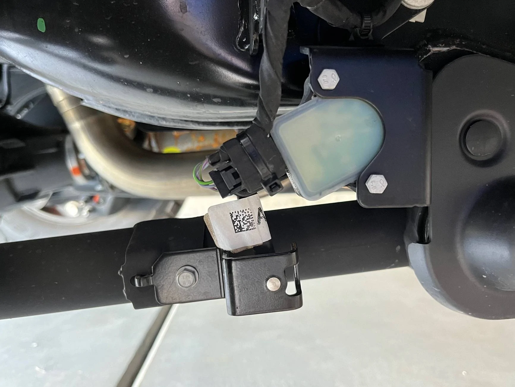

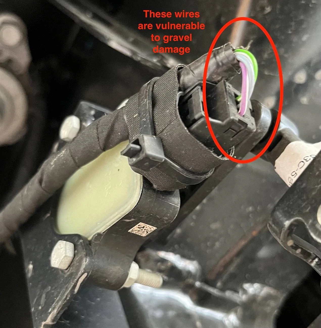

Why do you need them? The sensors and their wires are vulnerable to gravel strikes. My left sensor cable was not secured correctly - the guide support leg/ pin was never pushed into the hole on top of the bracket:
Even with that fixed, the cable stuck out sideways where it can get hit:
Push the cable over the lip of the sensor so it stays behind it:
That still leaves the sensor itself and these exposed wires at risk:

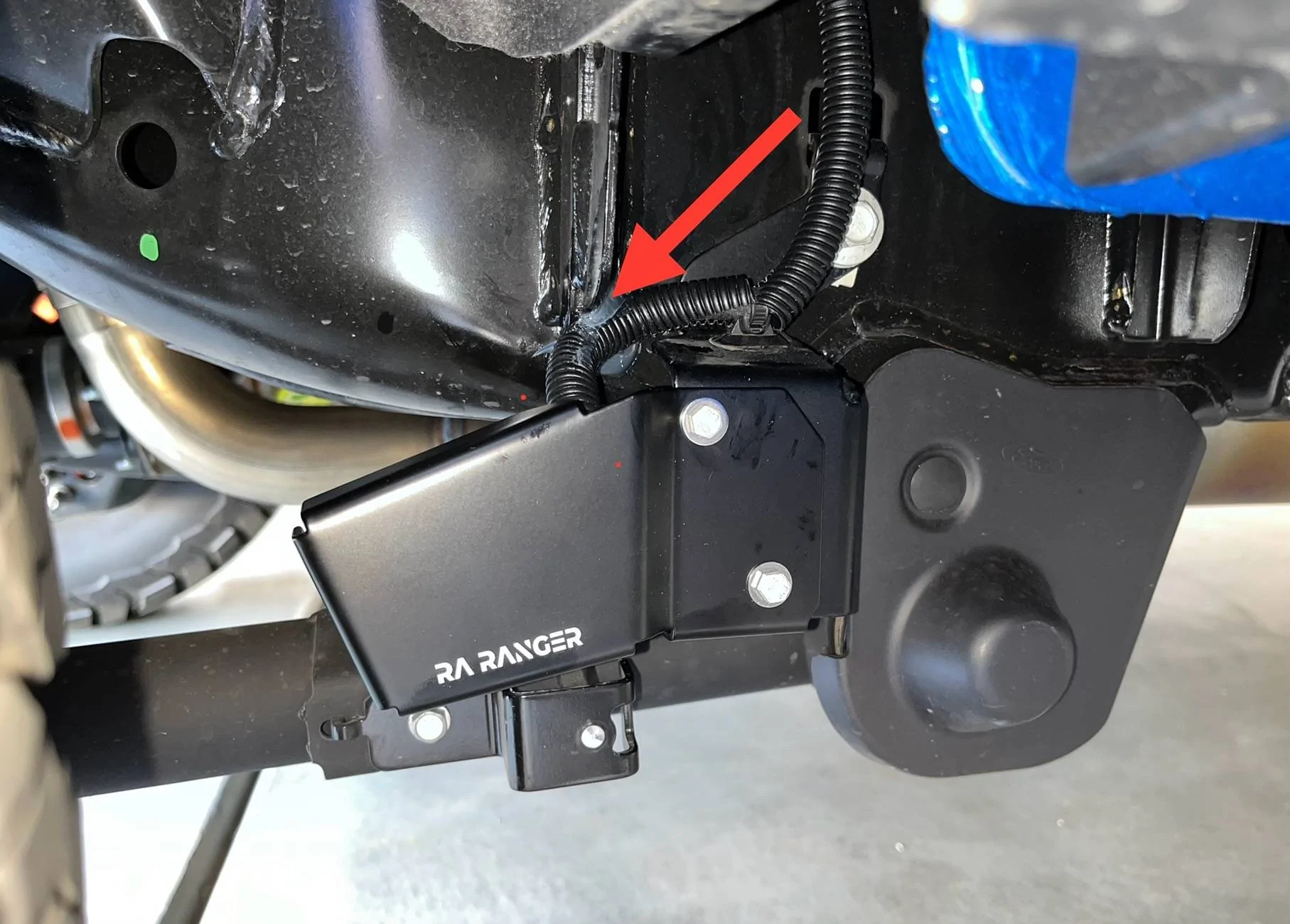

You need an 8mm wrench and socket, about 24" of 1/2 " plastic wire "split loom", and some silicone sealer. Optional is four 3/16" stainless flat washers to put under the bolt heads. Add the split loom to all of the exposed sensor cable, on each side of the guide pin, and add big dab of sealer AFTER installing the guards, with the bottom loop pushed inwards all the way. The sealer keeps it from moving and the split loom protects against gravel strikes and chafing against nearby steel parts. See pics! The rear nuts are a little hard to reach, you can get them back on from the rear (axle side) of the mount. ***The reason you add the sealer afterwards is that it will get all over your hand if you try it before ;( ***

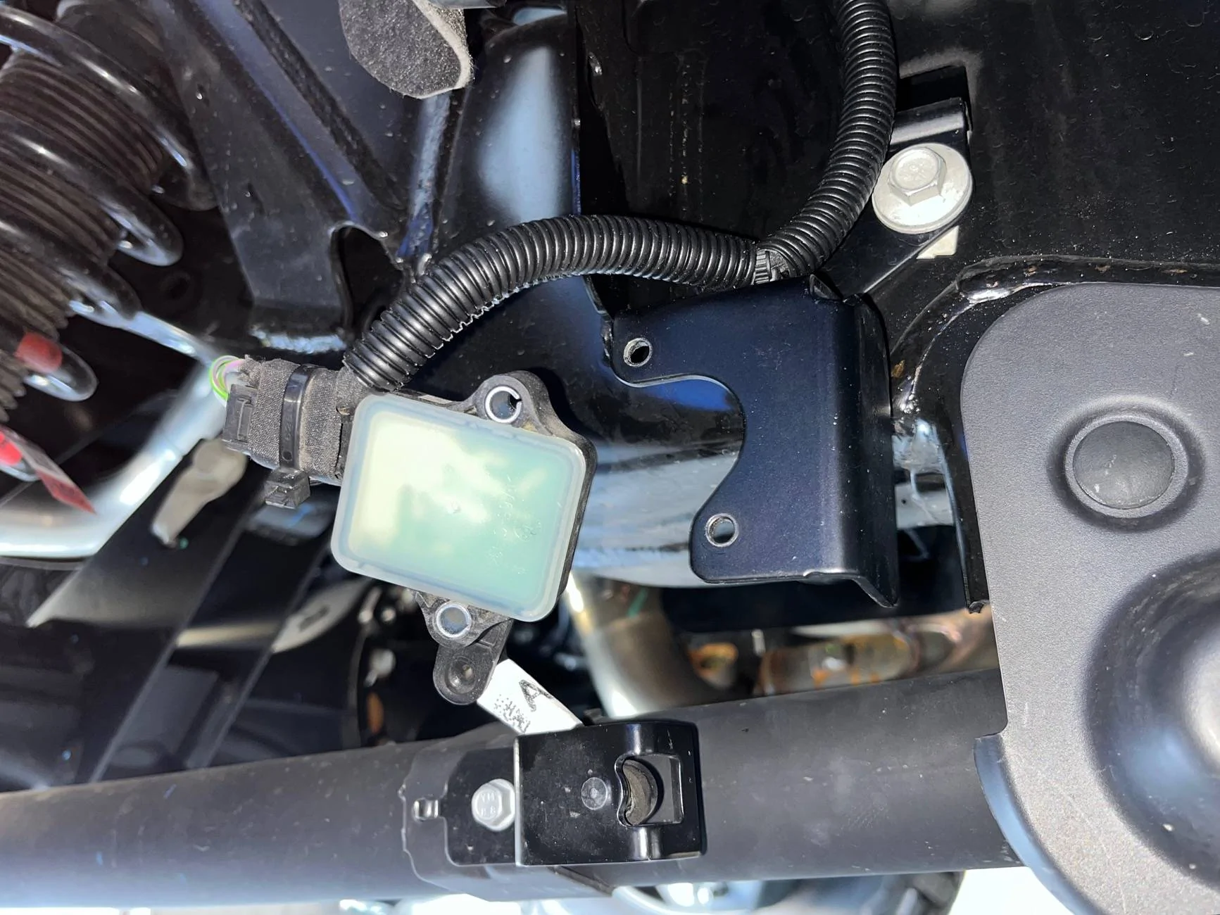

More pics, from the opposite side.
The sensor, connector plug and cable are fully protected from LIGHT strikes. The trailing arm bracket and its dinky little control rod are still a little vulnerable, I don't know of a way to help that, except be SURE to add large front mudflaps if you drive on gravel:

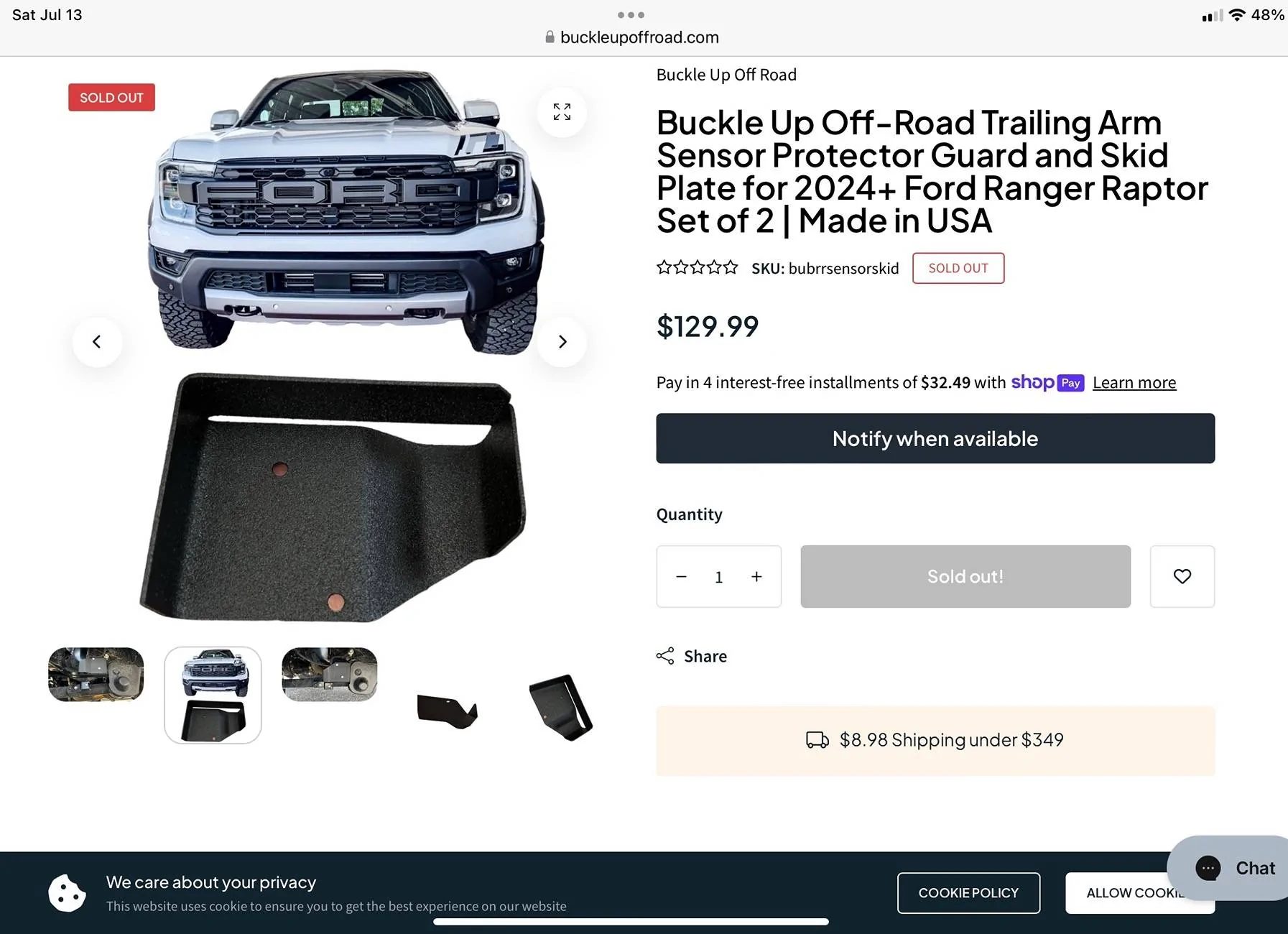

Watch the YouTube video from Buckle Up Buttercup. She was driving RR through water and sensor disconnected, threw all kind of warnings. They found problem after awhile. She now sells a sensor cover on her website...
Thanks!
Video Solving the Ranger Raptor’s Biggest Flaw: Drive Control Fault Fix | Trailing Arm Sensor Guard
Product page:
https://buckleupoffroad.com/product...r&utm_source=youtube&utm_medium=product_shelf
I would like to know what the material is - stainless? - and I have to comment that once the plug gets yanked off, it ain’t gonna stay reconnected, the plastic retaining tab in the sensor or in the plug, or both, will be damaged. Also in the videos the guy just plugs it back in without cleaning out the mud and water from the parts, that isn’t good at all!.
I think the RA Ranger one offers better protection (more sides covered.) I would probably have bought the BU parts if I had known about them, but I have zero regrets about the Aussie kit. Any style is better than none at all. This should be factory equipment!
