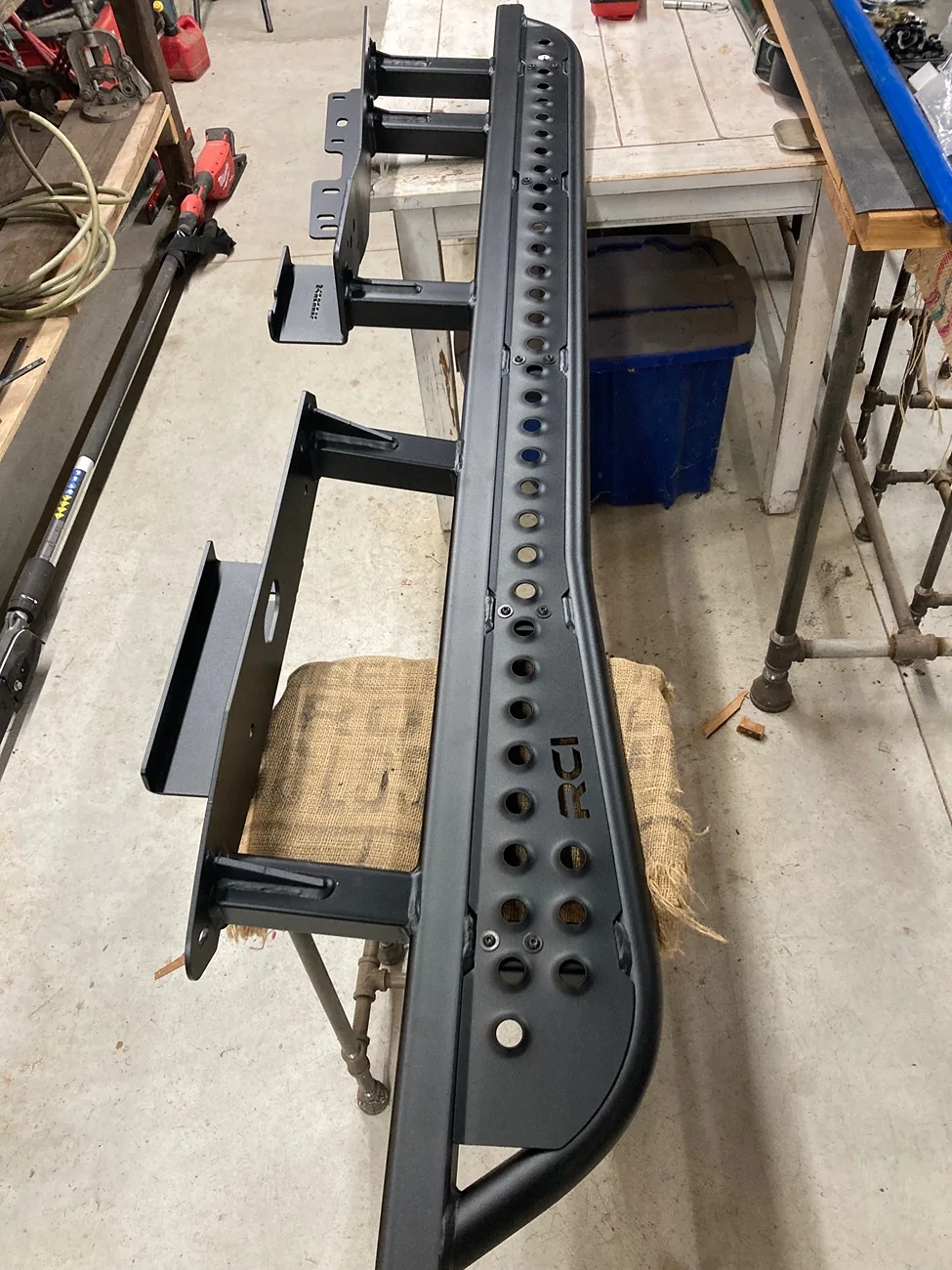

I just installed the new RCI frame mounted rock sliders and I would offer some other thoughts on the subject based on my experience. Pros and cons. First, the RR version doesn’t fully wrap the box frame on the driver side due to the gas tank being so close to the frame. So the driver side rear connection is only bolted Through the side of the frame. Bottom line, I think the driver side is not as strong as the passenger side. Haven’t tested it yet to see how much deflection there is. Second and probably more important point is that I had to disconnect the wiring and brake line mounts from the frame to install the sliders and when I tried to reattach them I had some issues. There is not a lot of room for them with the frame mounted slider and the provided reattach meant points in the new slider didn’t line up with the points on the frame. I am still working on a permanent solution but I am using adhesive zip tie mounts for now because I ran afraid of drilling mounting points in my frame. Not sure what that would do to the integrity of the frame. The sliders look good and I think they will be pretty stout but but body mount sliders would have been a whole lot easier.

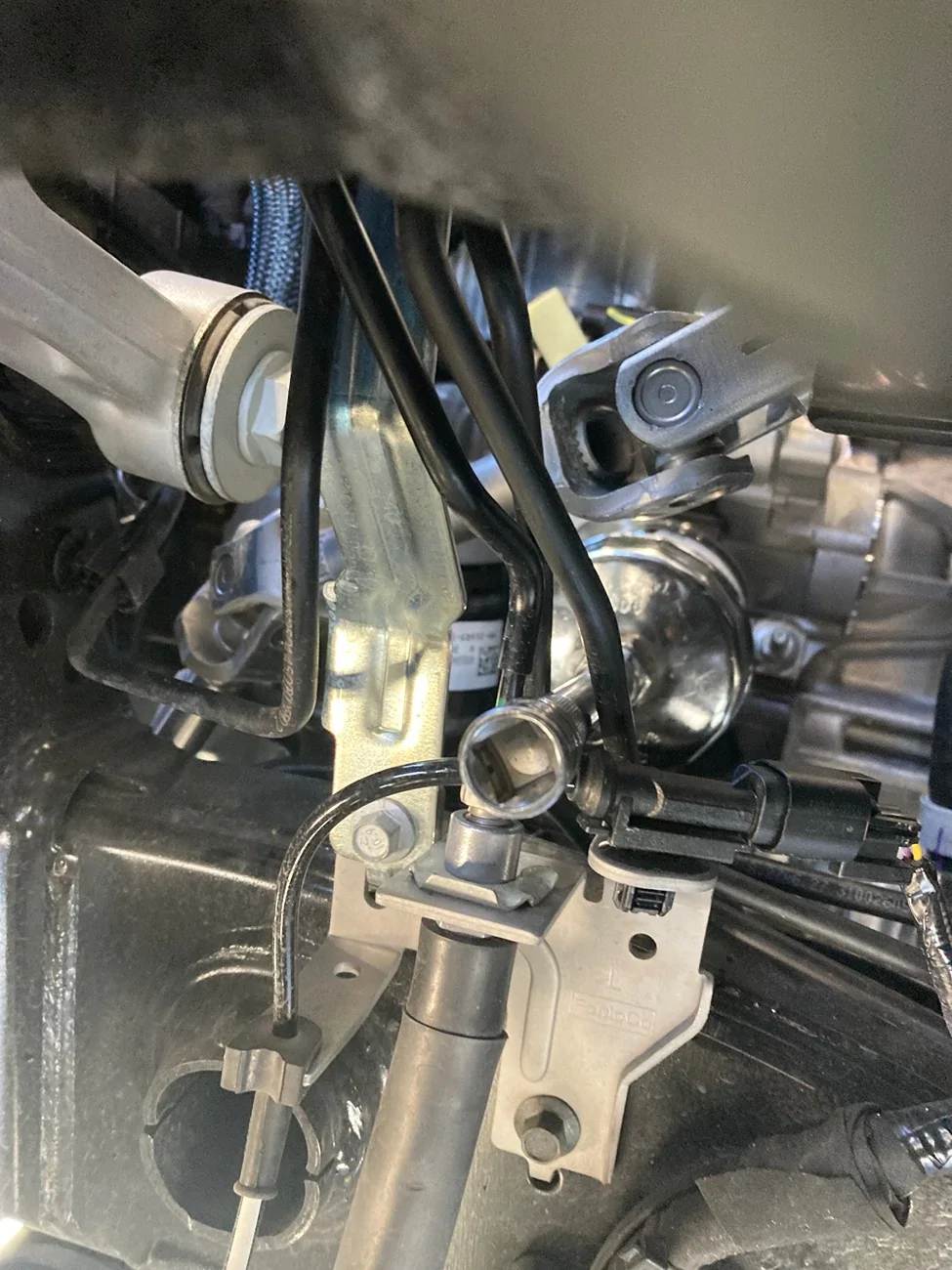

Have to think about what tools i will use. I got hooked on Metric. My 3/8" ratchet is what I had. So not thinking correctly I did not bring my 1/2" ratchet down to fit into 74mm socket.
This would have created a shorter distance to socket. Meaning that you could take the oil filter off from the top our side. The 3/8" adapters made it more work then was needed.
Look at this silly setup with 3/8" ratchet.

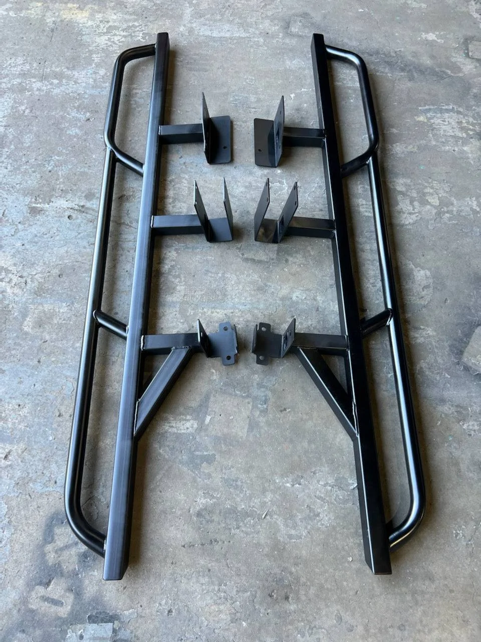

I am going to receive my Rocky Road Sliders soon. Just came out of the Powder Coating Oven.
So, I posted the sliders and the pinch weld setup. There was mentioned that it should have gussets on both sides of mount. Like Goat Design. So this got me going. Rocky Road has a $100 add on for thicker outer tube and more bracing. Its been 2 months. There was X Mas though.
So, I phoned today to see if i could have the add on.
I had E mailed and phoned. Kinda fun to understand who will get things done in the establishment you are dealing with. Nothing worse then it falling on deaf ears. . I showed my dismay.
Just said just give me a good product. Stating that i am a machinist.
So, kinda thought they were coming up to being made. Tried to understand where my allocation was. Thought I could up grade to Beefier material and gussets/brackets.
The operation manager contacted me. Told me they would ship in a week. Great.
So, the rocky road Sliders. The Production Manager said, if it was going on an F150. Do the thicker pipe and gussets. Said it would be fine for Ranger.
Here's a few engineering thoughts. RR offers a wide pinch weld clamp. Just have to find a 90 degree drill. When you go to the RCI frame ones you have to consider the extra weight.
Myself, I am not going to do hopefully off road trails that I would slide into large boulders.
Ha ha, mines the Mall Crawler. So since i commute with the Ranger in a City and a few camping trips per year I consider more of what happens with a side impact. Is ridge better when attached to the frame. The floor of the Ranger seems very well engineered from many crash tests.
One of the things that was important for me is to have the kick out at the back of the cab.
Same with rear side step. I strap items to the roof. Run a T Bar on hitch. The roof on the 6G is to long. Purchased the shallow. Dometic bolt on roof rack.
Its too funny for me. I could wait again. In no rush. Have the more braced model made.
I have thought this through. This stuff torments me. I think i will be happy as long as they mount up perfectly. Going with the Elasticity Concept instead of Ridged.
I just ordered the Rocky Road Outfitters rock sliders. Well, I guess i'll be waiting longer than expected, they didn't display lead times on the website, so I guess i can expect march timeframe for delivery.
I ended up going with the "rock crusher" option, which i think you mentioned the thicker tubes and gussets. I live in the Phoenix Valley and have been holding off on some off-road trails until I receive my sliders. keep us updated on your install when you receive them. I'll be looking forward to that so I can hopefully get some lessons learned from you!

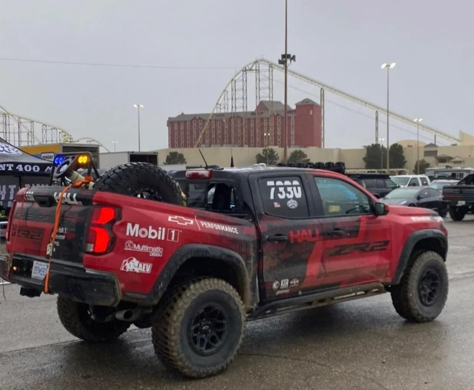

FWIW, the Colorado ZR2 uses body mounted sliders. It’s pretty obvious that they’re not as strong as frame-mount, but they‘re also a lot easier to install and will definitively provide some protection. I think this thread does a good job of highlighting the pros and cons of each. Very informative all around.

Something about that design screams poor quality. 1/8" wall square tubing and not a single gusset between the square tubes and frame brackets. And even if they did hold, there is so much distance between the brackets and the outside of the sliders your just asking for your frame to get twisted due to the amount of leverage exerted. But I guess you get what you pay for.

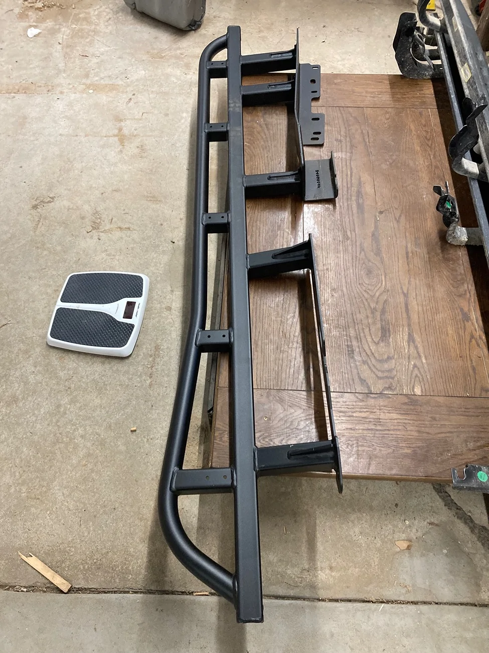

Btw anyone know how much weight the GOAT sliders add over stock running boards?
My build is a light weight rally build, but one of the few things Im willing to add some weight for is rock sliders since they offer a lot of bang for buck in offroading on stock tires and ride height.
