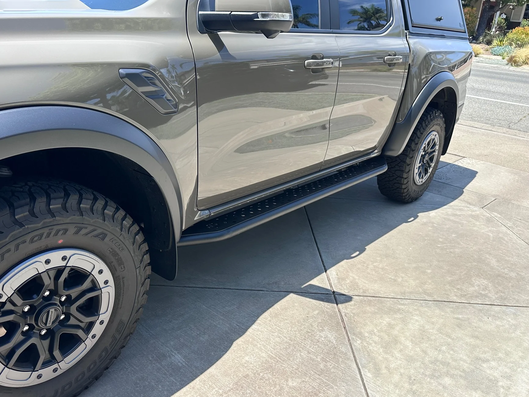

I really like the look and the preservation of the backs of my legs.

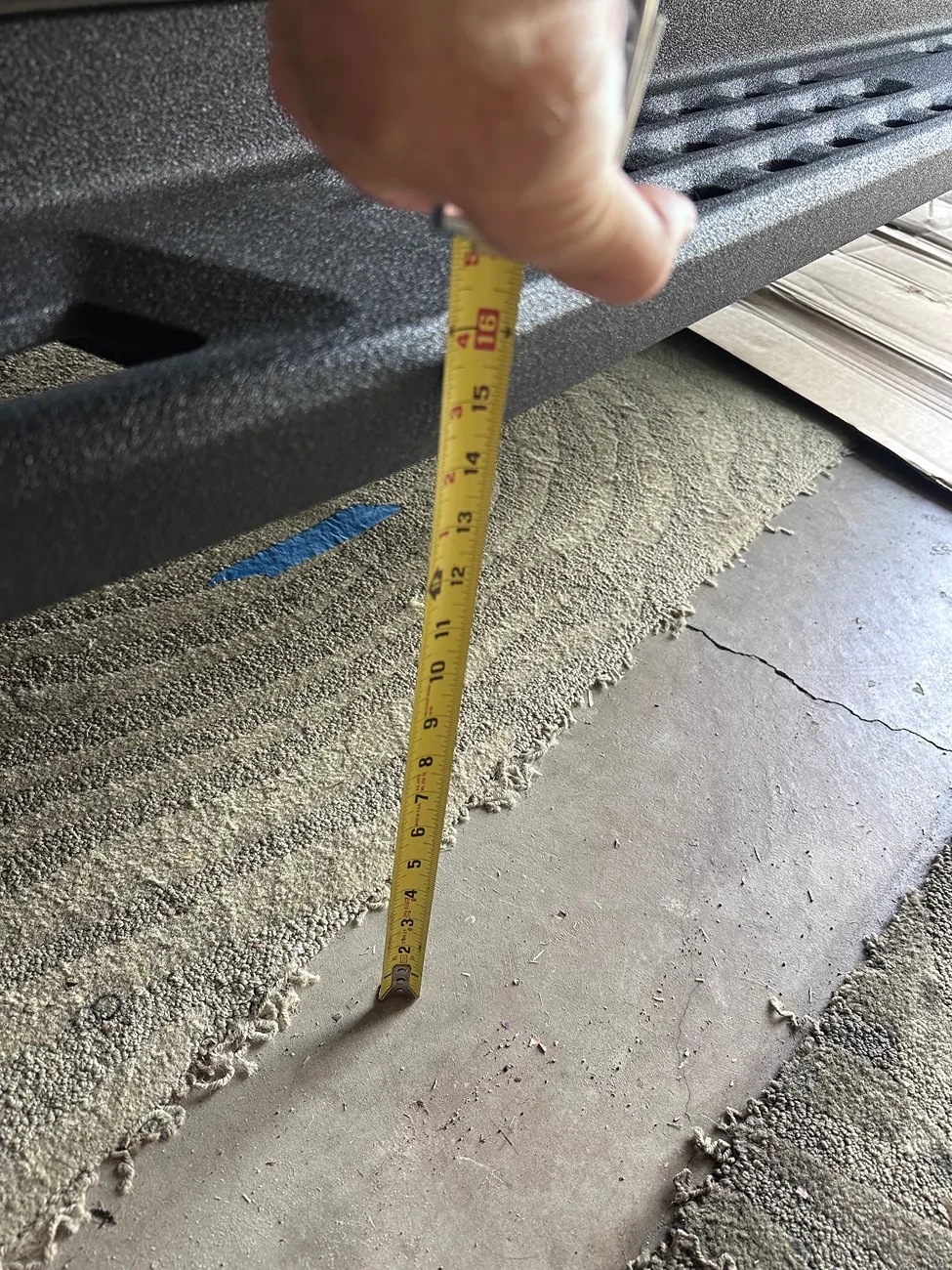

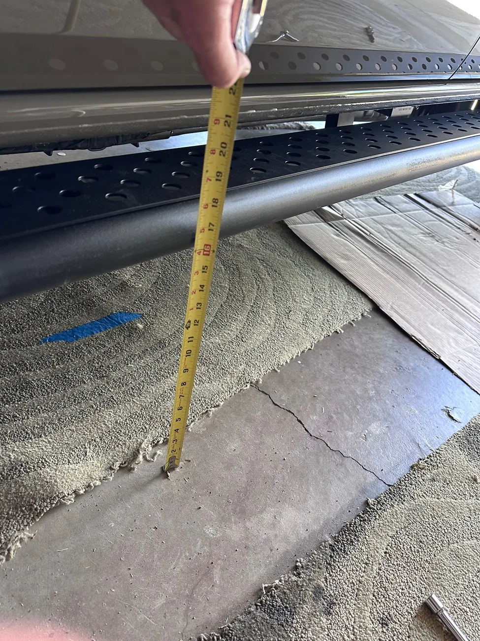

Not sure this thread needs more, but bought these sliders and thought I’d offer some feedback. If I thought I’d spend every weekend rock crawling I might feel different, hell I probably would have bought a different vehicle in that case, but for some occasional use on rocky western trails I think these more than have the stuff. I bought the step version to give some more protection from tire kick-up and to give my wife a perch to get up in the truck. They are much heavier duty than the stock steps and give a couple inches of clearance in a vulnerable area. They were nearly half price compared to the hot metal fab sliders and much easier to install, both were factors in my decision. Getting in and out of the truck isn’t as easy as the stock steps, but I think the stock steps look like shit and are inferior in every way except for ease of access, so the trade off is fine for me. In short, maybe not the ultimate in slider protection, but more than fit enough for my purpose, at least for now.

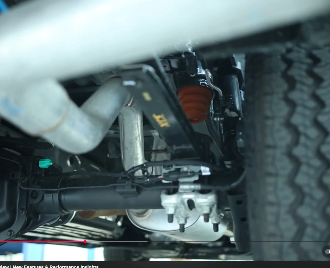

It's elastic impact, not in-elastic. The sliders aren't deforming but flexing like a spring steel and they only flex so far before reaching the limit of elasticity (like a coil spring bottoming out). This allows some of the impact energy to be stored in the flexing mount and the cab isolators, then returned once the load is removed. I'd rather face some flex in the mount brackets than sheered bolts, puckered or twisted frames because that's a totaled vehicle right there.
But hey, if you'd rather have a bent frame.....by all means. GOAT actually says in their testing they had frame mounted sliders fail in the field, they have seen puckering and twisting of the frames from frame mounted sliders due to the leverage because modern boxed frames are designed for shock / spring mount locations outside the frame, not inside like the old C channel styles.
So boxed frames are narrower, allowing struts and springs to be mounted outboard and tuck in under the trucks much more than the older C channel frames of the 60's, 70's, 80's, 90's and early 2k. Some flex is perfectly fine and beneficial as I mentioned above.
Have you ever seen an underbody camera of a Mustang or Camaro IRS at full throttle on a drag launch? Those diff's move around like crazy! So, guess what, people started swapping diff mounts for euro thane thinking "the stock mounts suck, they need to be rigid, cause rigid good, move bad".....then came the broken axles and even broken clutch plates at the rivets....same principle here.

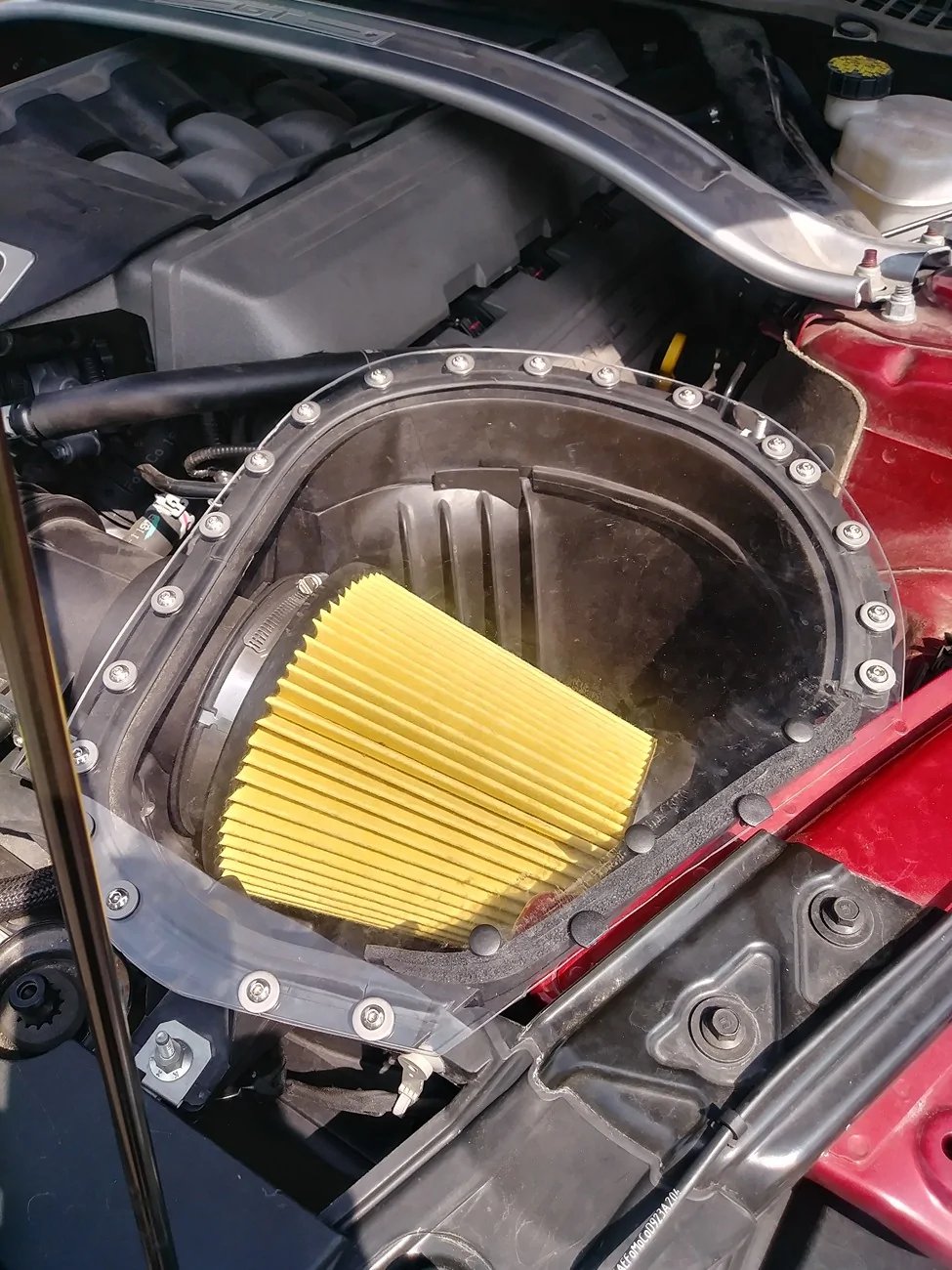

Watch the video from GOAT, unless you want to say they are lying...and I agree with you on K&N, I never use their filters because upper cylinder group wear is directly proportional to dust contamination and K&N filters allow an order of magnitude higher fine dust contamination, thus accelerating ring wear.
GOAT and Rocky Road both provide excellent explanations and have seen similar issues with frame mounting on this platform, but like I said, do what you want, I'm done arguing because clearly you can't get around your own thinking on this particular topic.
Switching back to the tangent of filters, I think K&N filters are fine for track use (road cars, on a prepped track), but not for off-road or daily drivers. They also have 1/3 the dust capacity of pleated paper filters and an exponential restriction curve, so they clog 3x faster and become very restrictive once clogged, a clogged K&N is more restrictive than a 50% life paper filter lol. It's why I stuck with the larger conical filter on my 2016 GT with Stage 2 Power Pack using the GT350 intake + throttle body + Ford Cal.
