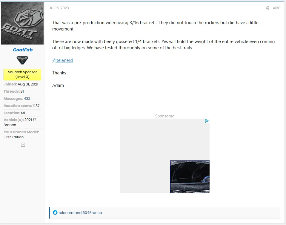

Adam from GOAT said they originally tested frame mounted sliders and found it was twisting the frame and causing puckering because the leverage of the sliders on the frame. People forget these are not the old C-channel frames that acted like big springs (designed to allow some flex, strength was achieved via mass / material, not so much structural architecture).

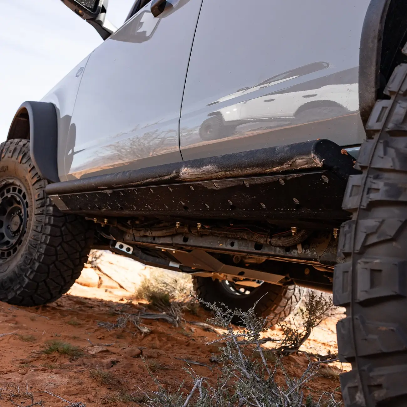

This video was with the updated 1/4" fully gusseted brackets (what has been shipping for well over a year now). For the 4-door bronco, which has a cab length close to the Rangers, they weight 45lbs each according to GOAT, so I'd imagine the same slider for Ranger Raptor is pretty close, in the 45~5lbs range per slider.
Stock side steps are cast aluminum with steel brackets, and I recall that they weight around 30lbs range, so not a huge weight gain over the stock side steps, but a LOT more clearance and protection. With the tighter fit and 20 degree angle, you gain 4" of clearance on the sides (obviously that won't help breakover on flat hills, but it will help breakover on off-camber or when crawling of rocks on one side, which is probably the most common hang-up of the stock config with side steps).

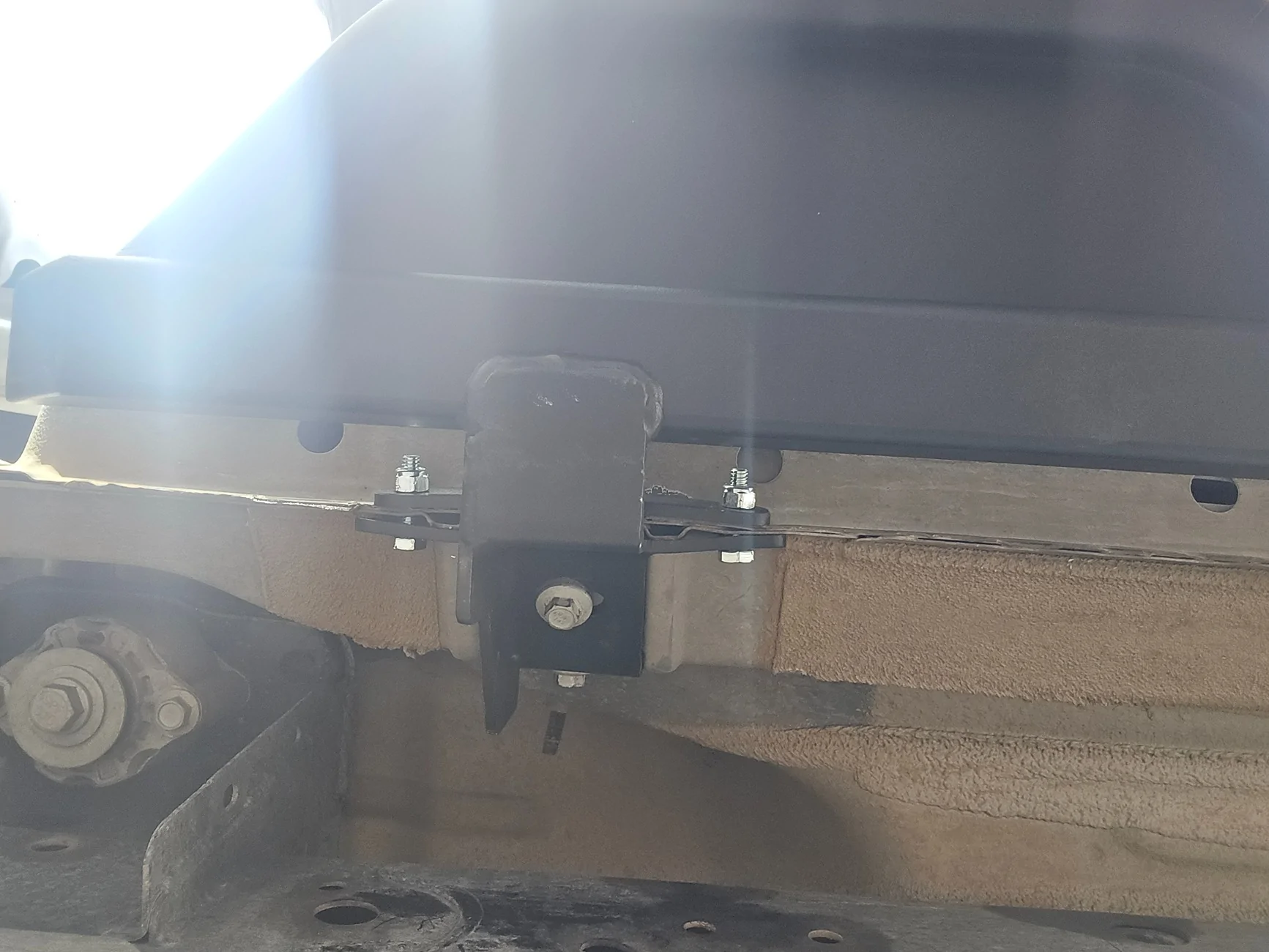

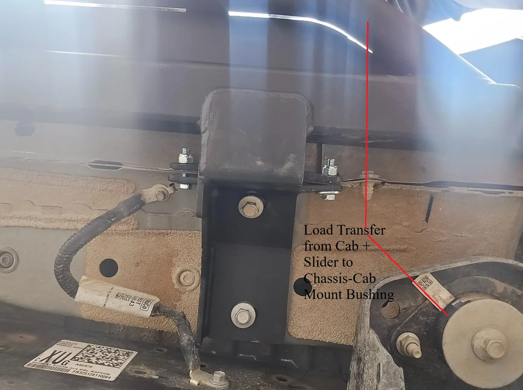

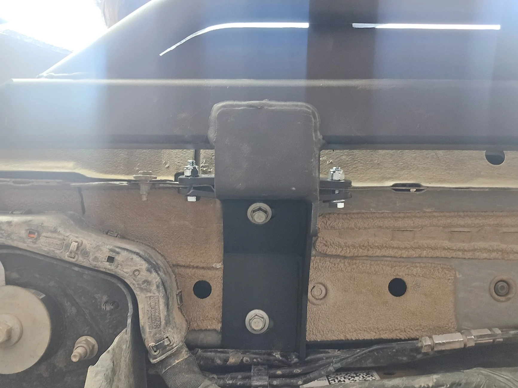

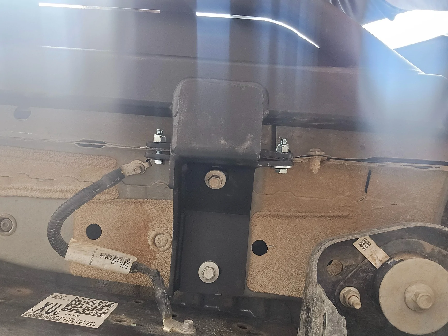

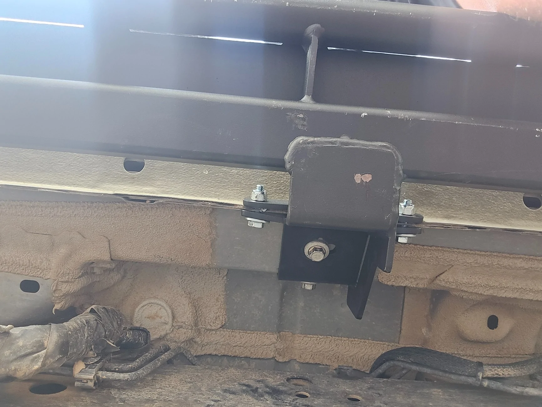

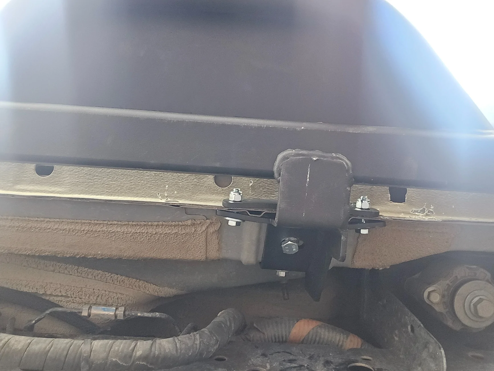

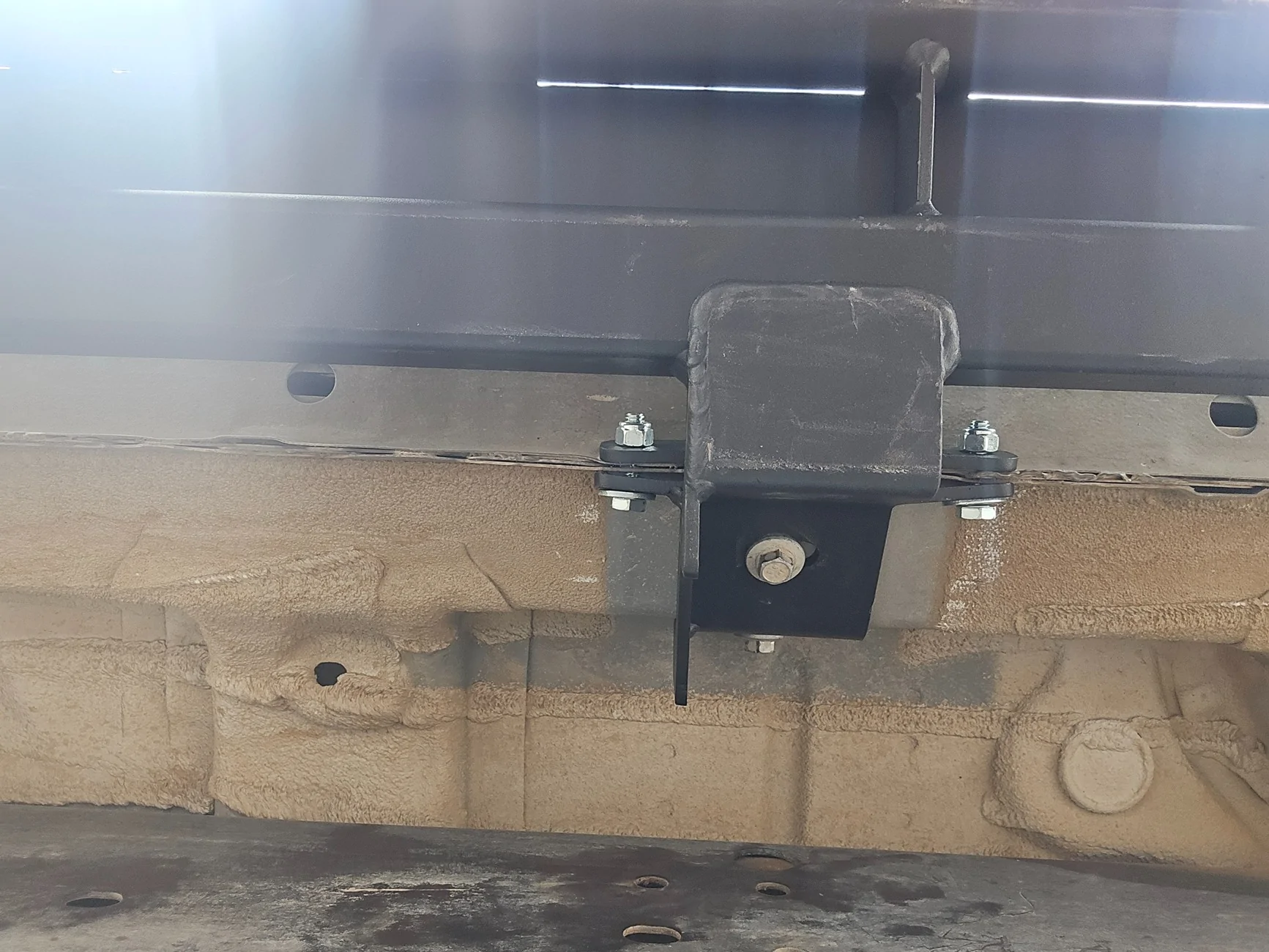

Ive had a local custom shop install my rocky road "rocky crusher" rock sliders. Im going to just post pics and stay silent and allow comments to come in.

Below are the reasons why cab mounted sliders on the Ford T6 platform, Jeeps and Colorado's are the best way to go. People aren't considering all the dynamics involved and the actual design, they are just blindly transplanting an outdated standard to a modern system....
Problems With Frame Sliders on T6 Platform
1. Chassis rails are further inboard than older C-channel designs, creating a very long lever arm that twists the chassis rails due to the length of the slider mounts needed to reach the chassis. C-channel frames were wider because they acted as part of the suspension and the struts were mounted in-board, not outboard, necessitating wider frame rails than on modern truck frames. Different designs with different properties. C-channel frames are also prone to sagging, especially with age, which is why you see a lot of older trucks bucking at the middle between the cab and bed!
2. Fully boxed Hydroformed chassis are designed for maximum rigidity and minimal weight, this is a very different design than old school C-channel frames which were designed to flex and lacked torsion rigidity of a fully boxed hydroformed frame! Mounting sliders to a C-channel frame made a lot of sense since it was designed with some inherent elasticity, the C-channel rails were heavy duty AND the cabs of those older vehicles did not have structural impact areas like modern cabs do.
3. Using the factory mounting locations on the T6 platform allows the load transfer path to be through the cab-isolator bushings to the chassis. This allows for some shock absorbing function, which is exactly what the rubber bushings are designed to do. So not only do you have less leverage on cab mounted sliders due to the short mounting brackets, but you also get some peak force relief by transferring impact energy to rubber isolators that are.....you guessed it....designed to absorb shock loads.
And yet the ideologically driven zealots will go on chanting endlessly forever, "Only true believers mount their sliders to their frames, if you refuse, you are heretics! Death to your Raptors!"
