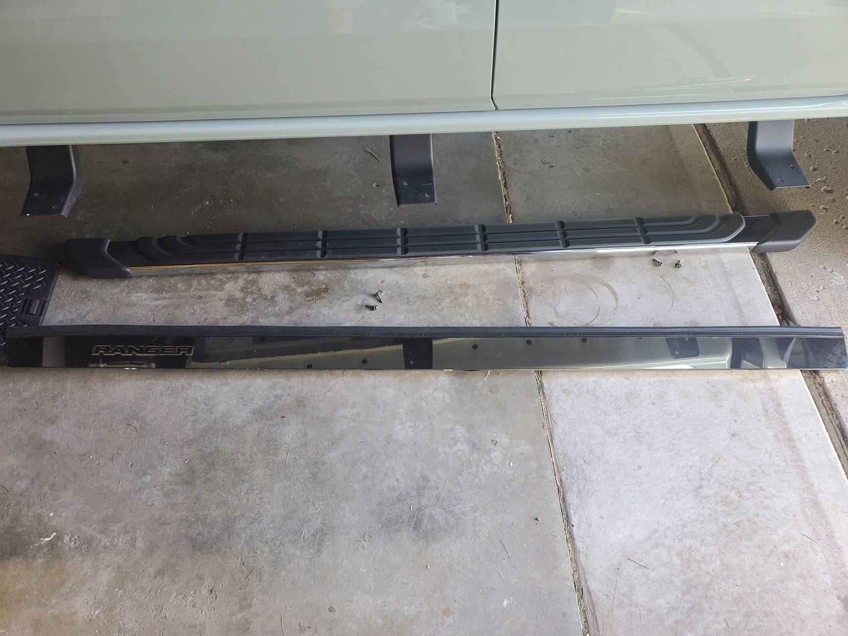

Six bolts a side; I added the stainless-steel filler, but one would only need to remove the brackets to the boards from the body. It was pretty easy.
When you reattach the boards, use Loctite Blue to help keep the bolts in place.

Yes...only the six bolts on each side. My pic was just an example of my application with the filler, but you would just take off the brackets from the body unless it was easier to store them separately. Not all new Rangers come with running boards, so they have to be installed by the factory in holes that were already in place. Very easy to remove and re-install if wanted.

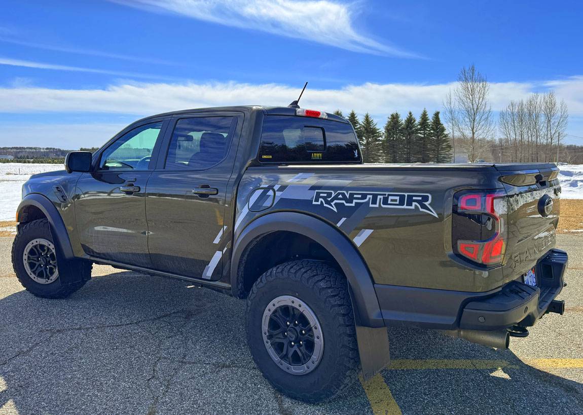

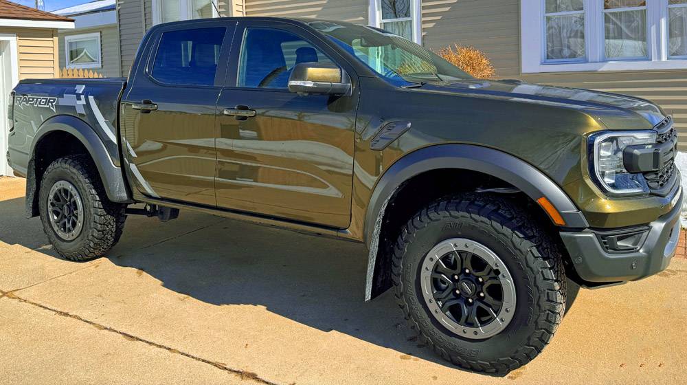

A set of XL RokBlokz will be delivered on Wednesday - boards will be removed during that install.
We get winter bigtime here - near 150" this year. The boards hold frozen salty slop next to the body, sit too high, don't want to trust that icy platform on entry/exit. I'm going to remove them - if they are missed - they can be put back.

I've already tested it out running the two-tracks - less slop up the side of the truck then before the flaps were installed and the running boards on. Bottom line is - I like it, plan on having fun with this truck and it will have evidence of this.
As far as the boards are concerned - not for sale - have them tucked away.
Edit -- going on 200" of snow this year and the heaviest snows come after spring arrives.
