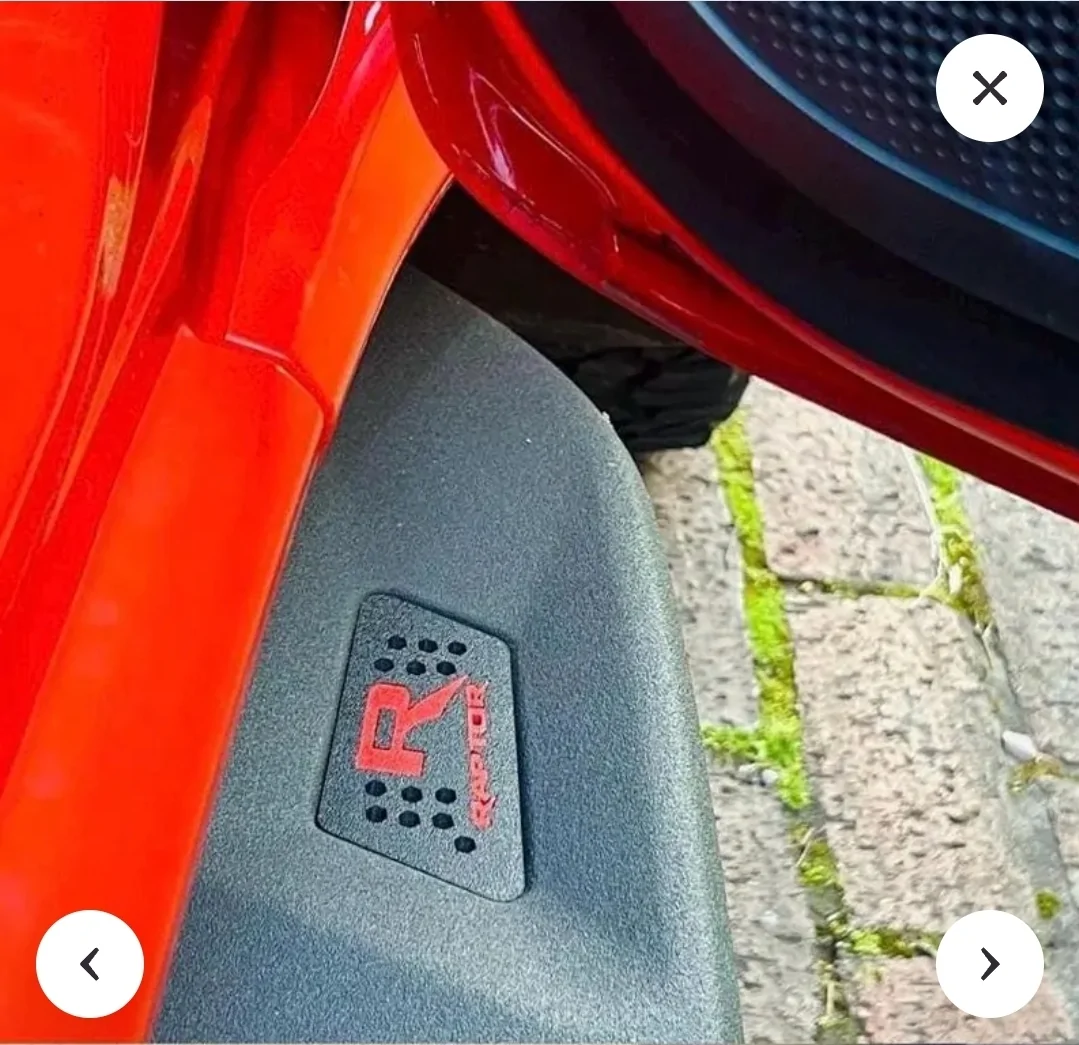

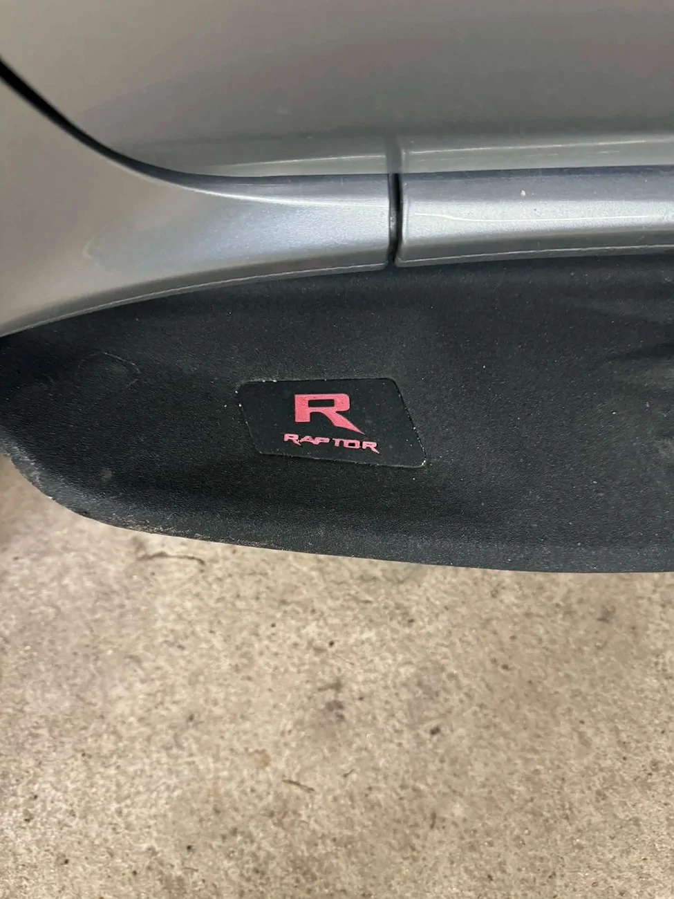

Not my photo but.....

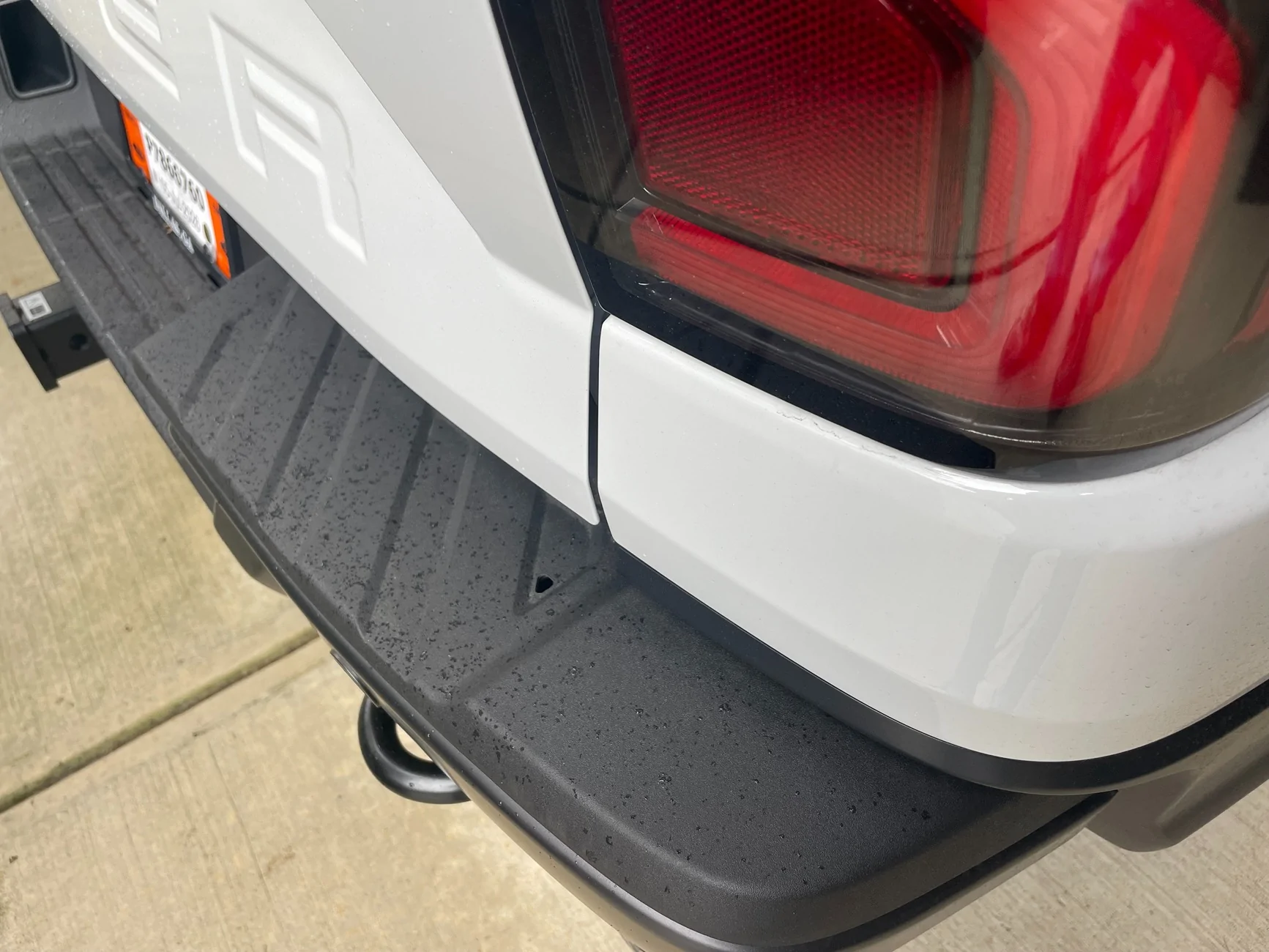

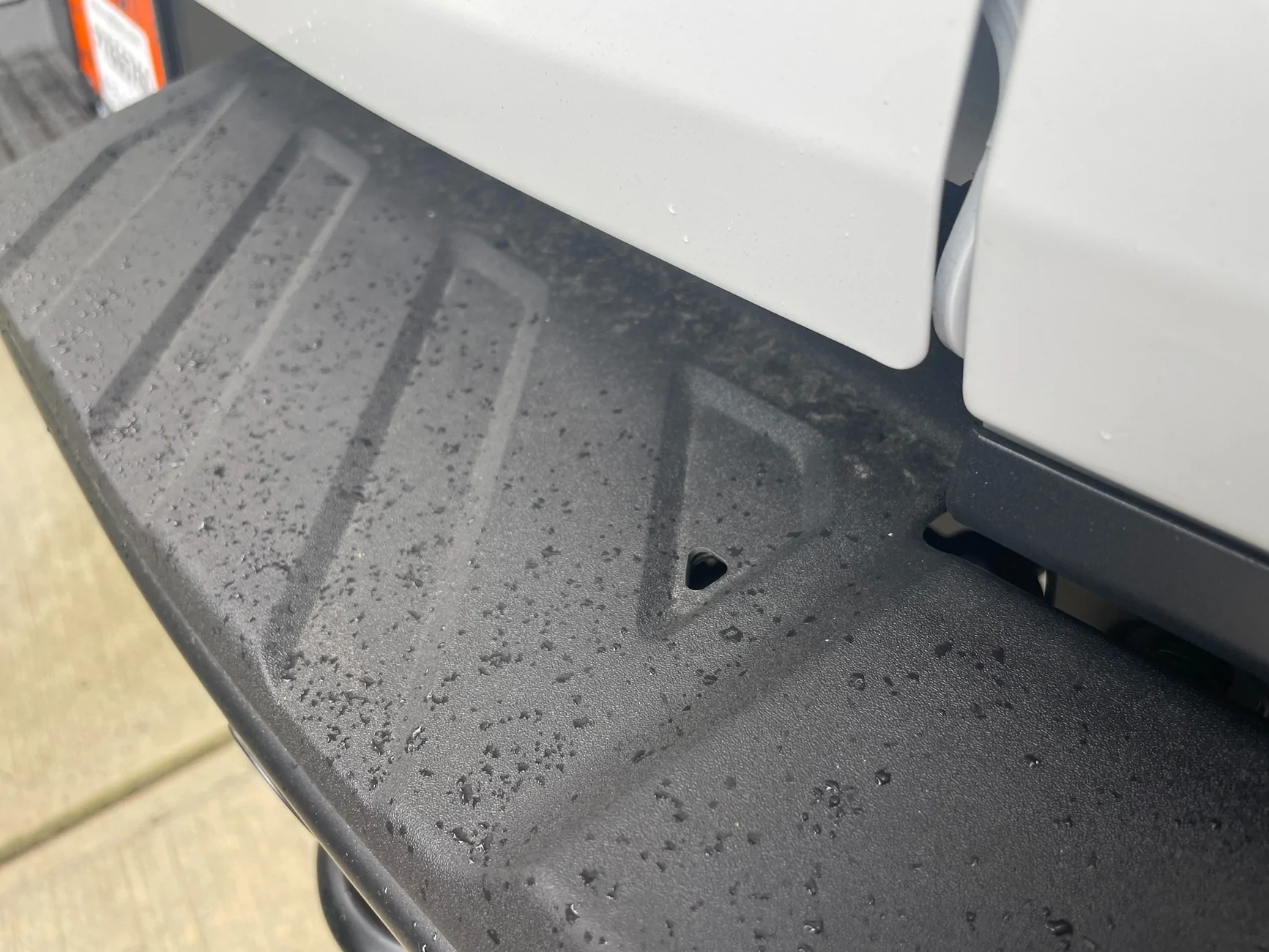

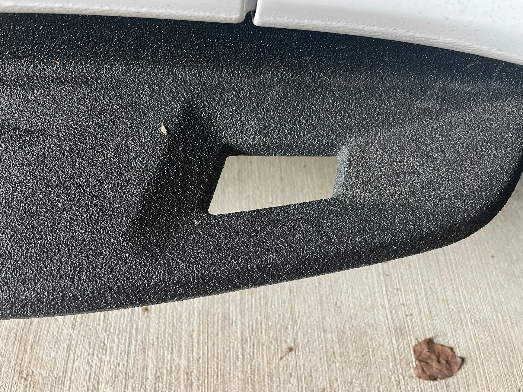

Okay... thanks for the clarification.
Here is what I was talking about with the triangular openings:
I have NO idea what these openings are for...!!!!
The opening in the front of the running board is not really triangular which is why I was confused... thanks for the clarification & photo.
It does look a bit plain and the photo you showed is an interesting mod.
Like my Bronco, the mods NEVER seem to end.... what a beautiful problem!

I assume the triangles on the rear bumper are drain holes.

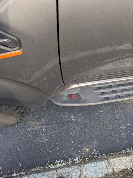

I think the hole is there to let mud splatter up onto the truck and make it look cool?? Anyway, I added these:

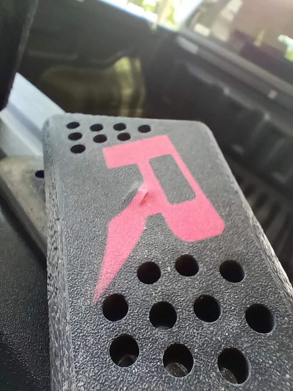

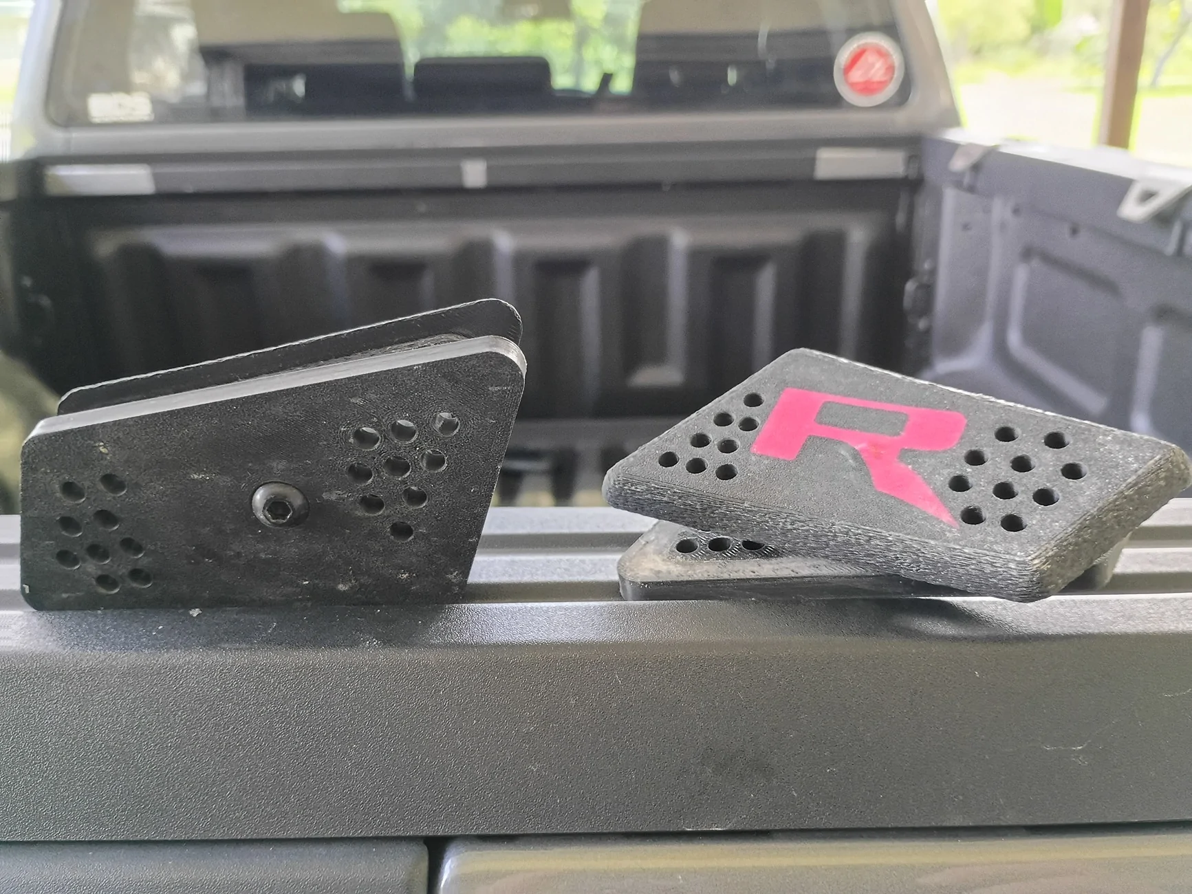

i have some but they don't exactly fit into the hole. they sit more on the edges above it so they collect stuff around their edges now. i keep saying i am going to take them off but that requires laying under there and unscrewing them and that hasn't happened yet.

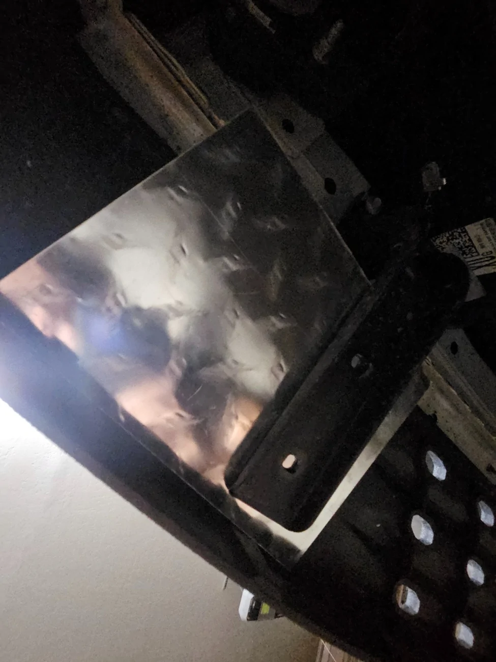

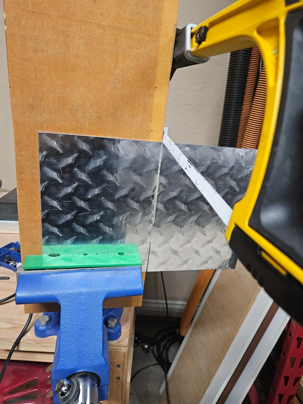

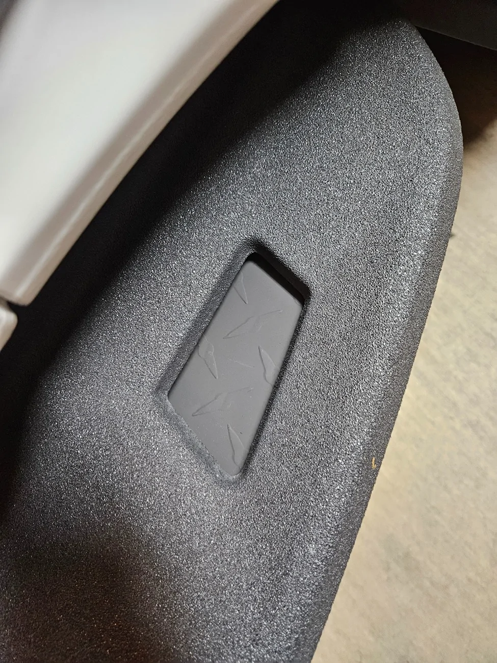

$6 option thanks to another member who posted elsewhere. 12x8x1.5mm aluminum plate cut in half and attached in between the brace & running board. I was even too lazy to run to use my buddy's chop saw, but I did deburr with a Dremel. Used high temp black spray I had on deck. Might get sand texture or rubber spray if I'm motivated later.

This thread coming to the top reminded me to take mine off. And luckily it did because the passenger side was completely loose. The bolt had pushed up through the the top piece so I apparently over tightened them when installing
Either way, they are off now
