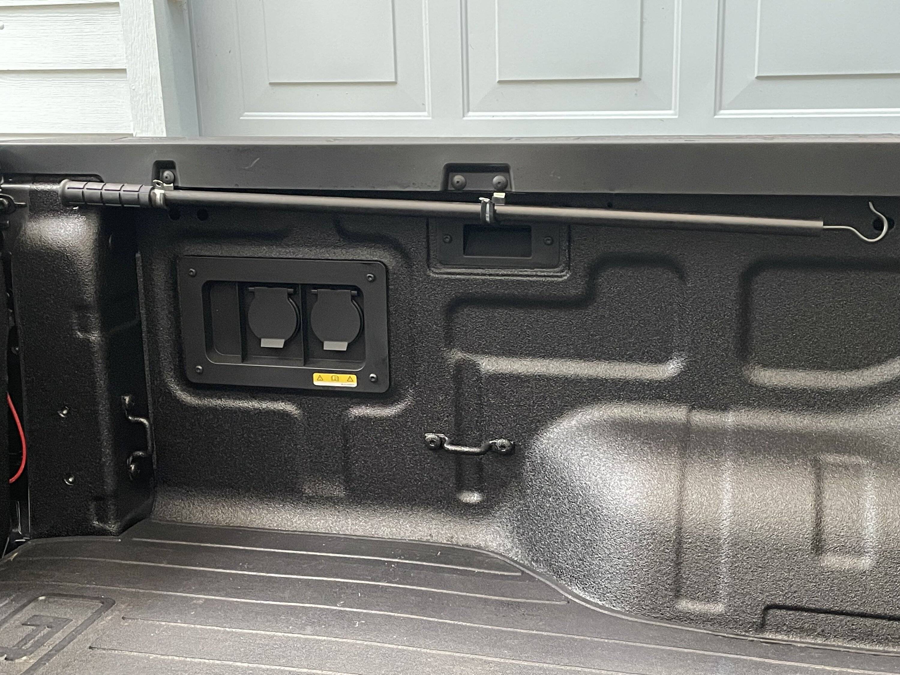

I made a new one for my RANGER. 36” black plastic 3/4” rod from Amazon ($14), bike handle bar grip, Amazon ($8 pr) , black hook LOWES ($7.50) held on with a couple insulated aluminum cable clamps off the shelf. I may have to move it when I get my bedcover.
Ford Ranger My Cargo hook DIY IMG_5322
Ford Ranger My Cargo hook DIY IMG_5321

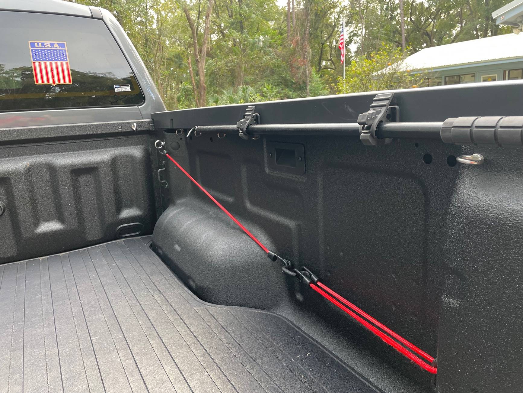

Cool, but those aluminum Adel clamps are not nearly strong enough to support the weight, tho they are fine when fully closed. This sort or mount would work a lot better, and your tool won’t bounce out when you hit your first speed bump.
Ford Ranger My Cargo hook DIY IMG_6994

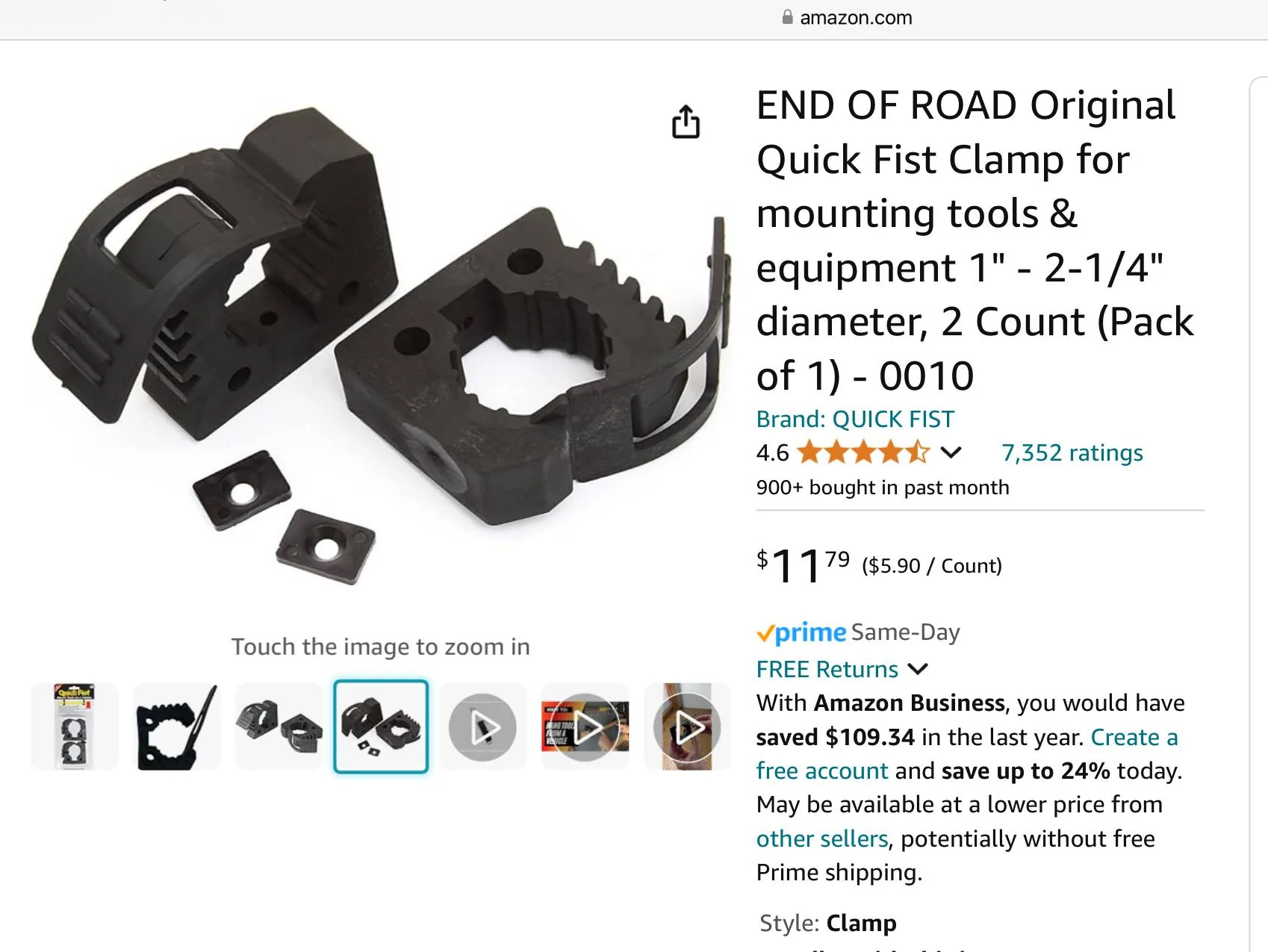

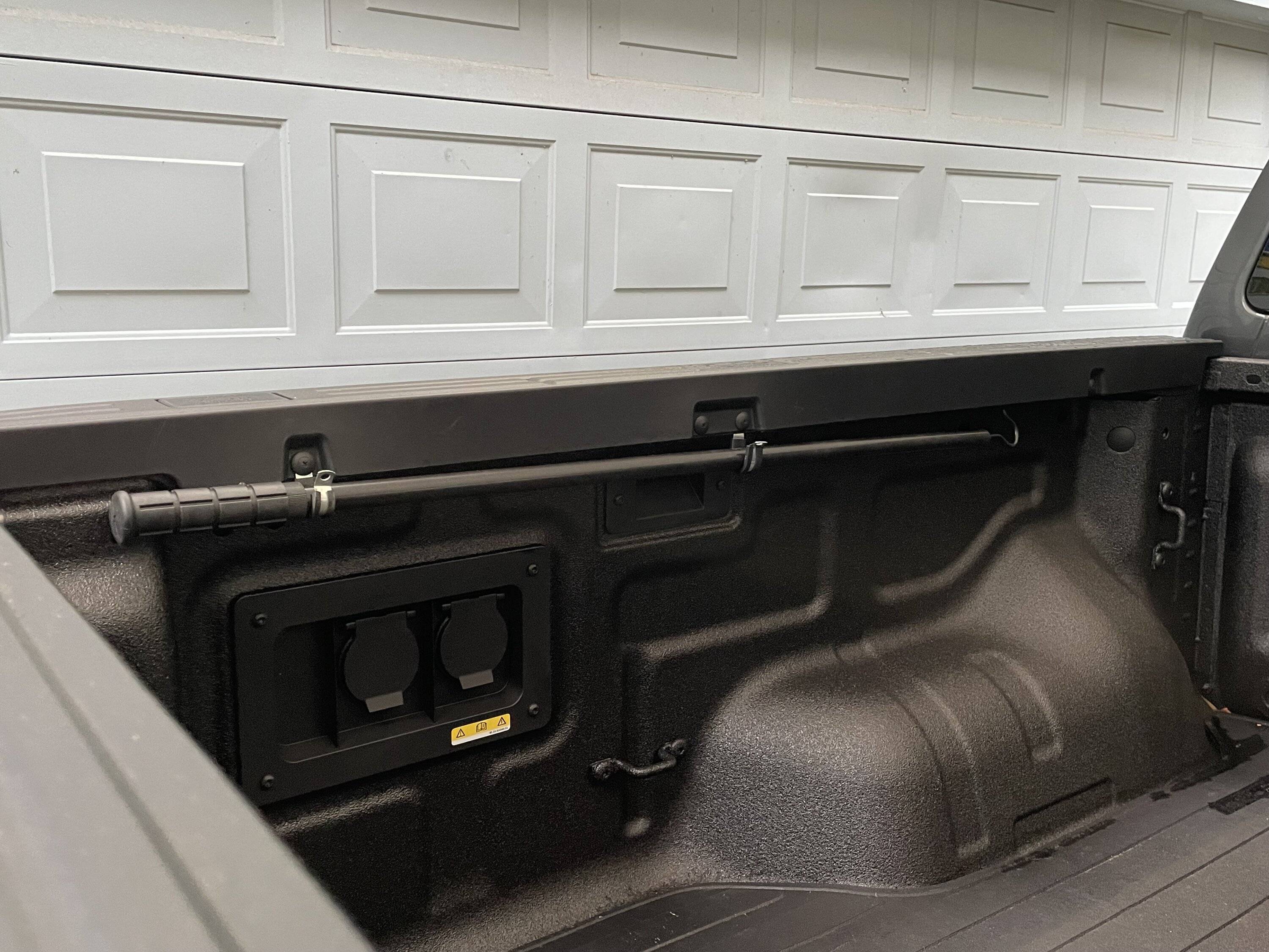

So, thanks for the idea, mini quick fists secured where the scrivets were. 1/4 x 20 bolt, through the fists, through the plastic cap and metal bed rail secured by a washer and nut. ( although it’s been around 6 weeks and the rod never popped out of the original aluminum clamps.
Ford Ranger My Cargo hook DIY IMG_5531
