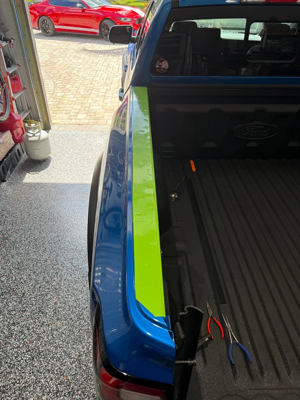

Rather than your roadrunner, coyote manhole covers (I liked that), I just laid a strip of vinyl over the entire surface under the rails. Then the clips penetrate and you can use butyl or silicone to seal them. You went much further than I did, I also did a seal kit for the tailgate but I still get water intrusion. We're all going crazy fixing fords F-up.

Sorry I guess it did not quote like I asked. In this pic the tailgate seat was that diy or was it a kit. I use the diamondback bed cover and love it but my main source of dust and water are from tailgate.
Not a kit, I did it from scratch. Seals well. Details earlier in this thread.
