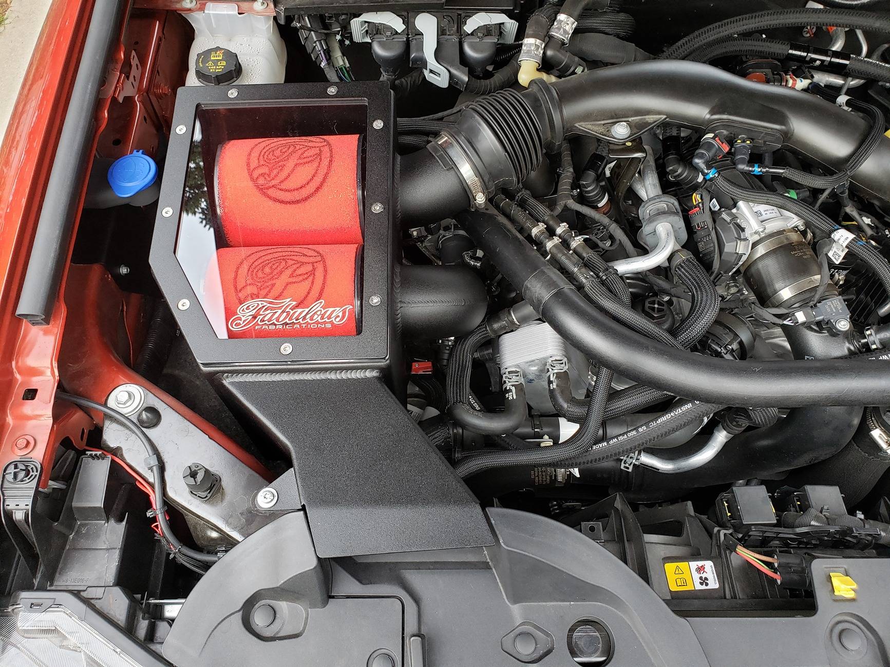

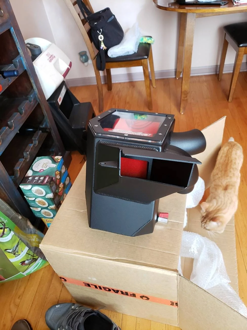

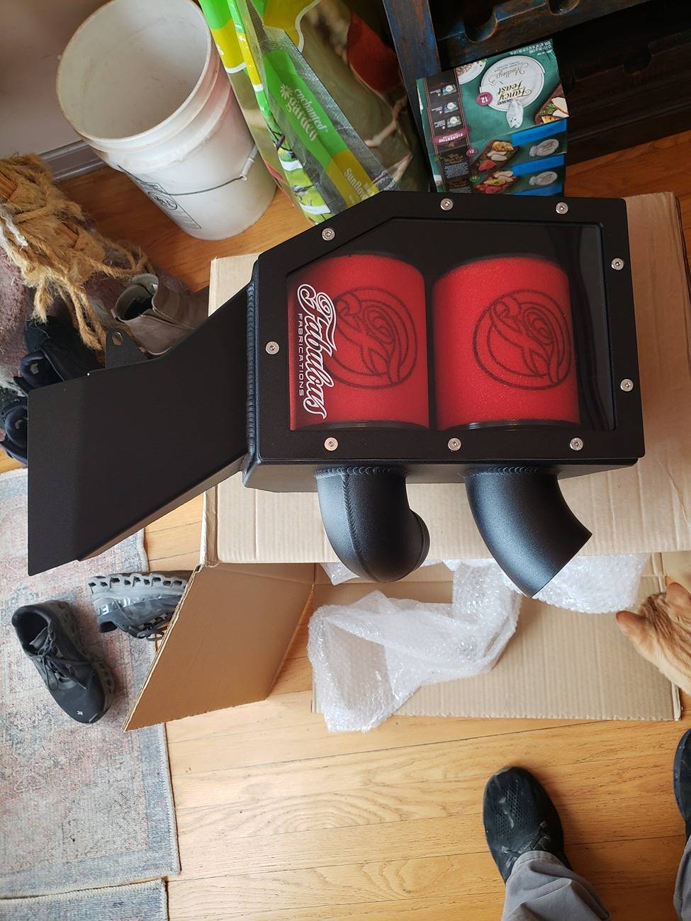

Excited to see the difference in performance and drive ability
Ford Ranger New air intake (Fabulous Fabrications installed in Ranger Raptor - photos & impressions 20240927_173714
Ford Ranger New air intake (Fabulous Fabrications installed in Ranger Raptor - photos & impressions 20240927_173700
Just finished the install took me roughly 45 minutes. This is a work of art very impressed with it I've had many cold air intakes over the years this is by far the best. Time for a test drive
Just came back from a drive feels like it pulls harder especially in the upper rpms. I'm happy with it and impressed with the build quality. This intake is gonna shine with a custom zfg racing tune in the future.
