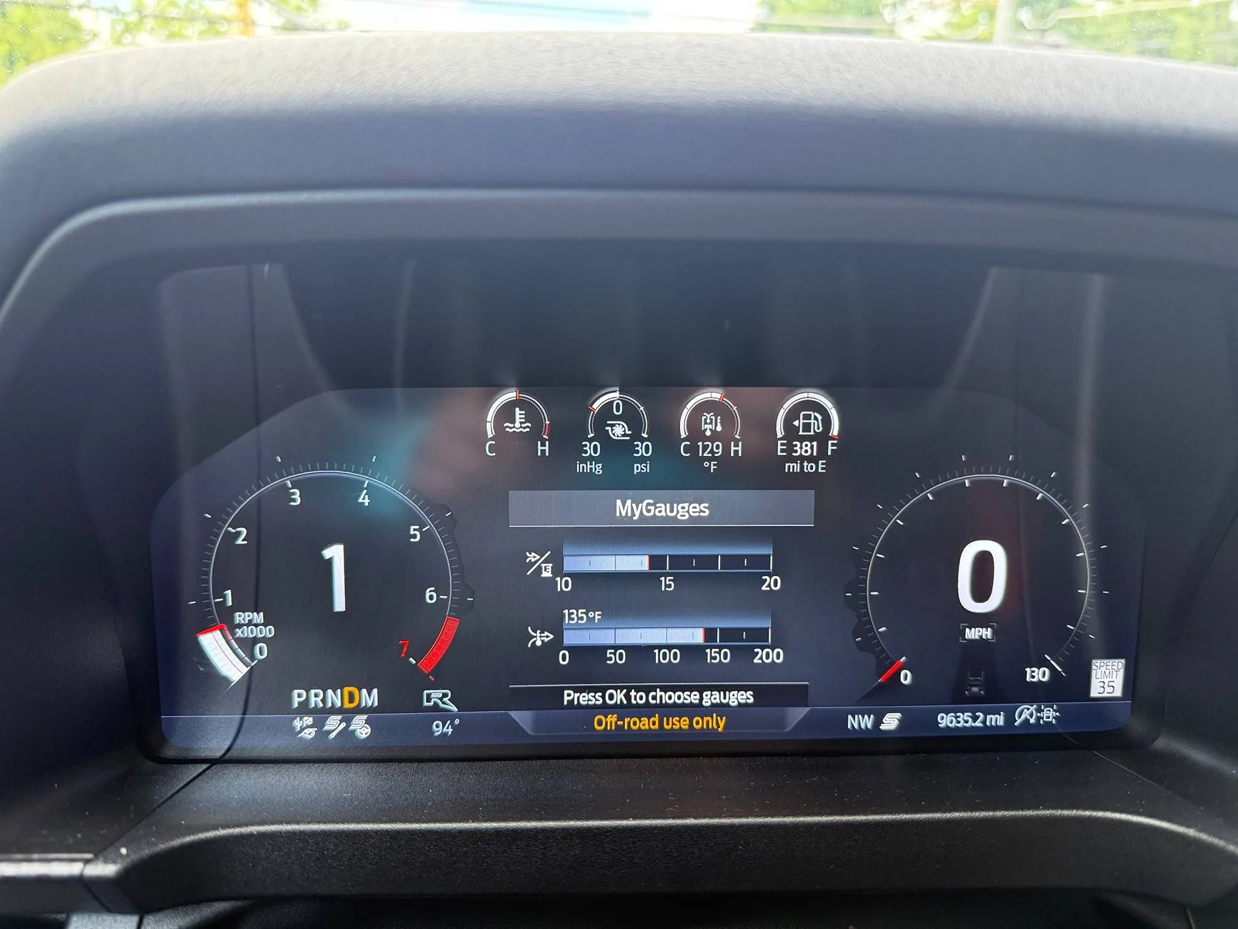

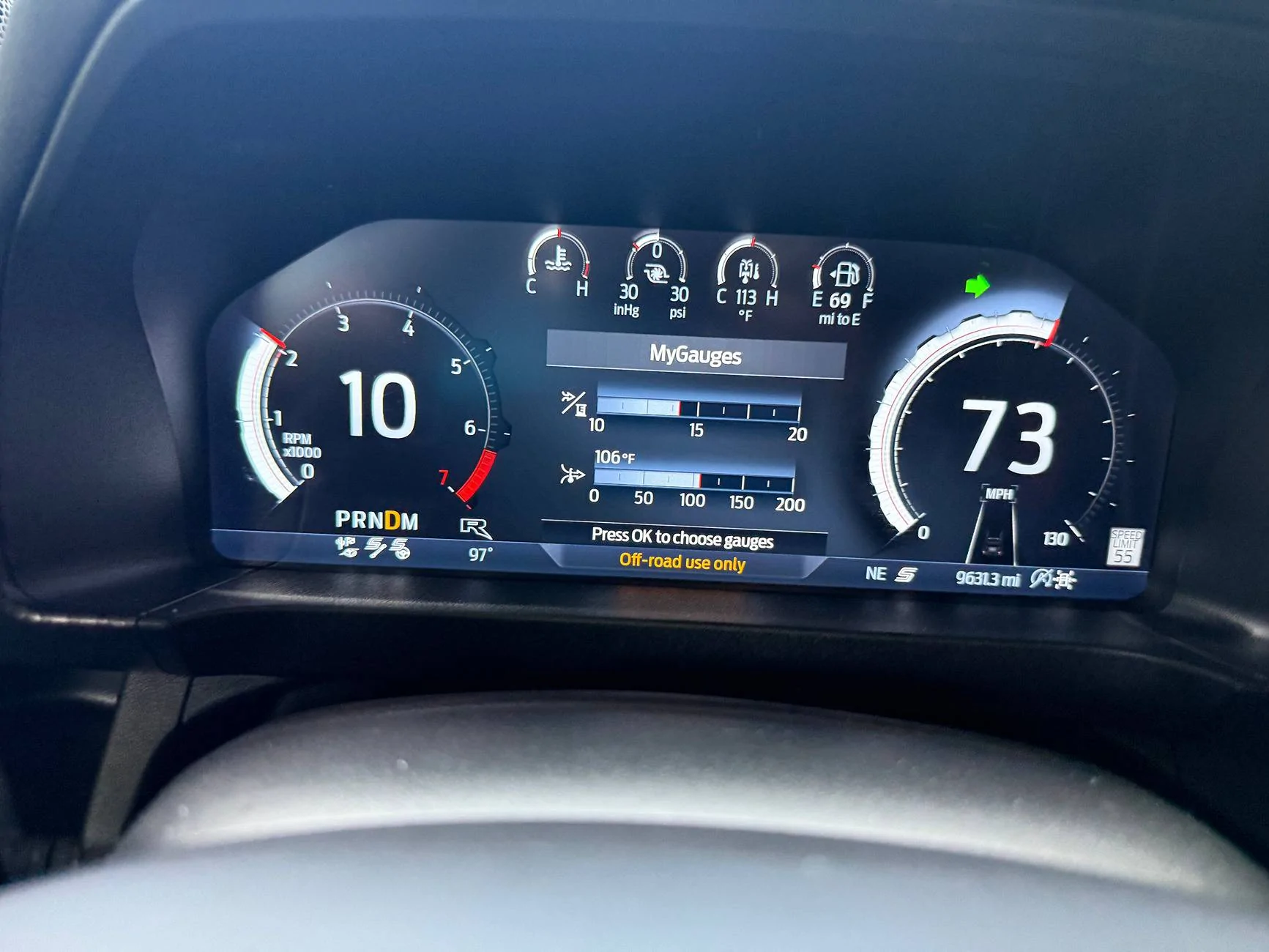

Figured I'd post an update with some data after about 300 miles with the K&N. My commute is about 75% highway/25% City. I am averaging 18.8mpg.
-Northern VA, 96 degree outside temperature.
-93 octane fuel, FP Tune, K&N CAI, Ford Roll-up bed cover
-Sport mode, Baja mode exhaust
I did not look at the temps when I had the stock airbox. Just wanted to share my experience with the K&N intake since I have gotten so much from all of you guys on here. Hope this is helpful to some of you.
First pic is during my drive on the highway about an hour of driving: 106 Intake air temp
Ford Ranger Ranger Raptor K&N Cold Air Intake being released +27HP IMG_7072
Second pic: Heat soaked engine after an hour on the highway, sitting idle for about 5 min while I pumped gas... yes I left the truck running: 135 Intake Air Temp
Ford Ranger Ranger Raptor K&N Cold Air Intake being released +27HP IMG_7075
