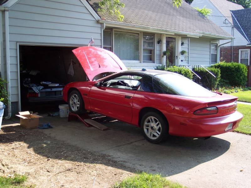

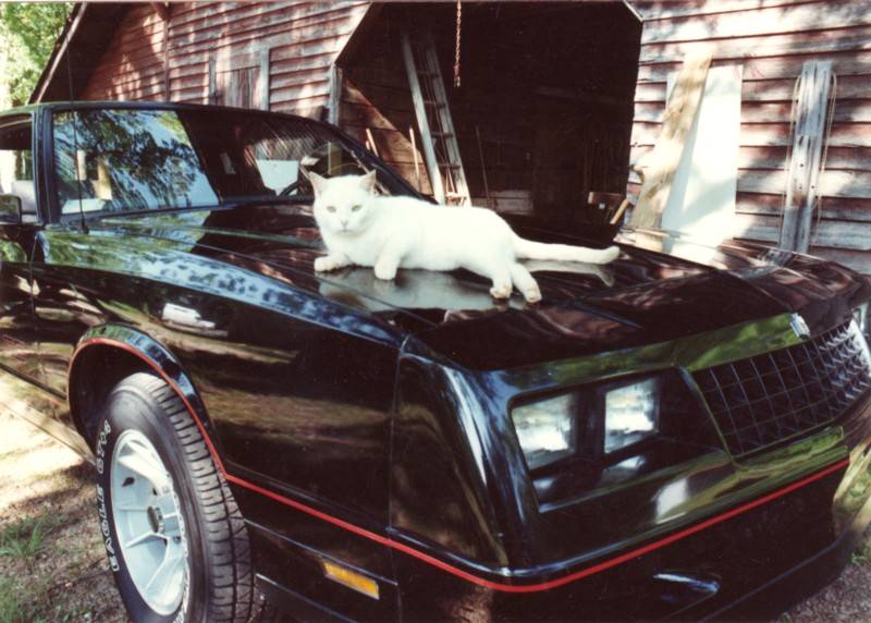

I am an automotive tech 35 years . I ran an OEM filter on my Monte SS and a oil fed filter my Z 28. Driving each vehicle close to equal mileage in a span over 10 years even though the Camaro was a couple of years newer with oil changes every 3K. Even with proper air filter element cleaning and re oiling the oil in the Z-28 the oil just didn't stand up as far as cleanliness was concerned compared to the Monte SS . Lesson here the oil feed filter just passes too much contaminants dirt. There are just as many reviews and articles written that verify my results. As an automotive enthusiasts like the rest of us on here I can assure you I've owned over 30 vehicles from corvettes to Porsches and I can tell you that 27 horsepower claim is quite a stretch just from an air filter replacement . There are also catalytic converter problems due to excess debris going through your intake system and exiting through your exhaust this happens over a longer period of time .These are not older farm vehicles there are MAP sensors MAF sensors O2 sensors and valves that control cam phases that can clog . A word to the wise If you happen to forget to take you oil fed filter at a Ford Dealership while in service they will void your warranty however according to a major manufacturer that produces these filters they say it won't void the warranty don't listen to that if you go into a dealer and see it they will void it. I'm glad that you had success with them but my experience is throughout my 40 years I see different results so we agree to disagree.

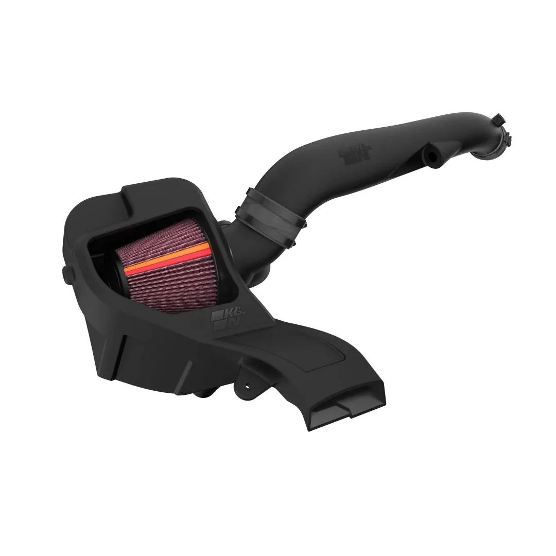

What leads you to believe that this intake introduces more hot air to the engine intake than the factory system?
The fact that the air box has a huge opening on the top and the fact that the air box resides in the engine compartment.

The hood closes against that genius…
It doesn't take a genius to see that the hood does not close against the opening on this particular CAI. CAI systems that seal against the hood have a compression seal around the opening.
