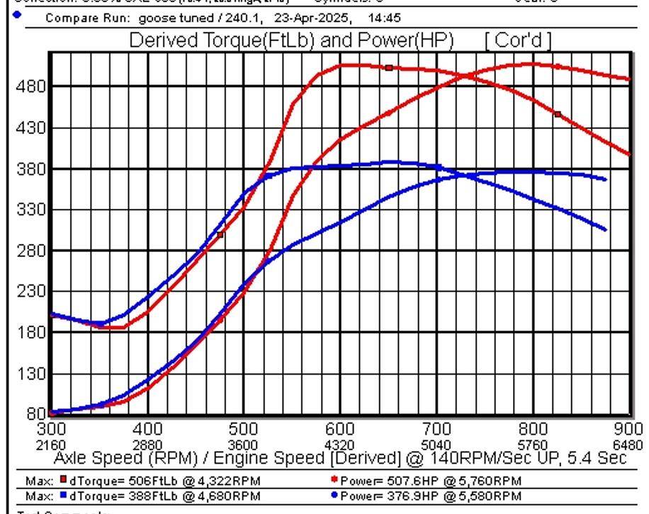

Several months ago I acquired my own Development 3.0 Raptor to test on. I've since been tweaking/tuning/modifying things in order to see for myself what needs to be done. This is something I have always done with all of my vehicles, and what sets us apart from most who do not test on their own vehicles. I'm testing everyday, tweaking everyday, gathering data and analyzing it.
Currently, my Raptor 3.0 sits at 507whp 506ftlbs of torque, on E40 fuel, with an intercooler only, on 37s.
I plan to get this on E85 with a fuel system, and MAYBE bigger turbos. This truck is already a handful offroad making this much more power over stock, and I don't want to ruin what it was built for, and how I plan to use it.

5/5/2025 E30 Fuel Update - Found some more power!!
Sitting at 147whp and 167wtq over stock!

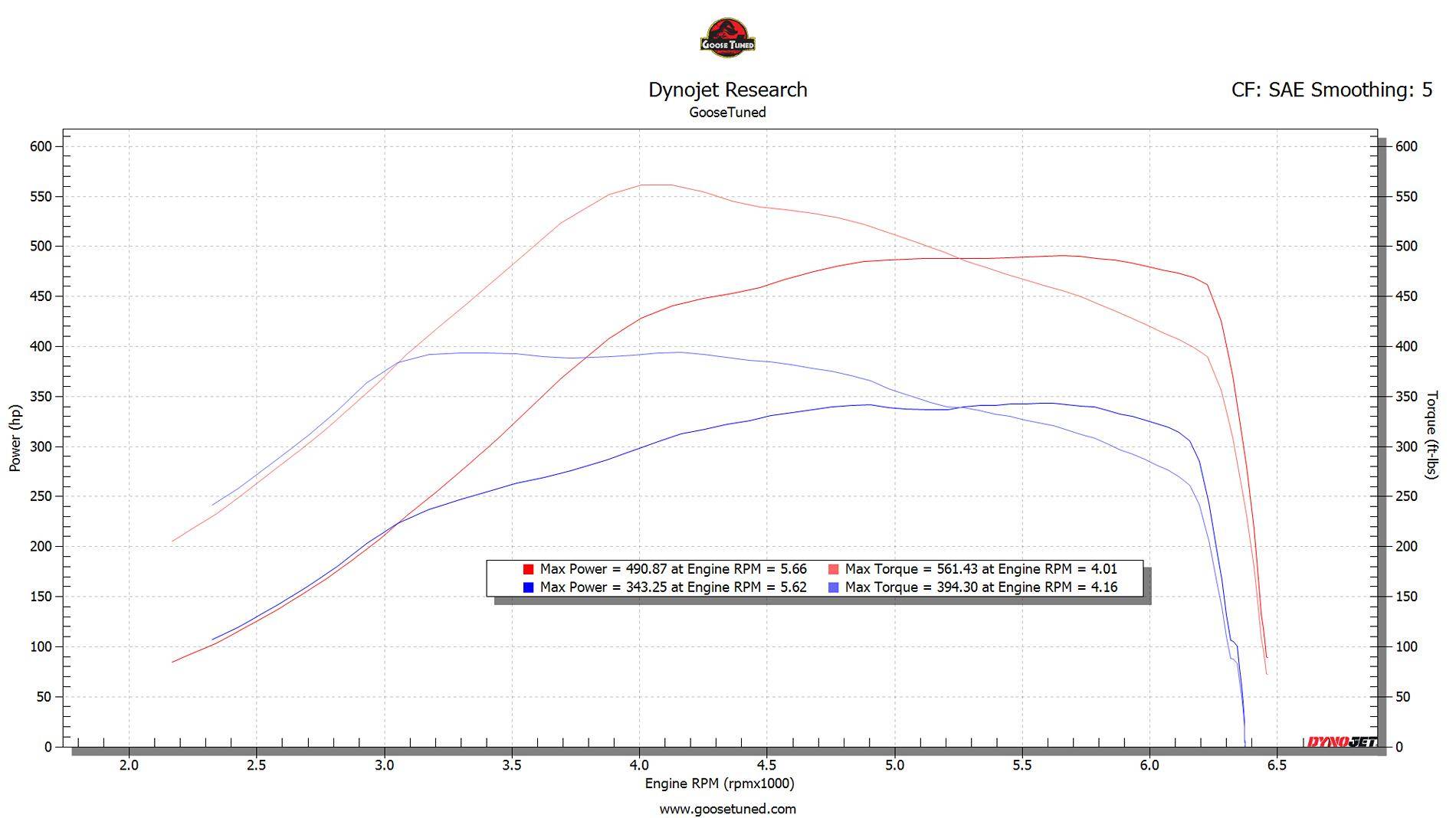

Ford Ranger Goosetuned Tuning Thread - Ranger/Bronco Raptor +147whp and +167wtq! Better shifting! SAE stock vs E30 S2_490 561

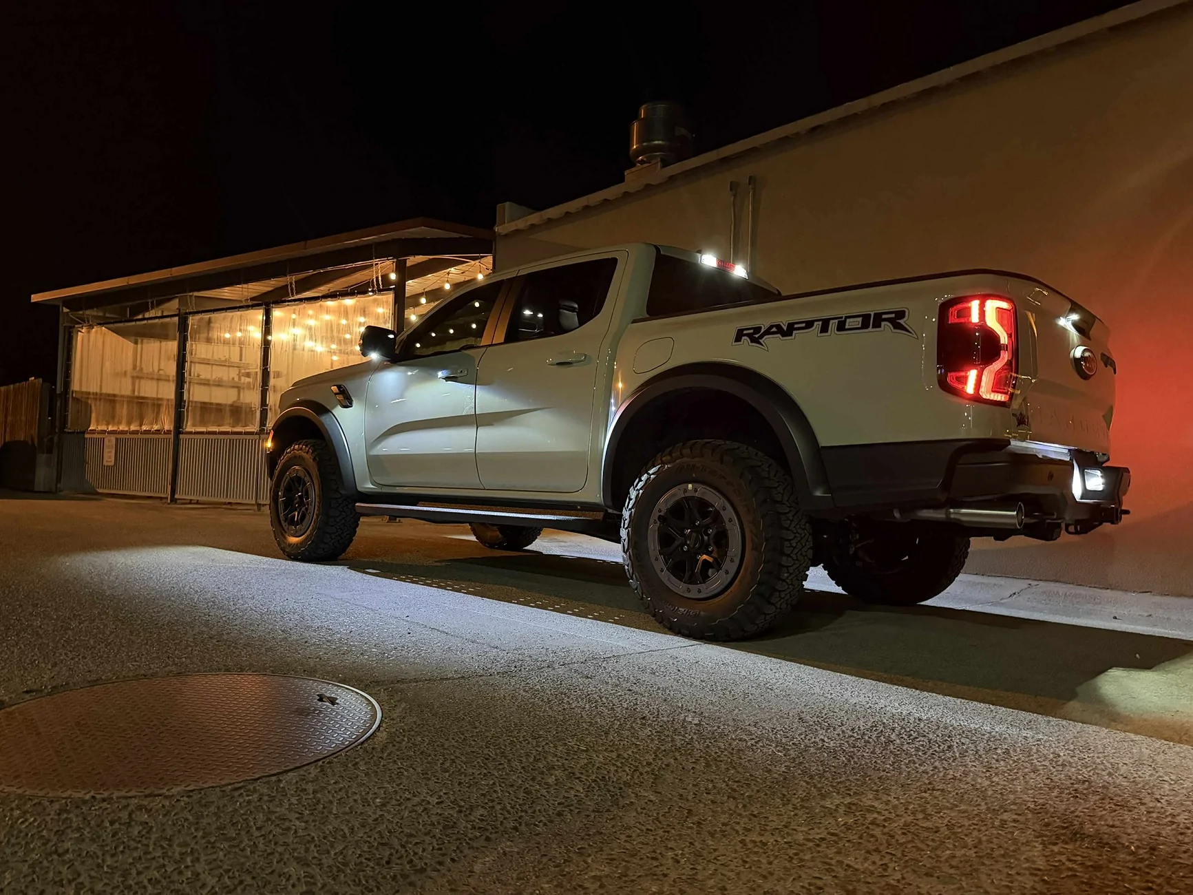

Ranger things :cool:
Video dropping soon!

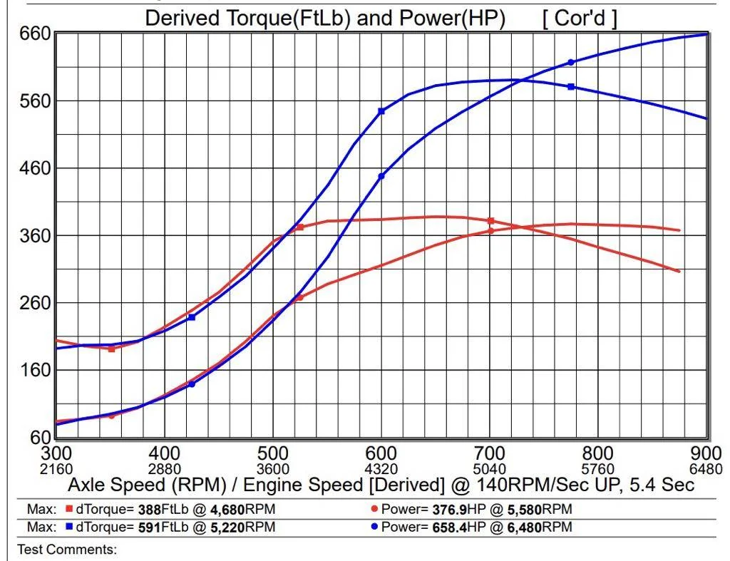

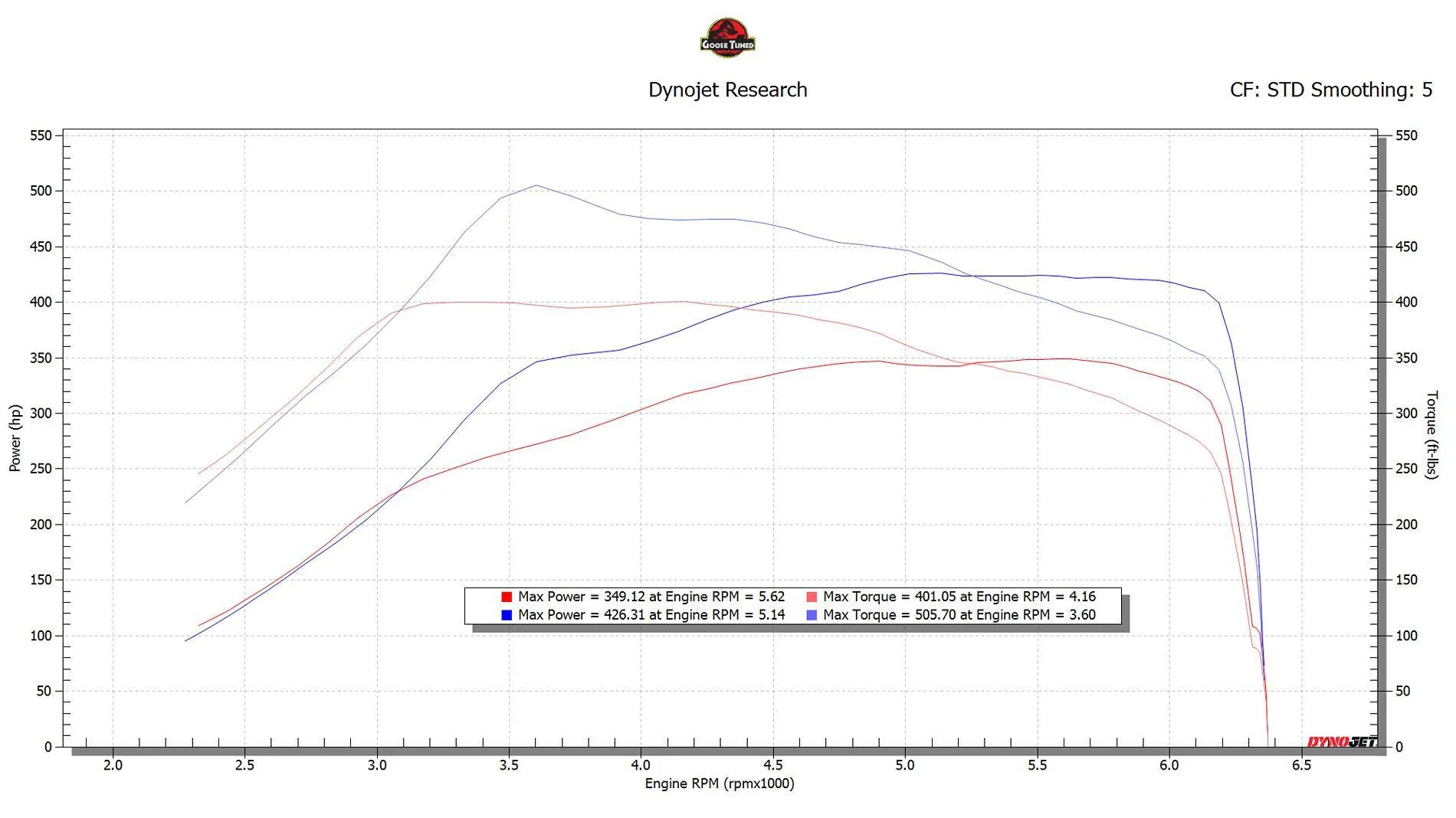

How about on pump gas? + Do you modify or mess with the transmission shift points at all?
I did tune pump, 91ACN (crap 91). It made 426whp 505wtq, which was +77whp +104wtq.
Ford Ranger Goosetuned Tuning Thread - Ranger/Bronco Raptor +147whp and +167wtq! Better shifting! stock vs 91 100% stock truck

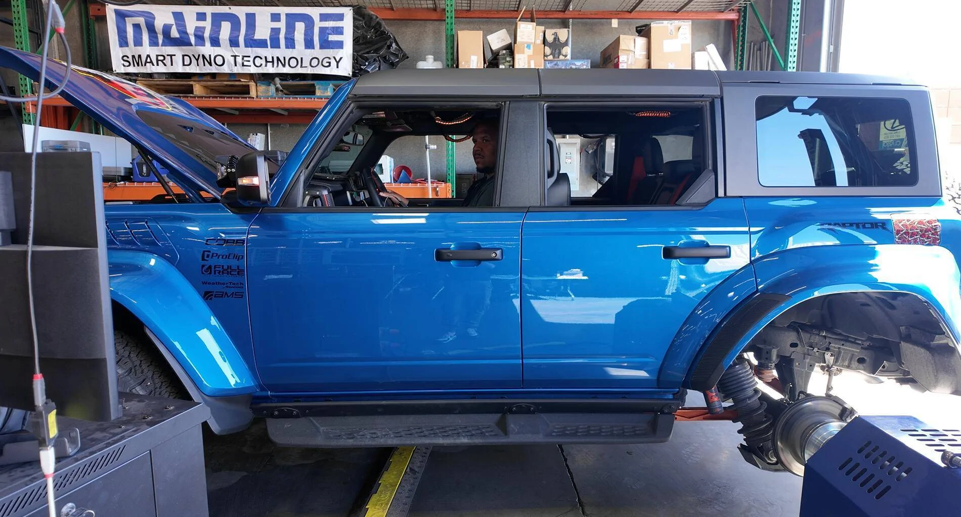

A little Bronco Raptor update!
