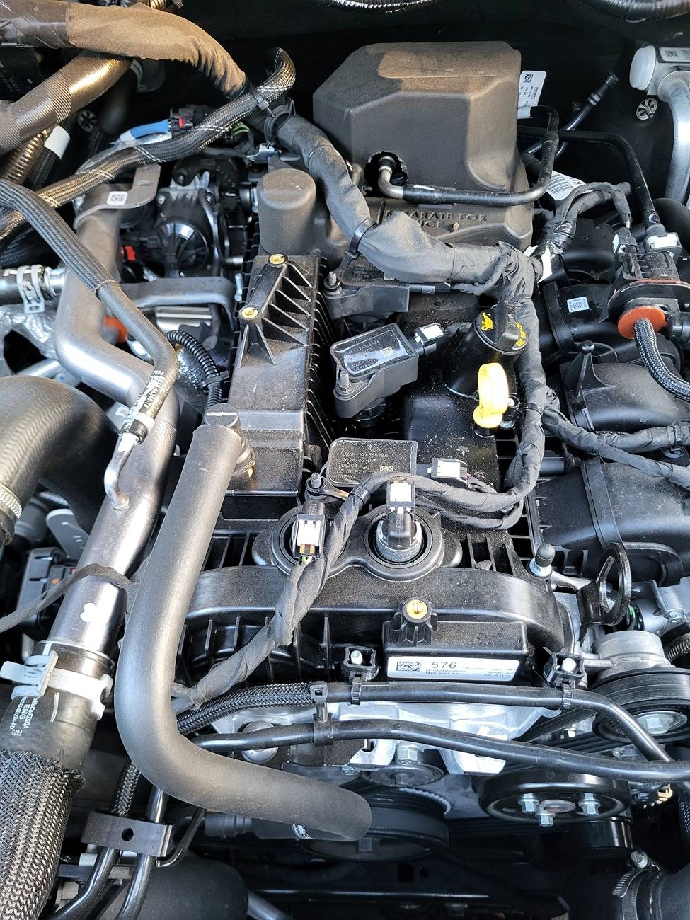

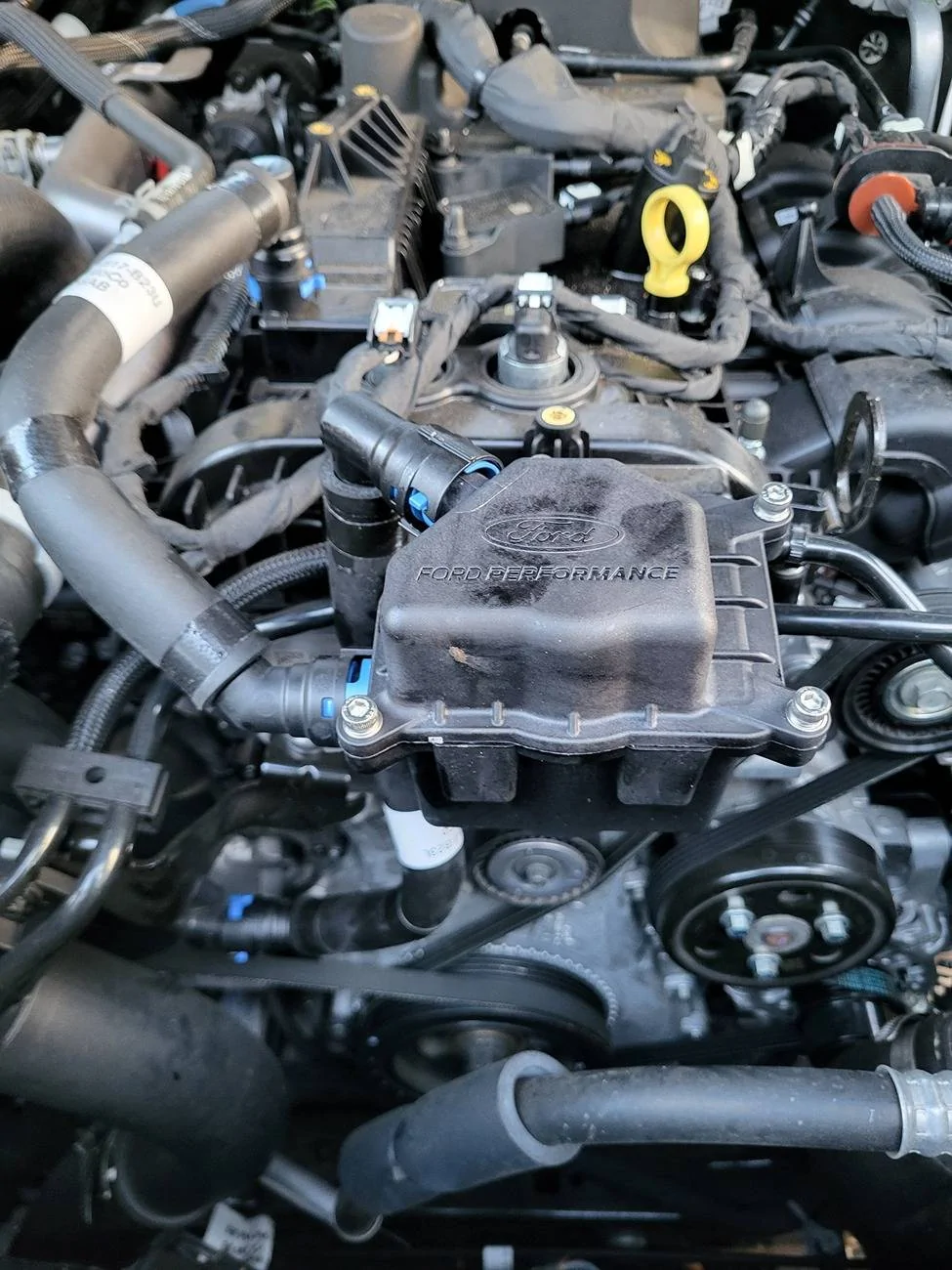

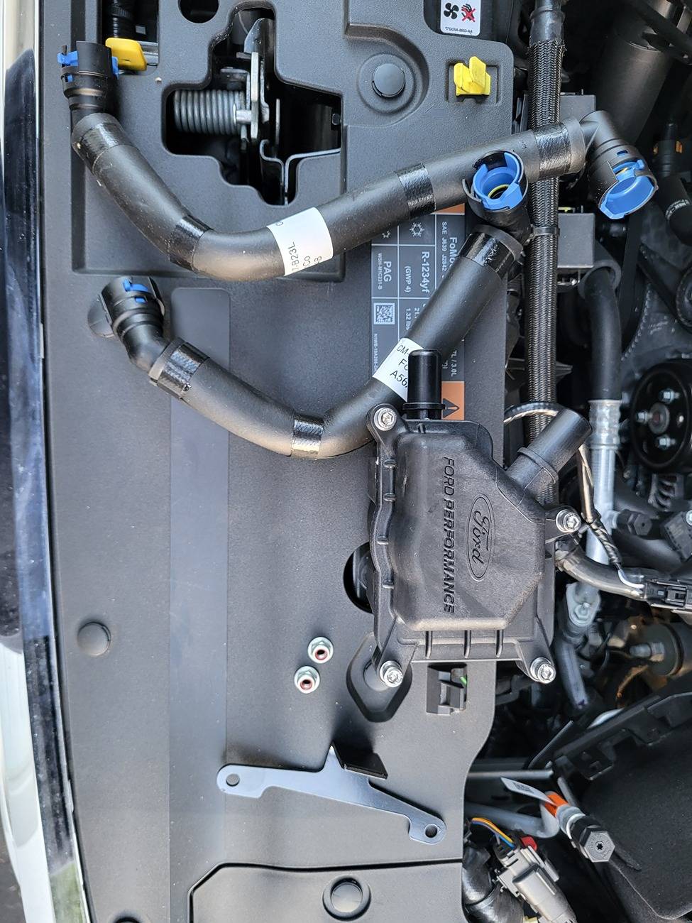

Ordered the oil separator from ford part number M-6766-B23. This is for 2024 ranger 2.3L. Simple as it can get to put in 5 minutes to get it done.
Ford Ranger 2.3 ford performance oil separator 20241227_154928
Ford Ranger 2.3 ford performance oil separator 20241227_160911

Ford Ranger 2.3 ford performance oil separator 20241227_155036

I got one to. I live in Ontario Canada. Cold climate. It does catch alot of junk, but not as much as I expected.
I live in Ontario as well. Is there any concern of the separated moisture freezing and impeding the PCV system? How often do you have to empty it?
greaserman
Eric
Aug 10, 2024
84
Alliston, Ontario, Canada
2024 Ford Ranger XLT
Machinist
I check it every 2 weeks. It might be about 1/4 full in 2 weeks, usually less. I haven't noticed any concerns about freezing yet. But thus is my first winter with this truck.
