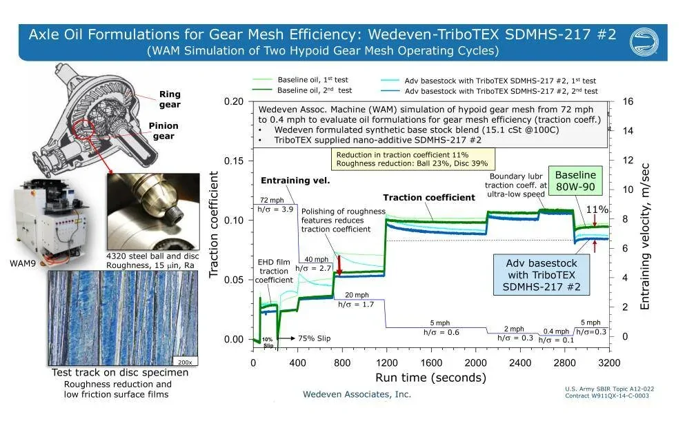

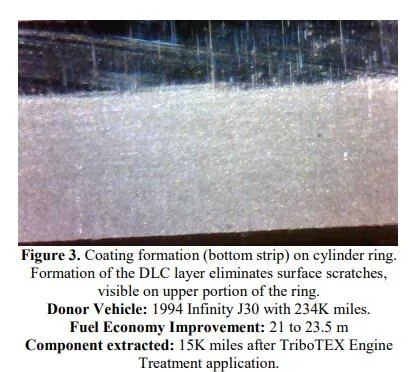

And this is why my preferred method is to mitigate vaporization rather than to deal with the symptoms of it. Take a look at In Situ DLC coatings and how they form on piston rings in this thread:
Informational - Science / History Behind In Situ DLC Coatings for ICE and Transmission / Gearbox Applications | Ranger6G - 2024+ Ranger & Raptor Forum, News, Owners, Community (6th Gen)
Ford Ranger Ford Performance Air Oil Separator for Ranger Raptor 3.0L now available - experience / review? 1773833435322-n5
Last oil change I ran out to 9k miles, I did an OHV park, I did Baja in farm field with full passengers for 45 minutes, towed a car, regularly flog it (after all fluids are up to operating temp including the transmission) etc. The oil level was still at the top dot where I filled it 9,000 miles before (now to be sure there's always some small vaporization and fuel dilution in TGDI engines, but if it's minimized the impact is generally negligible).
I run DLC films in my little Mazda 3 Carbon also, just a 2.5L NA engine, but the last OCI by Black Stone labs said my oil at 9k miles on that car was in the same condition as the average oil of similar vehicles at 6k miles. That's 50% greater service life of the oil. Normally for that engine they recommend changing around 5k-6k when I did over 9k.
Why? DLC films reduce the usage rate of additive packages in oil by optimizing oil adhesion to bearing surfaces / piston rings / cylinder walls after film formation, it also promotes better ring seal on the cylinder walls. Wear is predominantly occurring on the film once formed (which over time wears back down). All of this reduces the oil vaporization (less friction losses at the points of contact between rubbing pairs) and usage rates to negligible levels, largely negating the need for air to oil separators.
If there's minimal oil vaporization, there's no need for a separator. Based on the evidence, this is a far superior way to deal with oil vaporization, treat the root cause, not the symptom. I use it on the entire powertrain to mitigate wear at the points of highest risk (forms via heat and pressure mechanically, so it only forms at locations of wear).
DLC films are not new. Manufacturers have been using DLC films on various parts for decades, like valve stems. The problem with factory applied DLC films is that once they wear off, you would have to take the part out of the vehicle and replace it / re-finish it, completely impractical! This tech is a self-forming DLC film, that's what makes it so useful.
