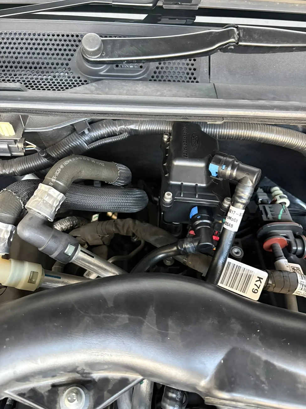

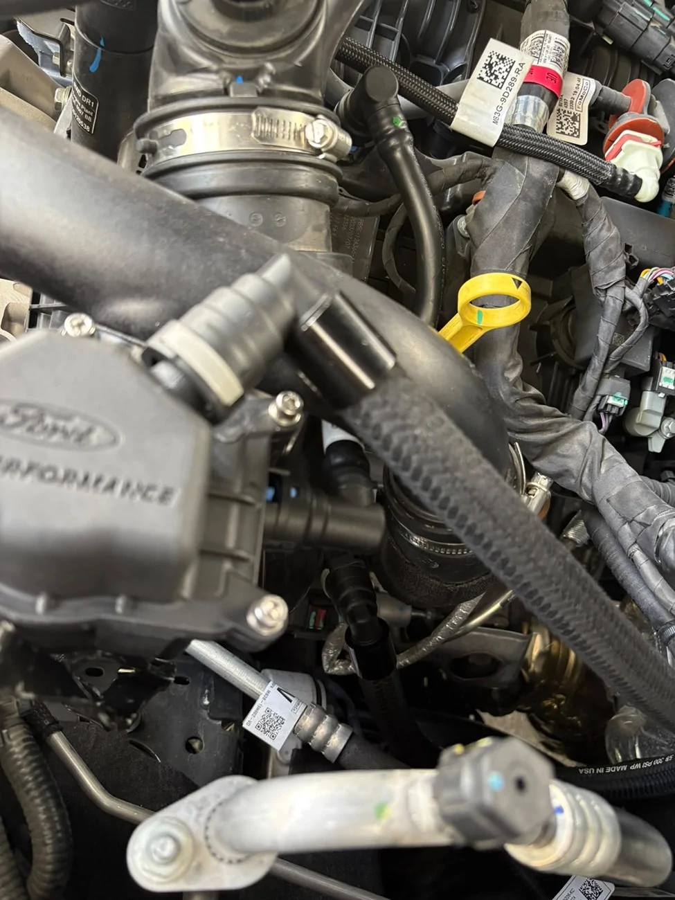

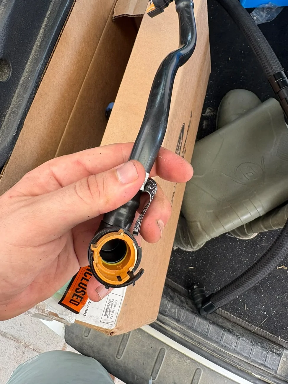

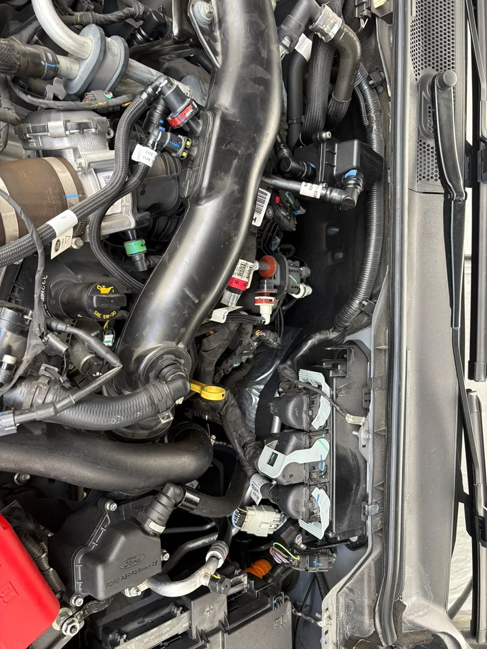

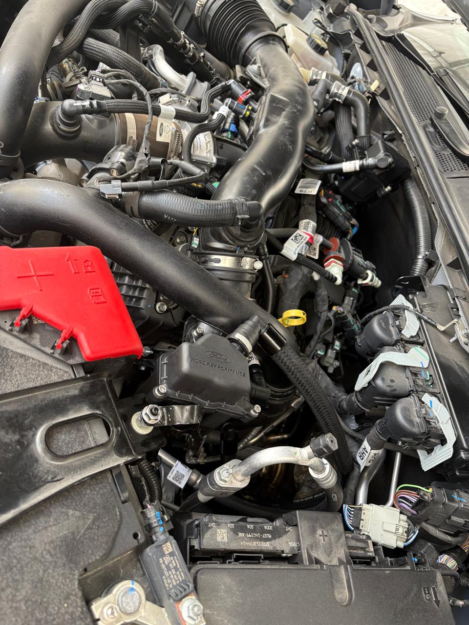

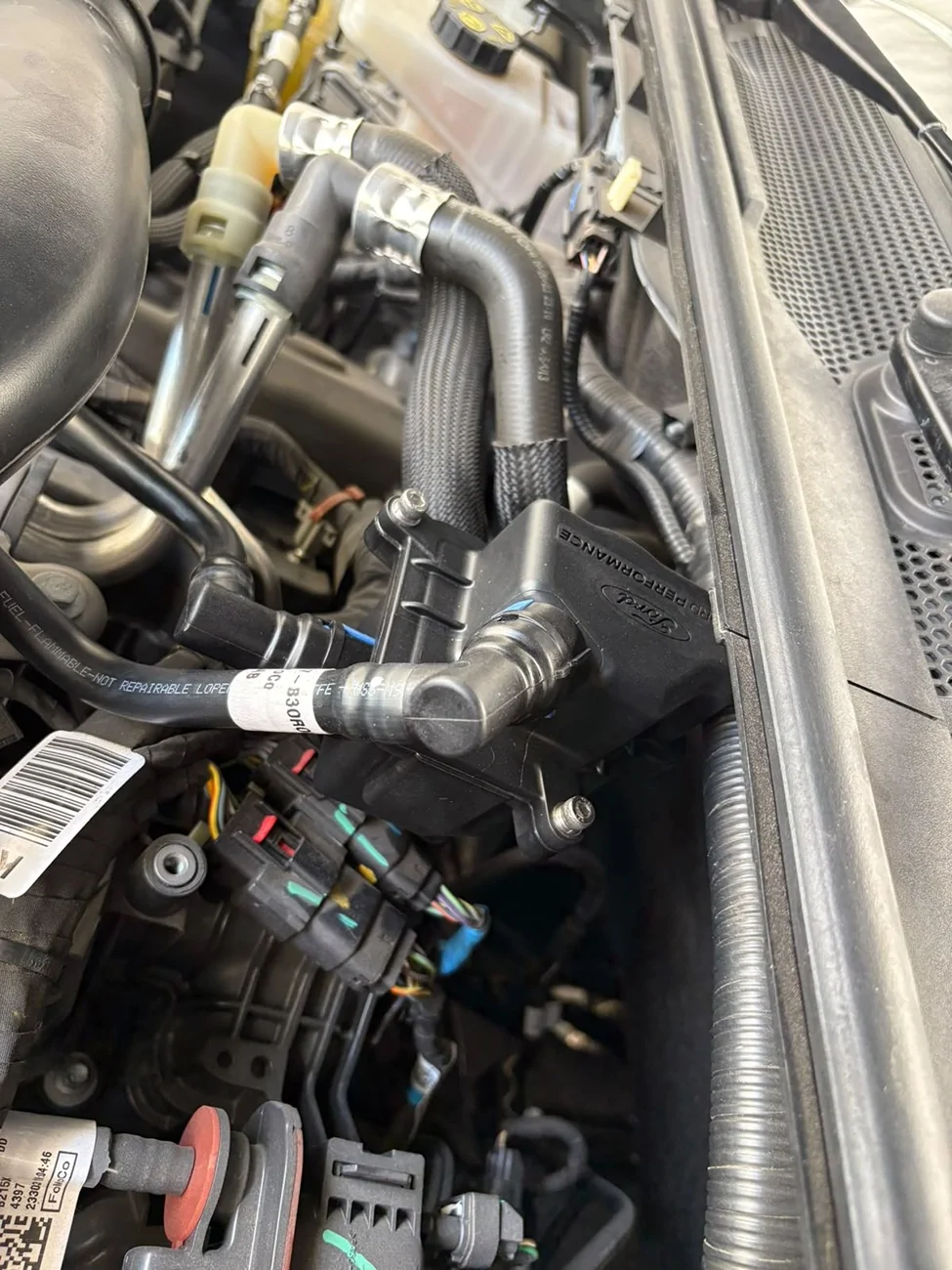

This is just a heads up to anyone with a right hand drive ranger raptor planning to buy the ford performance oil catch can. One of the catch cans wont be compatible with your vehicle due to the ecu position flipped on our specs and interfering with the indented position of the WOT oil catch can position. However, I made it work with a simple modification and one of my upr single valve oil catch can tubes. I simply had to bent the original bracket of the can so that it fits on the battery holding screw. Then ran the supplied can inlet tube but had to use the upr line for the exit tube as the supplied one isn't long enough for the new can position. The right hand side catch can fits perfectly with no modifications needed. Nevertheless installation was simple. Hope this helps someone.
