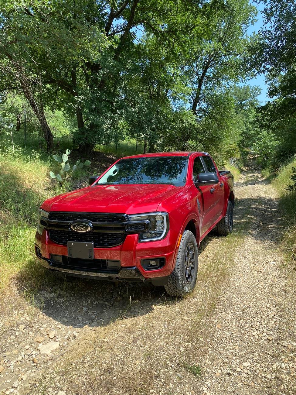

Hryo
Jahiro
Jun 8, 2025
2025 ford ranger
automotive painter
Hey what tire combo you end up going with. I have a 25 with the bap 18in wheels. I have a 2 in level on order and wanting to go with 275s and keep stock wheels. Just not sure if there would be clearance issues on the knuckles with that tire size. Yours looks good from the profile pic.

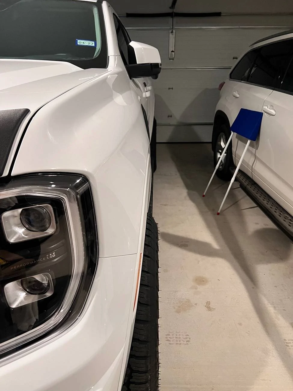

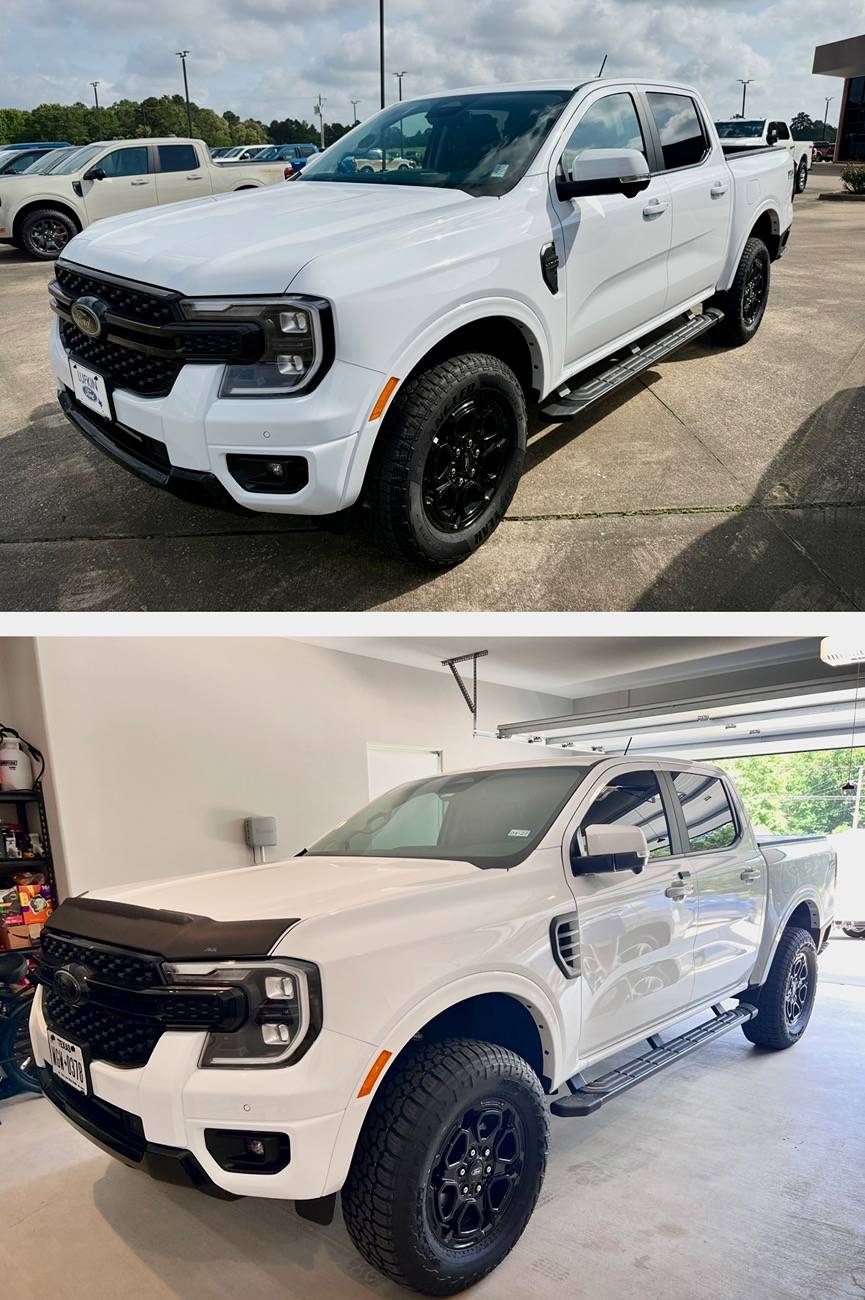

Thanks! I went with 285/65/18’s, mainly because I found a set of Falken Wildpeak AT3’s super cheap. Width on the Falken’s is 11.22” and they do not rub but it’s really close. You could easily do a 275 that’s say 11” or less. I also added a set of 1.4” Bourne Off Road spacers just for a little room and more aggressive look. Took the factory rims from a +55 to +20 offset.
Came out great. I too have the BAP and really like the wheels.
That’s a pretty awesome looking truck. I’d been considering ordering those same fender vents and painting them to match the body color. Did you get those from Ford or did you find someone selling them for a bit less?
