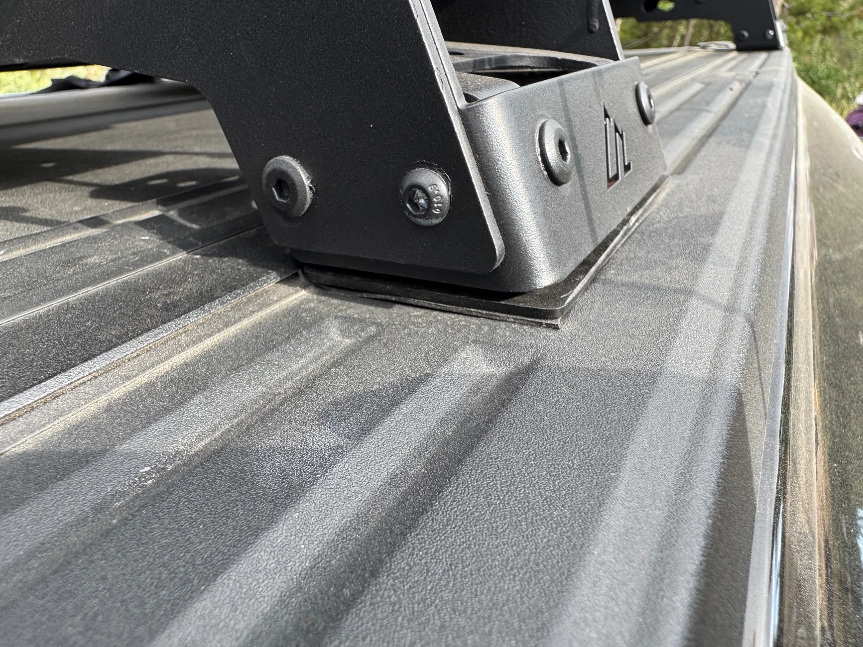

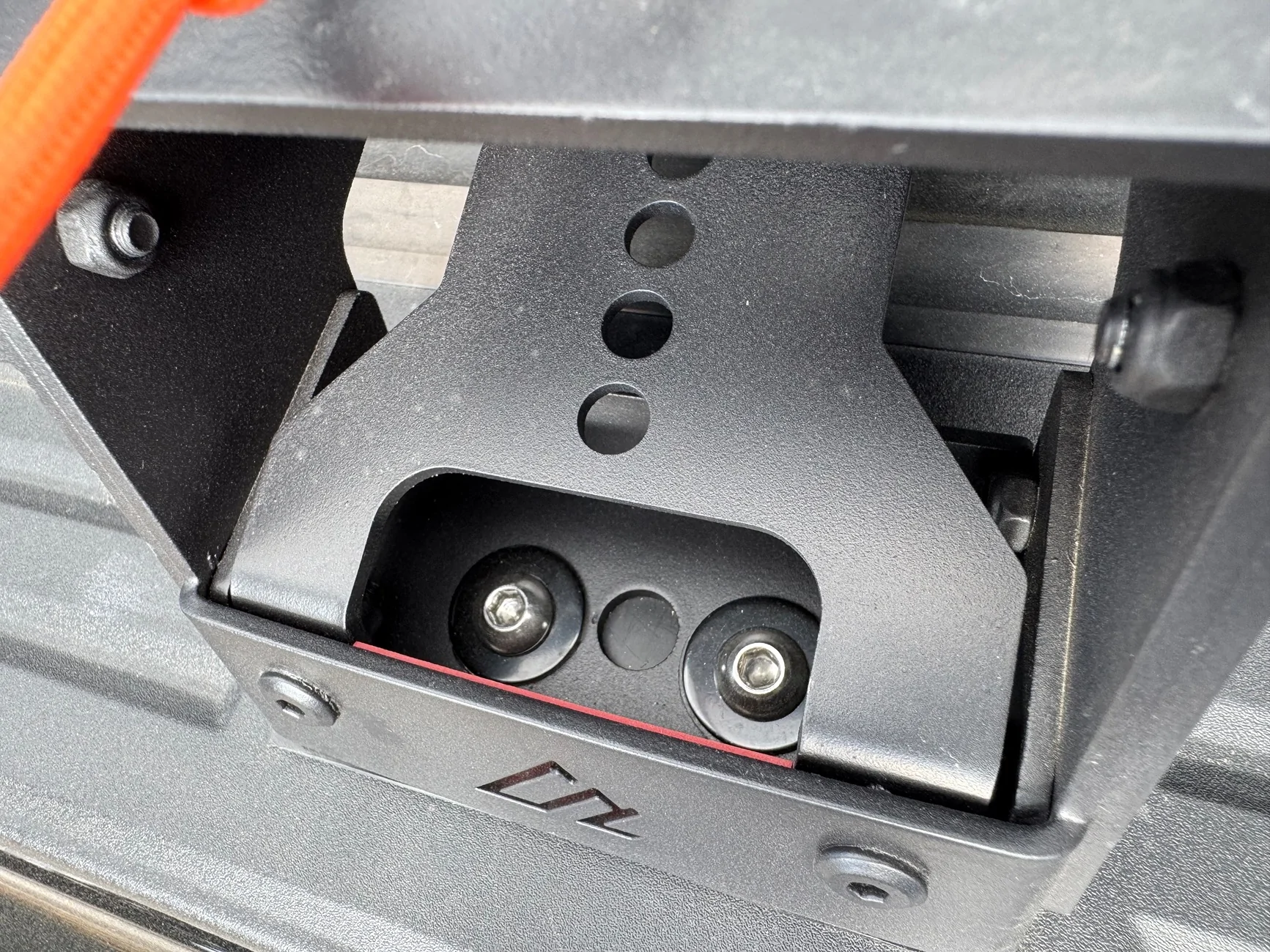

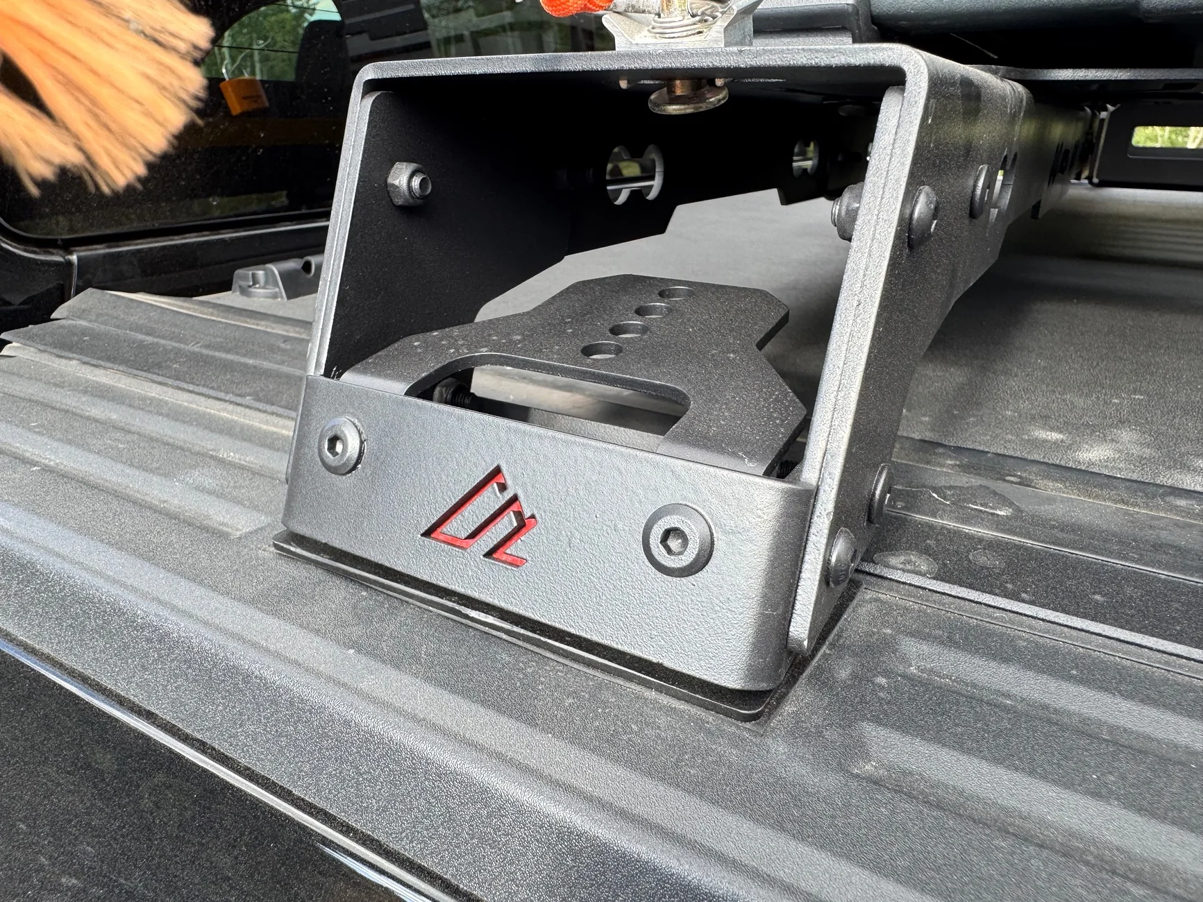

Have you considered a way to seal where these mount for those with tonneau covers using them as light mounts?
For my bed rails I ended up adding a thin piece of nylon sheet cut to size slightly larger than the hole in the bed rail that the shim pack inserts into. With the appropriate bolt holes drilled out and a piece of neoprene rubber that sits under the nylon.
I think the rubber is 1/32” and the nylon is 1/16”. Just enough to provide a water tight seal.
the bed rails sit on top of these which sit on top of the shim pack. Had some heavy rain the other day and it worked well.

Looking at these again they might not need it as they have better coverage across the top than the bed rails.
I’ll add photos once I’m somewhere with better cell coverage.

These are slightly wider than the hole cutouts. This was done to match the width of our light pod brackets, but it would also provide some surface area to attach some adhesive-backed foam. This should work well with maybe 1/4" thick foam tape.
https://a.co/d/iq7vViS
Aemonn
Jul 8, 2024
213
269
This is what I ended up doing on the bed rails/cross bars.
