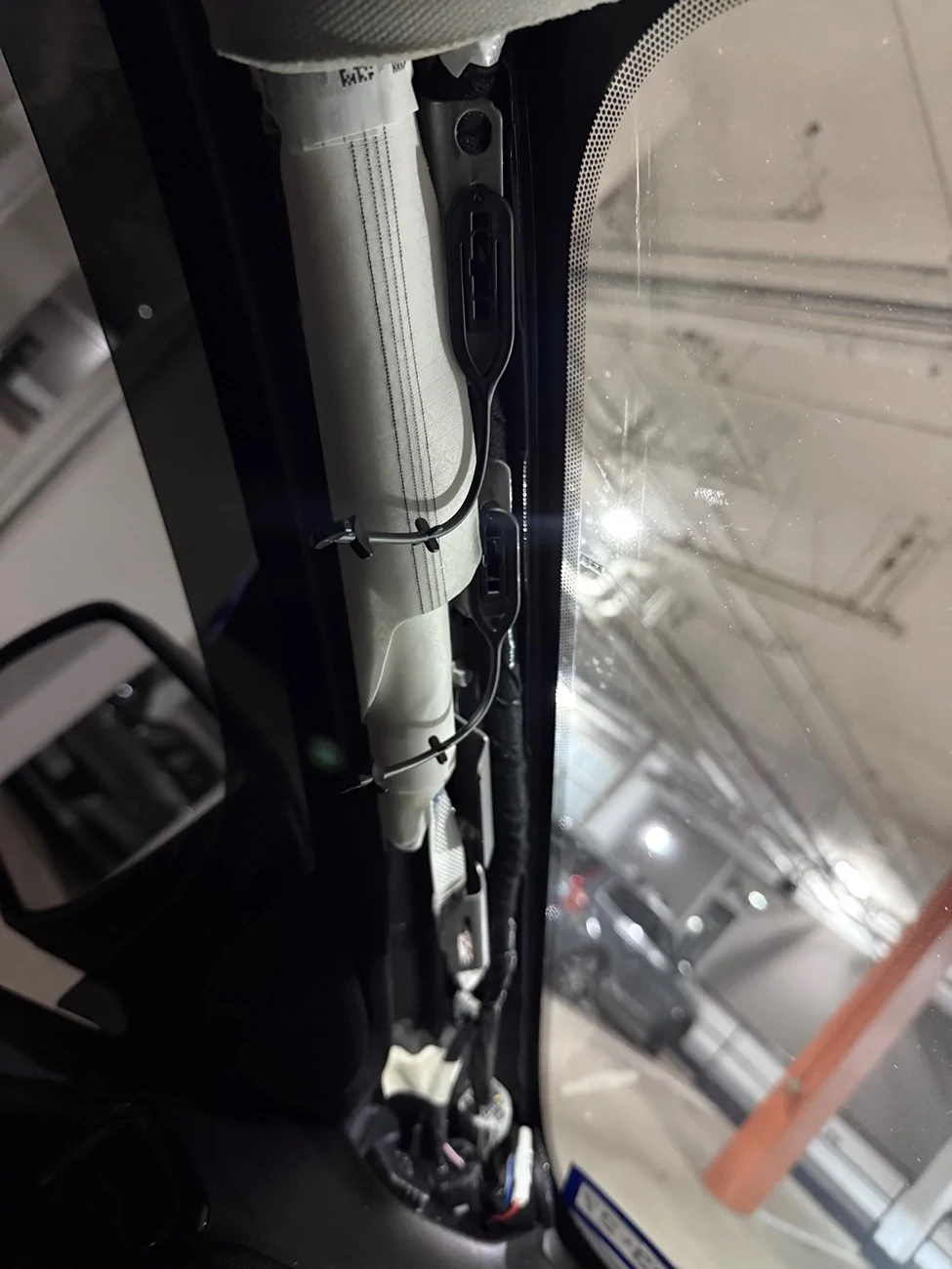

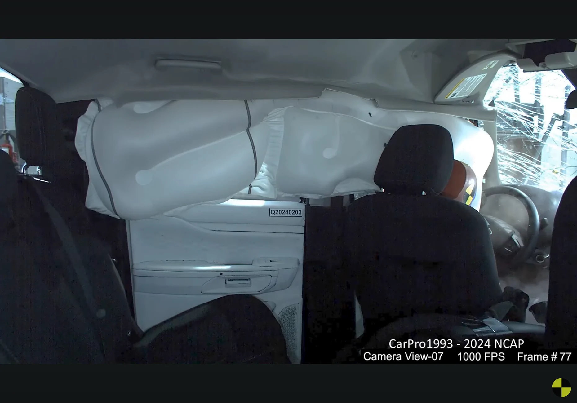

I could be wrong but I think the airbag is in the b pillar between the doors which has the words airbag on it, and that is what the recall mentions.
https://static.nhtsa.gov/odi/rcl/2025/RCLRPT-25V541-7747.pdf
i don’t think the a pillar has an airbag
they do, drivers side a pillar trim will be caught by the 2 black plastic string looking pieces, and the passenger side gets held in by the grab handle as it should force the trim over the mounting bolts but catch on the handle itself

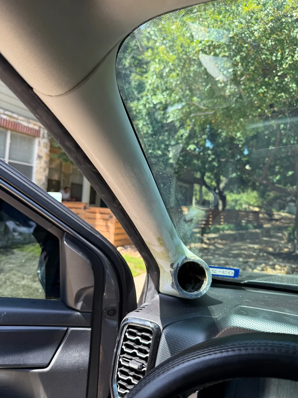

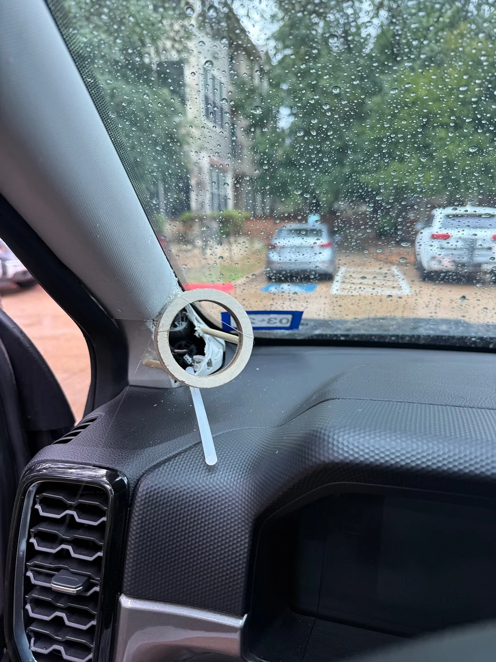

Ford Ranger 2025 XLT custom A-pillars and wideband speakers project IMG_0346

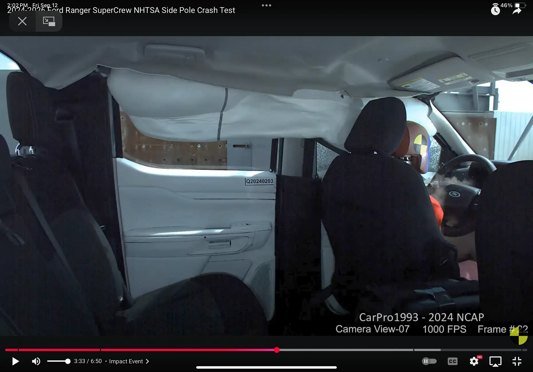

I didn’t understand that the side curtain airbag extends all the way across from back to front. Thanks for sharing,

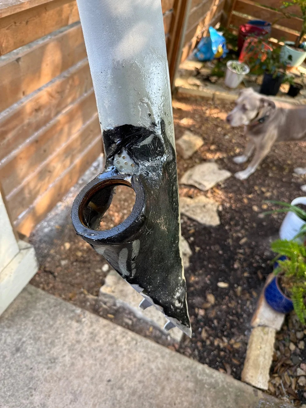

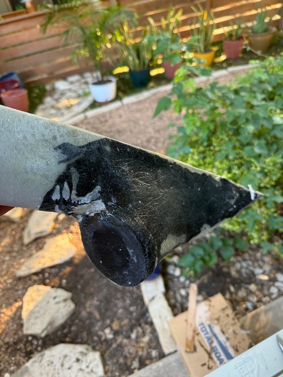

Ford Ranger 2025 XLT custom A-pillars and wideband speakers project IMG_2496
Ford Ranger 2025 XLT custom A-pillars and wideband speakers project IMG_2494

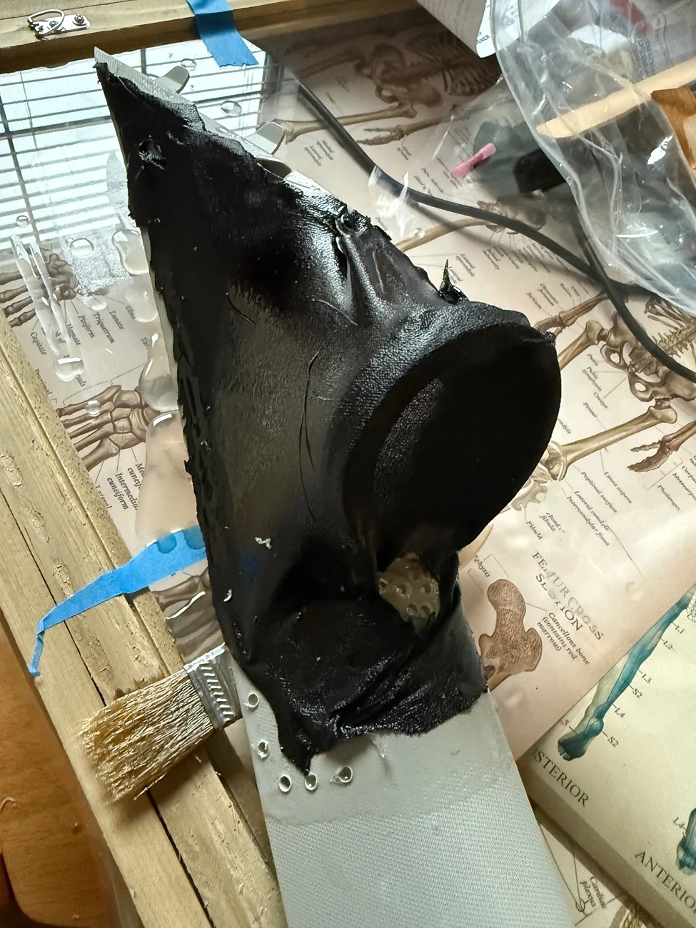

slowly making progress on my build, first time attempting custom a pillars for a 2" wideband speaker.

You’re an old school artist! Well done.
I look forward to seeing the final pieces.

i have like a 50% idea of what im doing haha. but i grew up in the mini truckin car culture so there was always lots of fiberglass enclosures to look at. best way to learn and worst case i just have to buy new trim panels

yeah i saw the recall but havent gotten a letter on it for my truck yet, i think the recall affects the actual structure of the a pillar not the trim. as this peice jist blows off if the airbags deploy and get caught by 2 plastic catch clips.
" this peice jist blows off if the airbags deploy"...yeah, quite possibly in your face 😵
Non-engineer saying his 2 plastic clips are going to save him when the air bag explodes and deploys. The whole point is to prevent things from flying around in a car crash, its why the trim is designed to split not break off.
ill be ok, dont worry :)

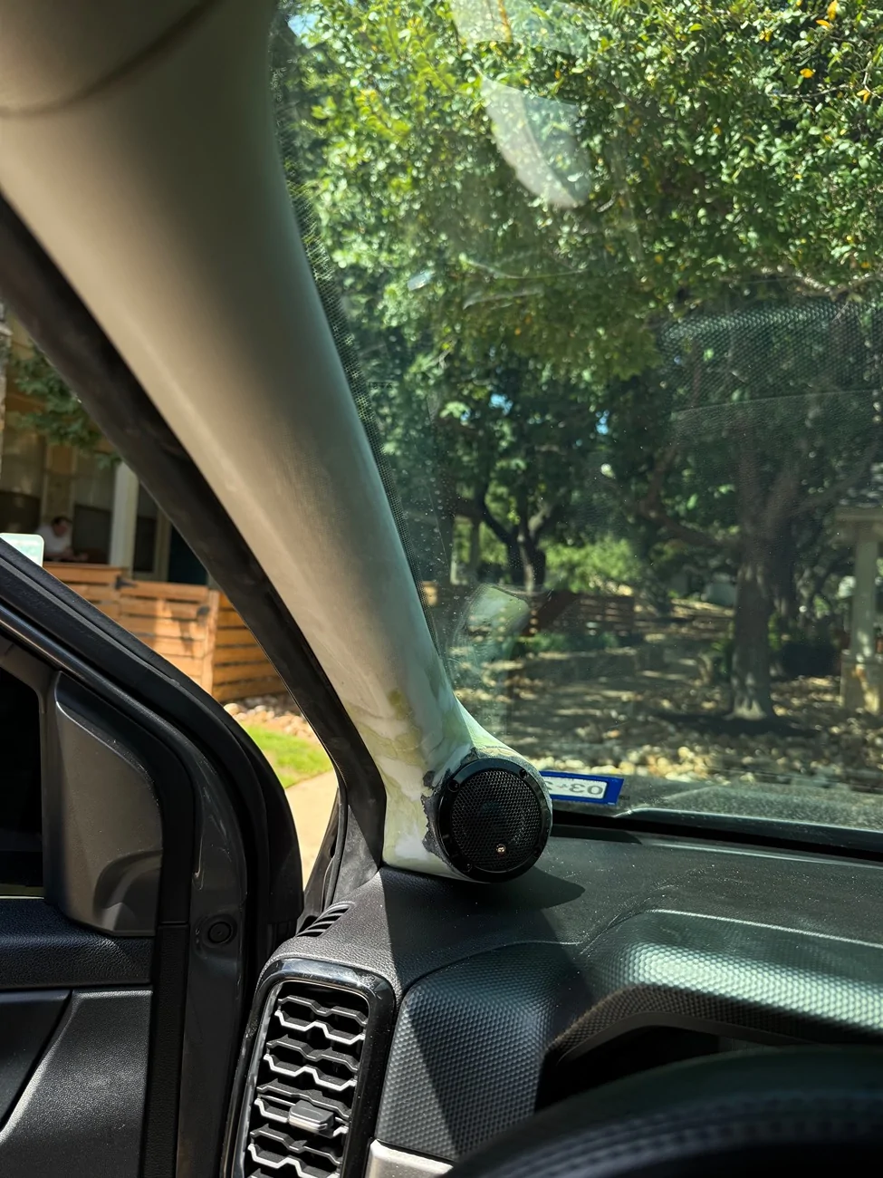

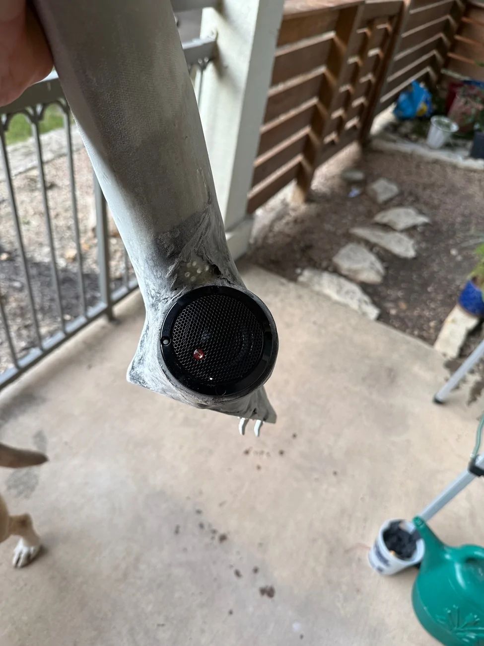

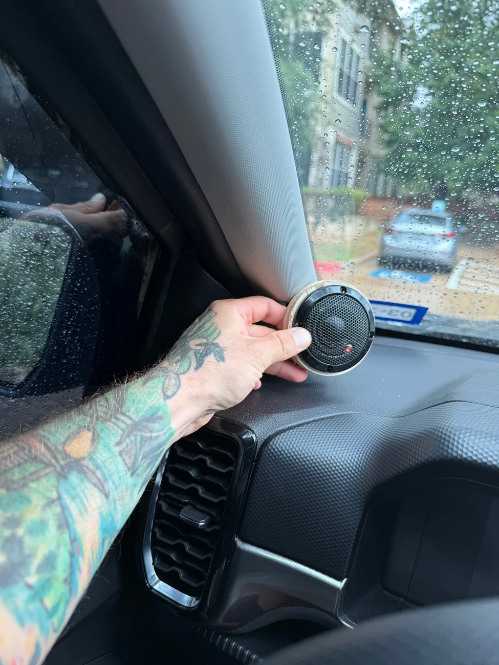

Ford Ranger 2025 XLT custom A-pillars and wideband speakers project IMG_0365
Ford Ranger 2025 XLT custom A-pillars and wideband speakers project IMG_0366
into the final stages now for the first pillar. a little more body work to smooth things out and then deciding whether or not to paint or wrap them.
going to temporarily wire the speakers up to factory wiring with a 300hz cap on them (factory tweeter has a 5.6k hz cap if anyone is curious)
