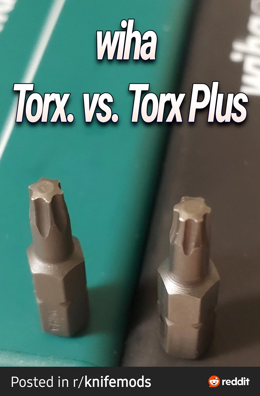

Nice. I used a utility blade, went around the bolt head at the tie down, and used an 90° oring pick and the whole linger head popped off the same as that. for thr budget person that cant drop on one thise atm.
I will say for those going st this. PICK UP A TORX PLUS BIT!!!! I stripped out the torx on 4 bolts... 3 of them where reinstalling them... with a regular t40. then using the tp40 I didnt strip a one.

Hadn't heard of the torx "plus" size bits. Useful to know for sure. Using Torx for the past 40+ years, I thought some of them just sucked. Wonder how long the "plus" has been around.

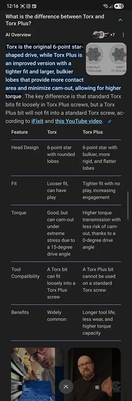

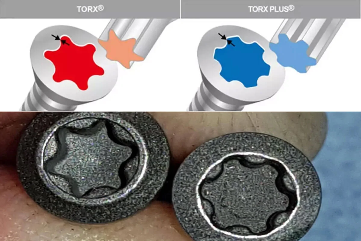

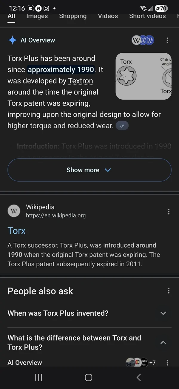

A t40 bit will fit a tp40 bolt. a tp40 bit wont fit a t40 right. the torx plus is suppose to have better engagement then standard torx and wont strip as easy... unless you use a normal torx in them..... like I found out. never knew about torx plus till may 2025. lol 15 years of wrenching on my own and helping friends and family out... also never heard of it. lol
and apparently torx plus been around since the 90's and the patent expired in 2011.

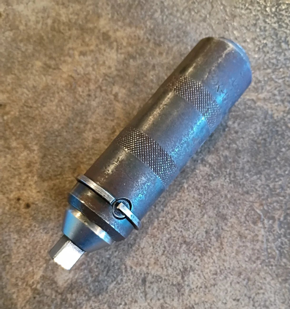

Or just use a hand impact driver with the correct bit, it will get them out without stressing you or your wallet. These are used with a large hammer or dead blow mallet, the force drives the bit deep into the recess and prevents slippage. You should dig out as much bedliner as possible first, but it isn’t critical. These were a must have tool when Japanese motorcycles first came out with their dozens of dead soft Philips head engine cover screws.. My 50 year old no-name one is still working fine. I do suggest that you get an established tool brand, not a knockoff. Hit it lightly a few times to get the bit seated, twist to the left and then whack it hard. Wear a heavy glove on the hand holding it! If you don’t wear a glove and your aim is bad, it will remove a huge piece of skin at the web of your thumb. Ask me how I know
. You will only make that mistake one time!
John Davies
Spokane WA USA
While mine hasn't been used in a long, long time, my K-D Tools impact driver is still in the tool box. Got it as a teen-ager working on my Hondas in the late 70's as a teenager. Used it in my days as a Yamaha and Kawasaki tech after high school.

Just ordered a TP40 socket as I'm fiddling with these exact bolts. Managed to get two out with a regular T40. Working the bolt back and forth created friction and loosened the Locktite.

Ran into the same problem taking on and off the bead-lock rings.
Regular torx will srip some of them every time. I now have drawer full of TP bits. Lol
John. I replied to another post you had about using a hand impact driver. I still have mine from the ‘70s as well. But, I don’t know if you knew this or not, I learned it over 45 years ago, when I was complaining to my Honda dealer that all the heads of the screws always stripped out. Just like a lot of people here are just learning after many years about Torx plus fasteners existence, I do not know if you knew our Japanese motorcycles of the ‘70s engine housings and carburetors did not use Phillips screws.
Those Phillips looking screws were not Phillips—if you used a Phillips on them, they easily stripped out They used Japanese Industrial Standard (JIS) screws. JIS screw heads were on my 72 Honda engine cases, they looked like standard # 2 Phillips—but, JIS internally is not as deep as a number 2 Phillips which doesn’t let the teeth fully engage—it isn’t that the screws were soft as much as it was that you were using the wrong tool. JIS screws usually have a dimple or punched dot on them. If you ground 1/32 off the tip of a #2 Phillips bit, and then beat it in the screw with a hammer, or an impact driver, it would work better, but the angle of the teeth on the bit still lack full engagement because of different angles—the better thing to do is get the right tool in the first place. I worked at a Datsun dealer back then and had entire sets of JIS screwdriver and bits. And, let’s not even talk about the new Pozidrive (Phillips), or Triple Square (kind of a Torx looking head) found on high stress parts on Porsche, Audi, and VW.
Back to these screws on our tie-downs, I do not think the manual impact is the right tool for this job. Look at the picture of the screws I removed—they have over 1/2” of thick thread locker. The threaded nutsert in our bed panels is only about 1/4” thick, and the thread locker is all the way down the screw, on the other side of the nut. There isn’t any thread locker just under the head (where the tie-down is clamped under).
I attempted to remove one screw—it took forever to pick out the bedliner from the Torx hole, I then applied more than 30 lbs of force and it didn’t budge— I started to feel the “give” you feel right when a fastener is about to break—and stopped. These are only grade 8.8 bolts—that are only rated for about 30 lbs of force to break. There is too much thread locker to reliably remove them without damage, and without heat. You might be able to get some of them, or you might be able to get all of them, but—chances are high that you will ruin the screws, and that you will snap off at least one—and then, you are going to have to use heat and drill and easy out—and we are back to what I was trying to prevent in the first place.
I really don’t like the idea of repeatedly beating on an aluminum nutsert welded on an unsupported aluminum body panel (which is basically what the inside of our beds are). I titled this post with “An Easy Way” to remove—not a cheaper, labor intensive way. To me, my time is valuable. I have read where others have slowly worked the screws forward and backwards, another on here commented about using a heat gun. I couldn’t even get the first one I tried to move at all ( in the pic, the first one I attempted, is facing outwards and has the lobes of the Torx teeth shiny—the head is partly twisted off—once I applied heat, it came out without any force.
