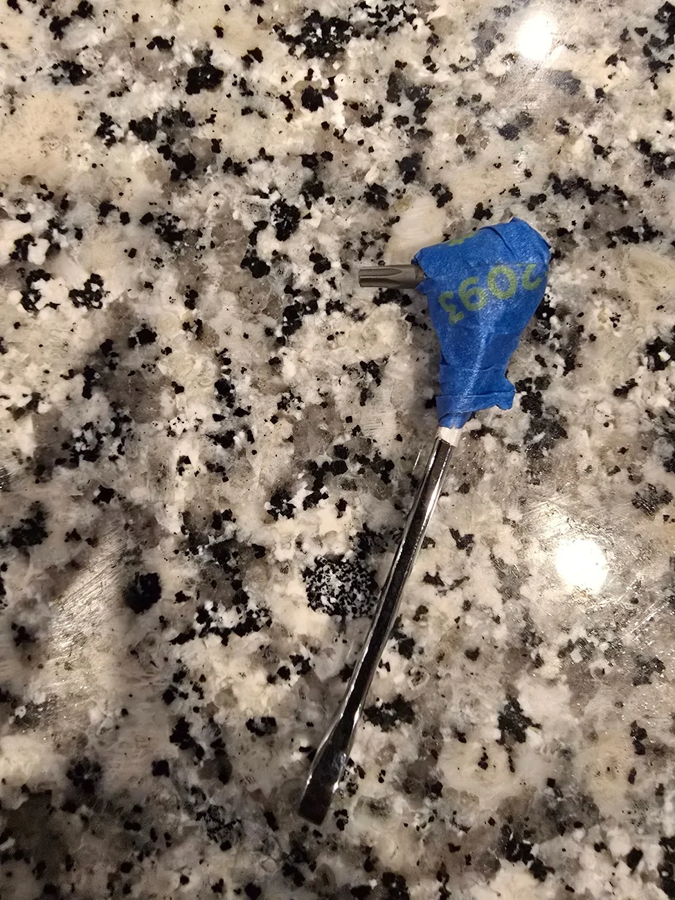

Spent Christmas Day installing the @Signature Lux DRLs on my 2024 XLT. It was a tedious install. I've never hated anything the way I hate the top inside screws on the DRL modules. The real MVP of the install was a self fabricated 1/4 wrench and 15T torx bit held together with painters tape.
There is no room between the frame and back of DRL housing to fit any of the 3 flexible driver extentions I have. Even with the home-rigged tool, it was one hand through the wheel well holding the bit to the screw and one hand over the top turning a quarter turn at a time.

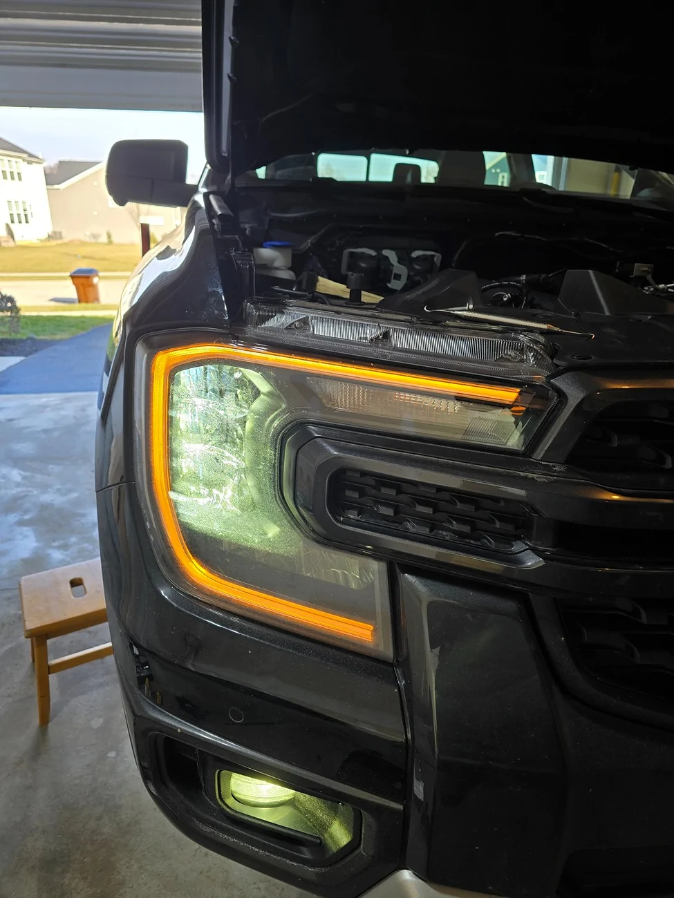

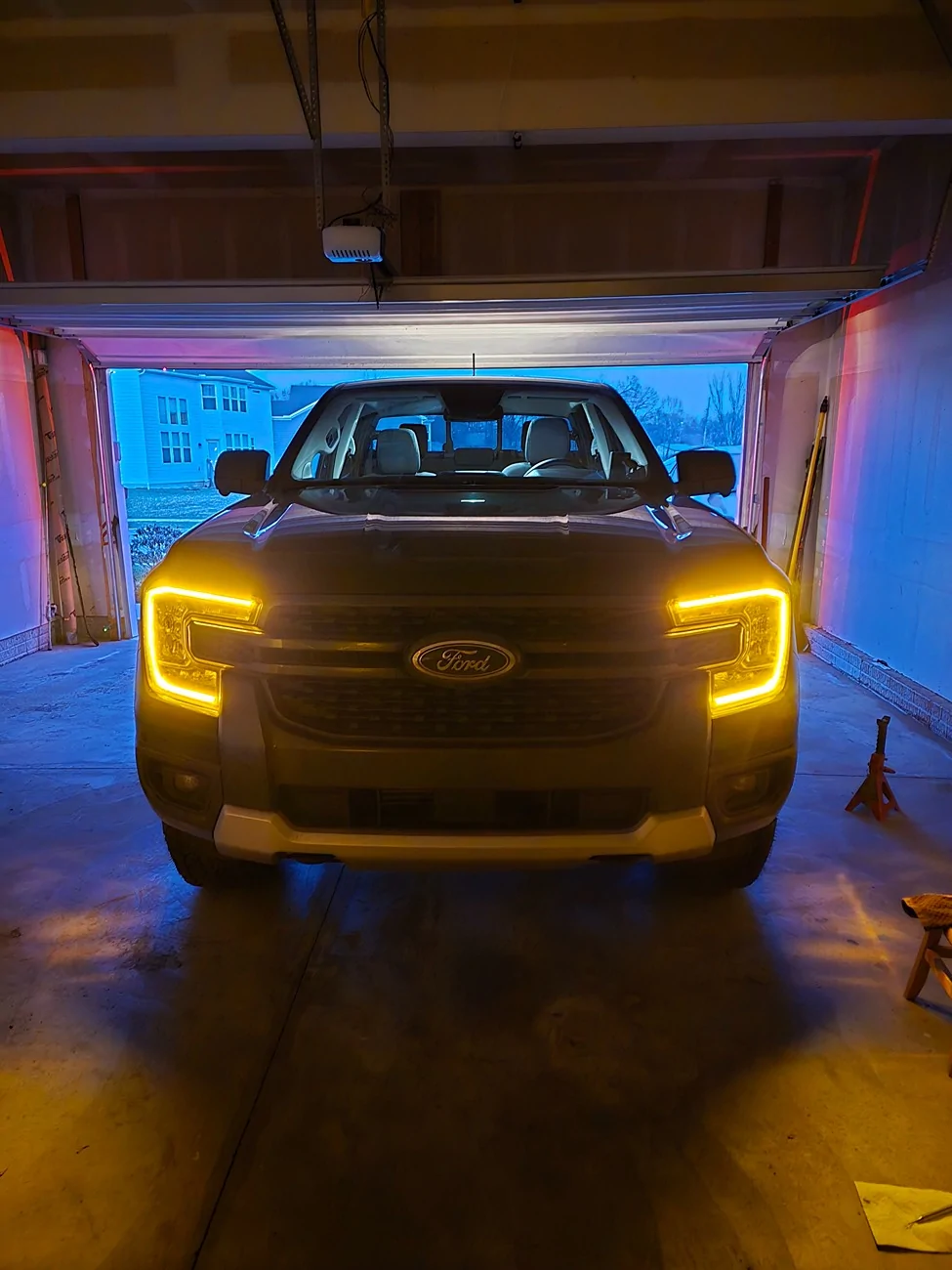

The pictures don't do the amber light justice. They are sweet looking. Even my wife thinks they look sweet.

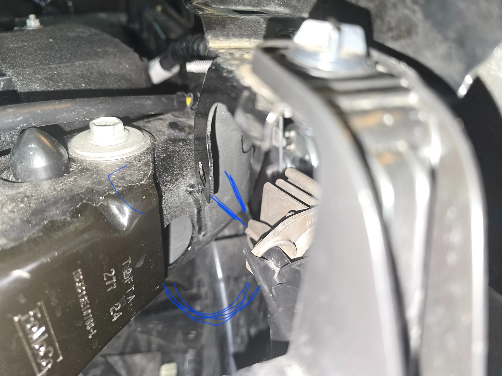

Nope, the one closest to the engine - its tucked behind a weird part of the frame. You can see it in this Pic.
Driver side - You have maybe an inch of room between the housing and the frame next to the screw. Then maybe an inch and a half between the screw and the frame directly behind the screw. Then you have a very tight space to leverage a tool. None of the flex extentions I had could snake in there. But my "self fabricated" wrench did the trick 1/8th of a turn at a time.
Ahhh, gotcha. I just looked at mine and feel like if I take the battery tray out on the driver side and the air box on the passenger it will be fairly easy.
Did you attempt that? Am I missing something?

Not really. It doesnt provide any more space needed to work between the frame and the back of the housing. The best leverage point is either thru the wheel well or completely removing the front end.
I'm not a certified mechanic, but I've done a lot of engine, induction, and electrical mods on Focuses (Foci??), Fusions, Lincoln LSE, and Explorers. This was by far the biggest PITA I've come across in 20 years.
