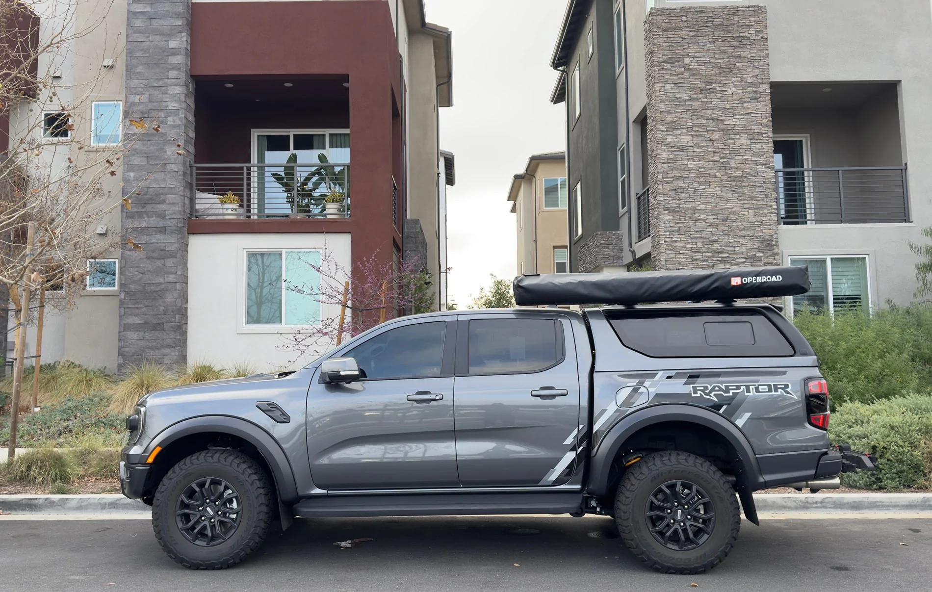

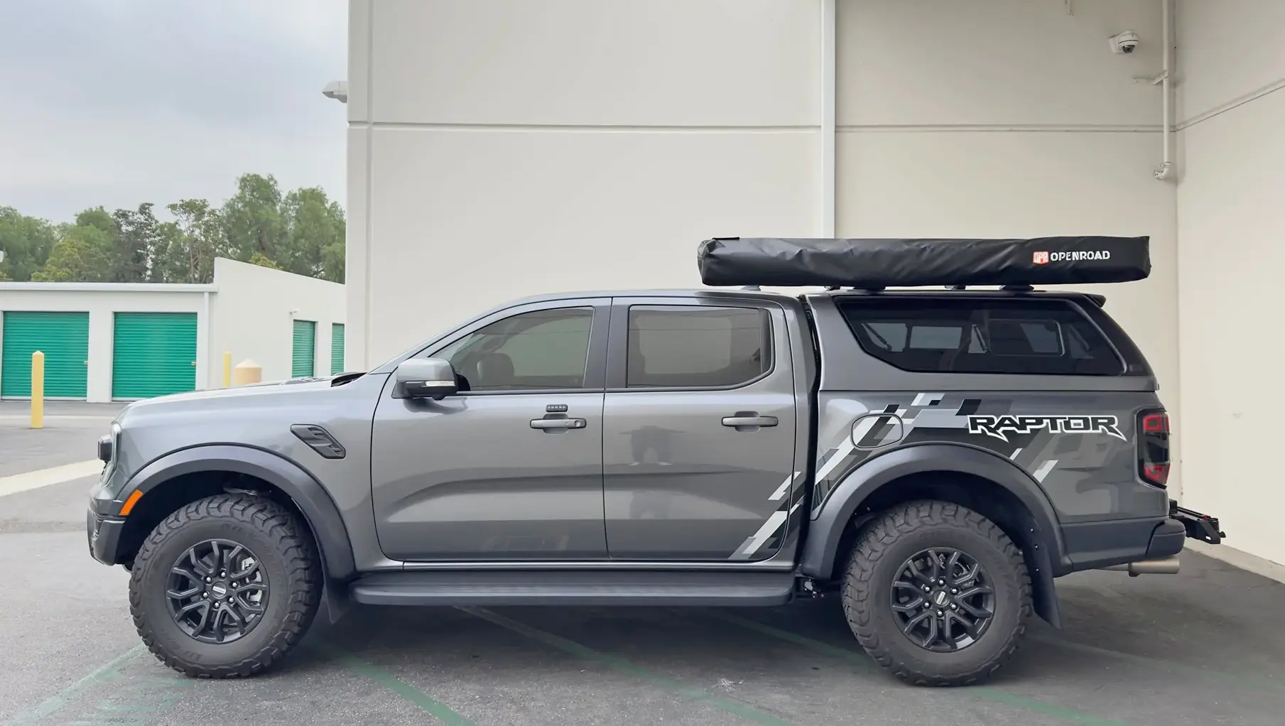

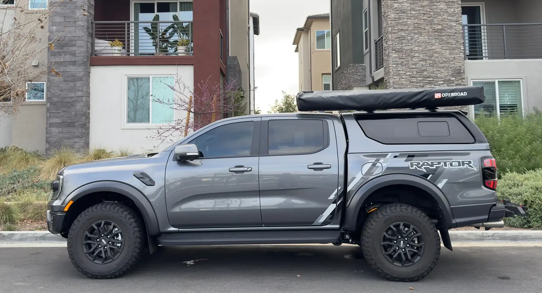

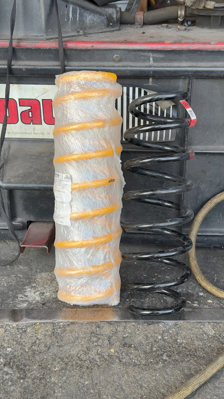

I bought a setup of Kings Springs for the rear R121. They are supposed to handle up to 300 lbs and increase height about 20-25mm, about an inch. Once installed with my 210 lbs canopy, 270 awning,
50 lbs, and ski racks about 30 lbs.
The rear sits over 40 1/2 inch from the ground and about 3 1/4 higher than the front stock springs.
The ride was harsher in the beginning and now seems to calm down. It now doesn’t have the nice floaty, swaying ride which i missed but with only the rear springs seems to be ok not so bad. I am waiting for the front to arrive soon and will post after I install and have some miles on them.
Here are some photos for reference.
Have a nice day everyone!

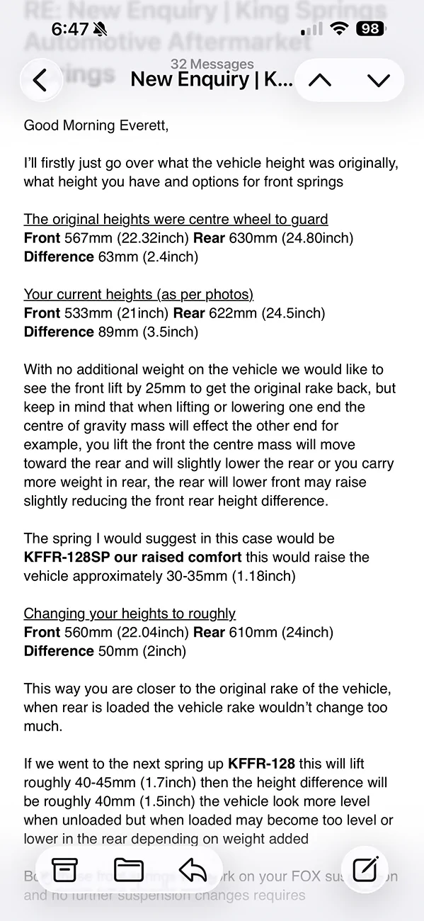

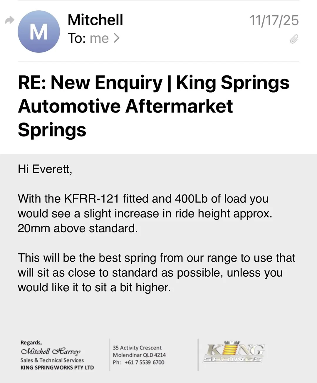

I love the idea, but am I missing something? With + 300LB springs and adding almost 500 pounds, all in the back, I would think it should sit a little lower than stock and ride about as soft.
momodog
momodog
Everett
Nov 6, 2025
70
89
Socal
Ranger Raptor Carbonized Grey 2025
Financial Advisor
Hello Pick-N-Stick
This was the initial email i got from King Springs, sorry for 400 lbs weigh attached
You said these springs can handle up to 300 lbs. Does that mean if a trailer hitch weight is 350lbs. those springs can't handle it? or does it mean 300 lbs X 2 so it can handle a 600 lbs hitch weight? Thanks
momodog
momodog
Everett
Nov 6, 2025
70
89
Socal
Financial Advisor
AugPal:
I was told they can handle 400 lbs. with 20-25mm over stock height. I am not sure about the trailer 350 lbs. alone plus content. Maybe you can reach out to them.

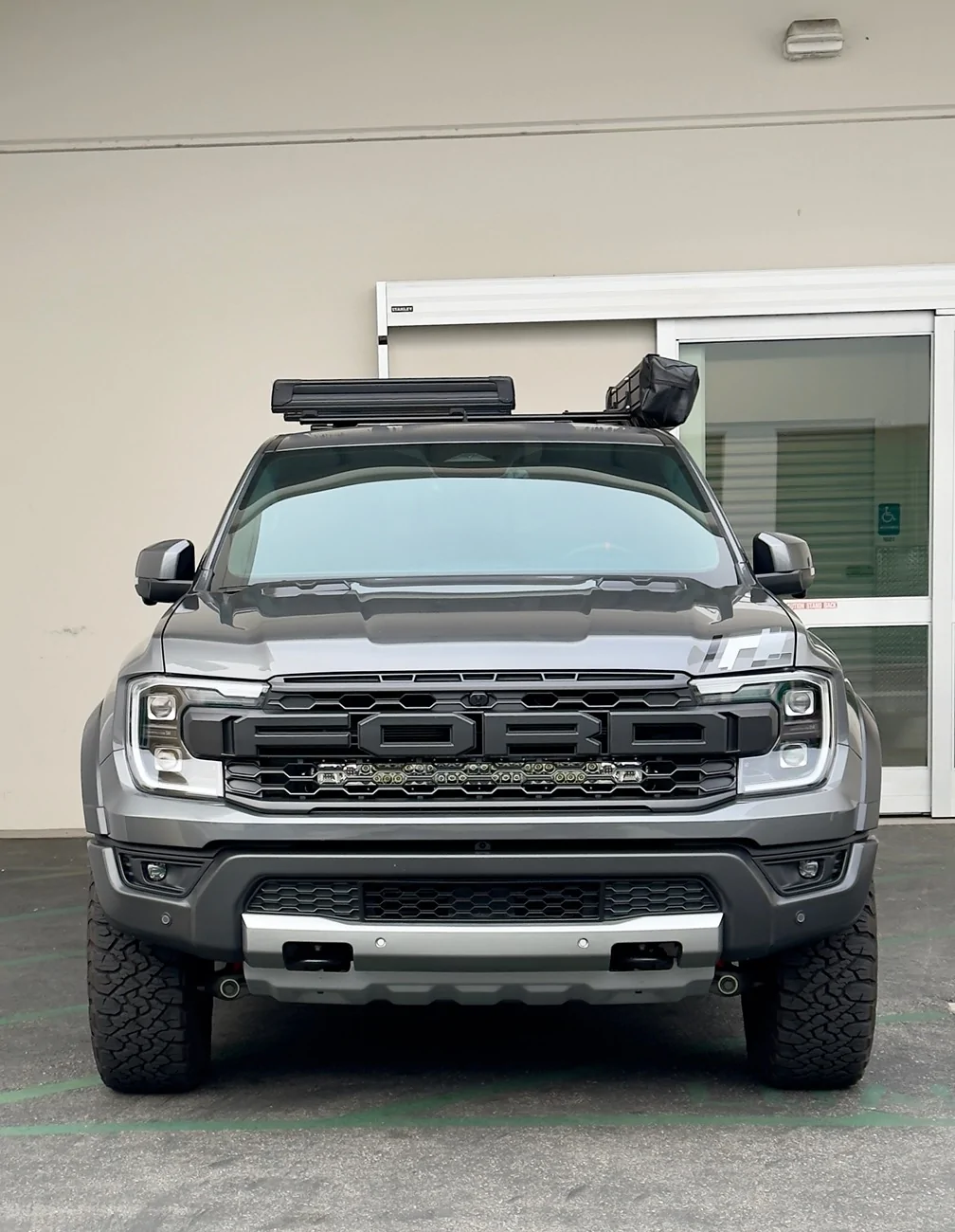

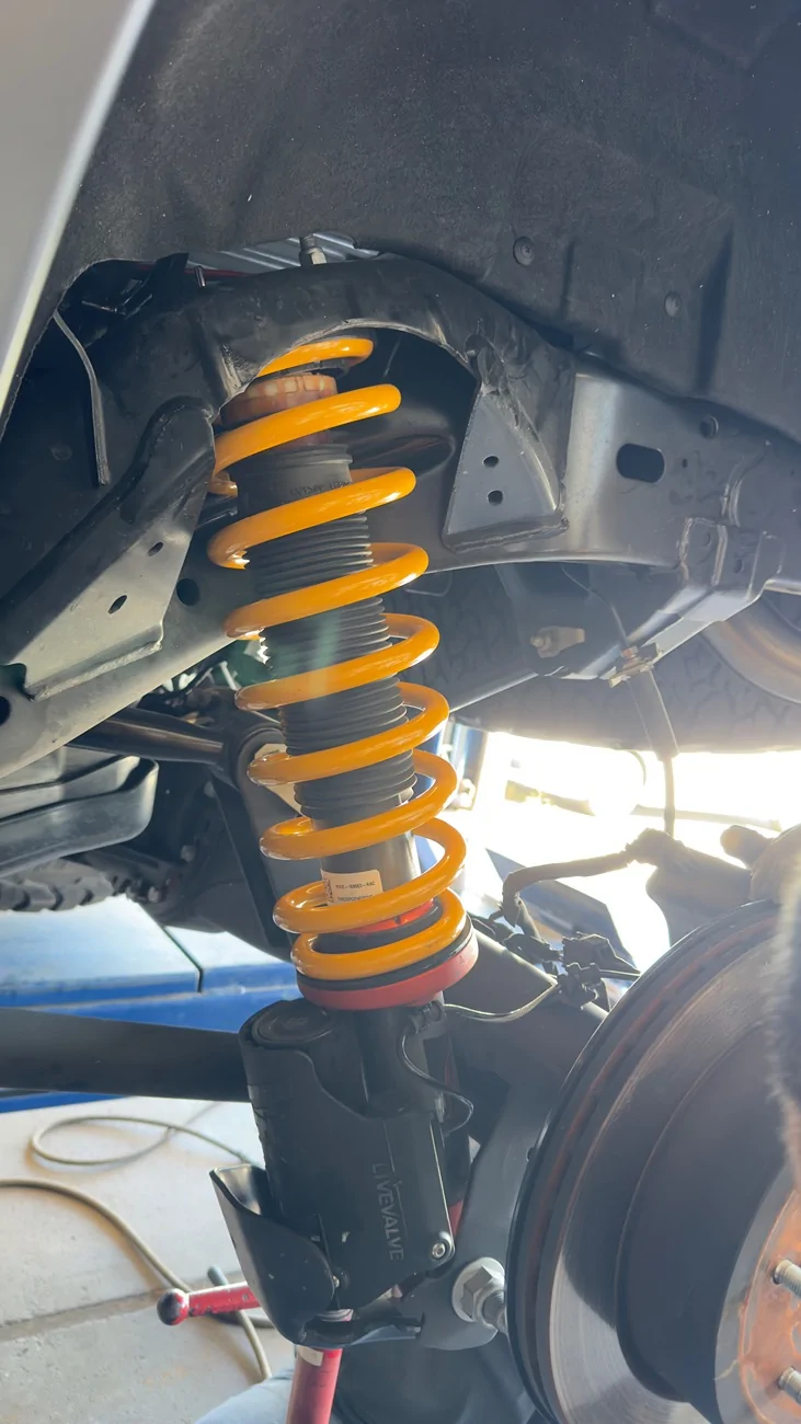

How many miles are on your Raptor? A light bar and minor CoG shift shouldn’t be enough to cause 1.3" of front sag.
Our trucks are known to have relatively soft front springs, and they can lose rate pretty quickly under load. Perhaps premature metal fatigue??
momodog
momodog
Everett
Nov 6, 2025
70
89
Socal
Financial Advisor
I dunno E40. I have little over 10k miles since i bought my 2025 Raptor in Dec 2025. No bull bar just 40-inch light bar mounted inside the front grill.
The canopy+270 Awning +Thule 6 ski rack+ Yakima Exo hitch without any attachments. Please nothing more than 30 lbs. inside the Truck bed.
The rear is jacked up too much for the weight I want to carry. I don't want to load up cos the truck drive like a truck now. I don't have the lively, springy feel when stock.
I have my eye on Dobinson Springs which is supposed to handle 175 to 200 Lbs. load and lower back to stock ride height.
After my try to Raptor School in Utah, I can install the King front springs and see how harsh the ride. I plan to get a guy to do the forscan to reset fox shocks to fool the system this is stock height and see if ride better
