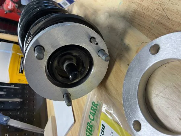

I was looking for a mild 1" lift but all i could find was Ranger lifts (2 1/4" welded steel plates). I wanted something in aluminum for corrosion resistance and i also wanted a little fun designing something of my own. I created a design for 6061 Aluminum and had it laser cut by Send Cut Send for $73.00 (free shipping). New shorter flange nuts will be required to ensure proper thread engagement and can be found on McMaster-Carr (95003A216 Pk of 10) for $7.96 ($10.01 Shipping).
After install and some driving to settle the suspension, the result was a +7/8" in the front. Ill edit this post later to add before and after side views and wheel well measurements.

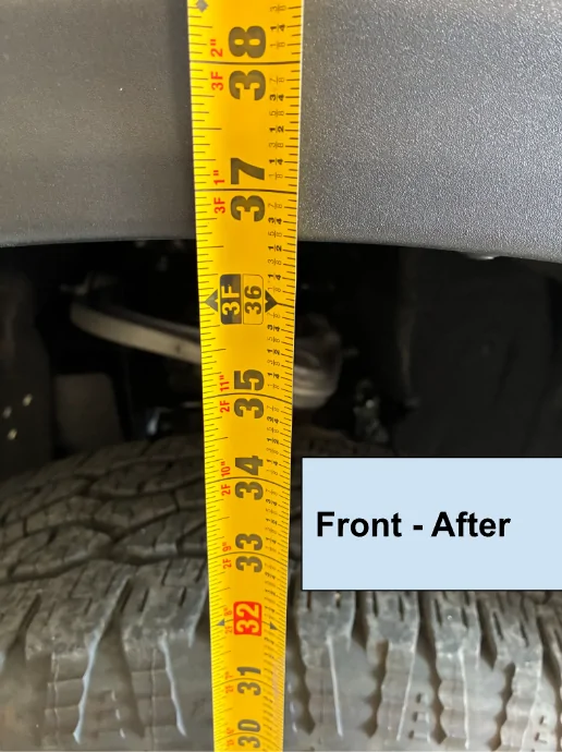

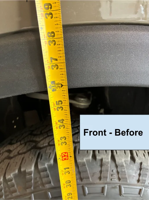

Ford Ranger Custom 1" Spacer and Detailed Level Kit Install Instructions Front Befor
Ford Ranger Custom 1" Spacer and Detailed Level Kit Install Instructions Front - After
the rear did not change at all and remained at 38.25" so i now have about 1.625" rake.

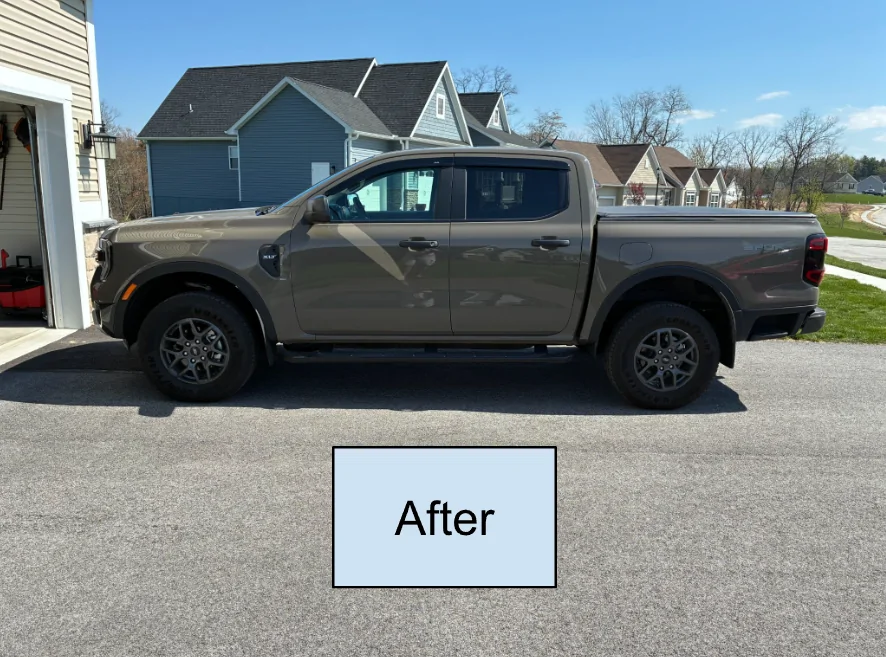

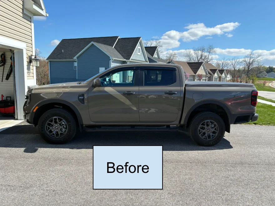

Ford Ranger Custom 1" Spacer and Detailed Level Kit Install Instructions Before Sid
Ford Ranger Custom 1" Spacer and Detailed Level Kit Install Instructions After Sid
It may not look like much of a difference from the pictures, but in person there is a lot more room in the front wheel well and I also noticed a decent change in my position from the drivers seat.

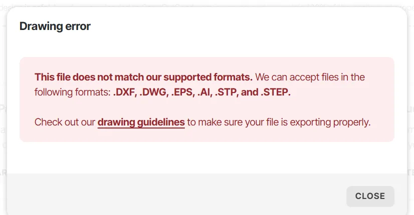

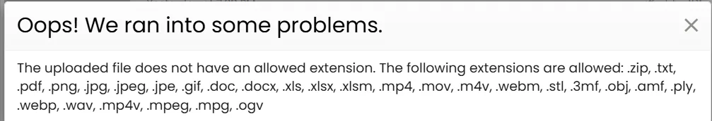

I always do model based drawings so i modeled the actual part in Fusion 360. I also needed the model for the 3D print test part i did before i sent it off to SCS. Ive tried attaching STEP(Generic 3D model Data) files before to the forum and it is not an allowed type of attachment.
Ford Ranger Custom 1" Spacer and Detailed Level Kit Install Instructions 1776374714354-in
It seems like the forums allow .OBJ and .STL which would get you approximated CAD geometry, but SCS doesn't not accept those file types.
