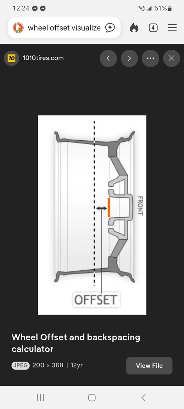

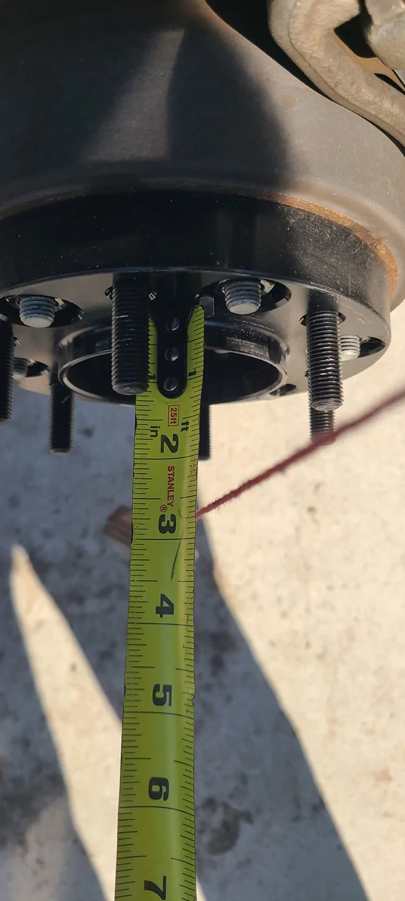

I just wanted to show some pics for those who don't really know what the numbers mean when people talk about wheel offsets.

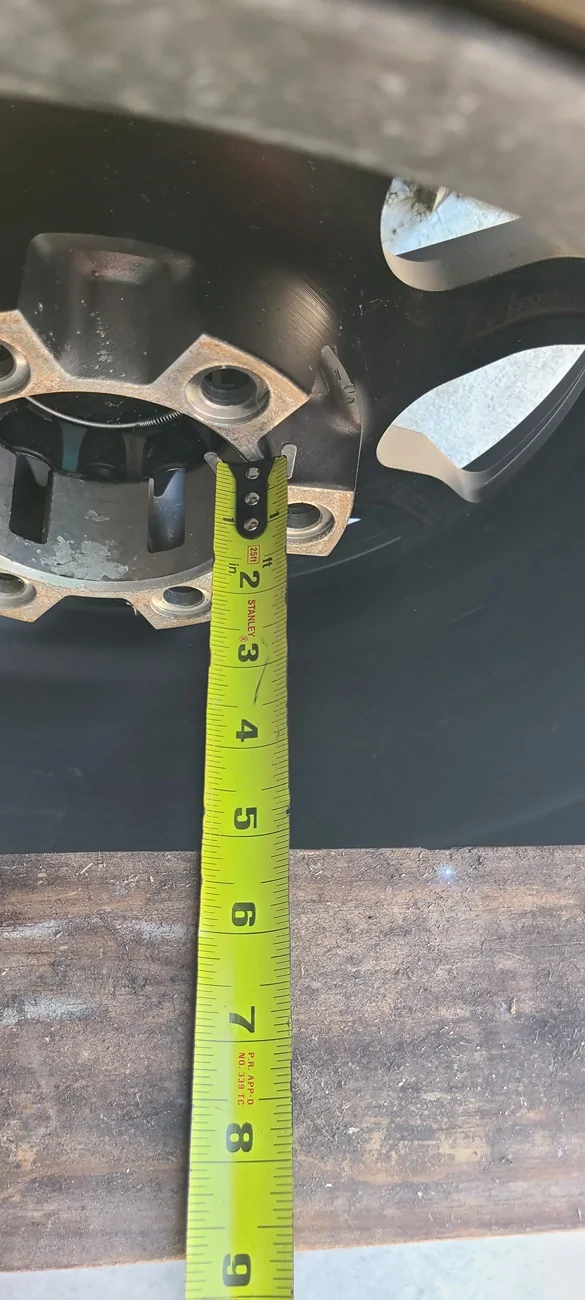

Our stock trucks are running +55 on the non raptor models. That means the wheel hub is towards the outside face of the wheel 55mm from center. So if you have an 8" wheel, you move 55mm towards the side.you can see and that is where the mounting face sits.
Ford Ranger Visual thread for wheels fitting (explains offsets) 20260512_170459

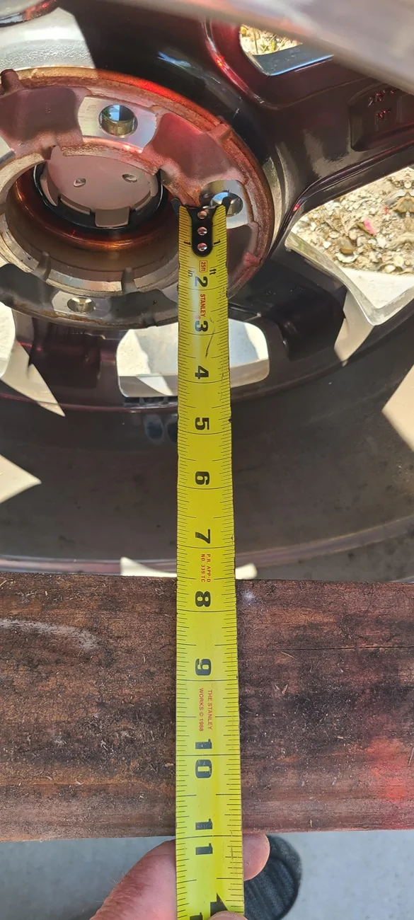

This pic is from a stock 18" xlt wheel showing the mounting face at the end of the tspe measure.
That face sits against the truck hub face. I don't have a pic of that surface because i missed taking that pic, oddly. That face is where the black spacer is sitting in this picture.

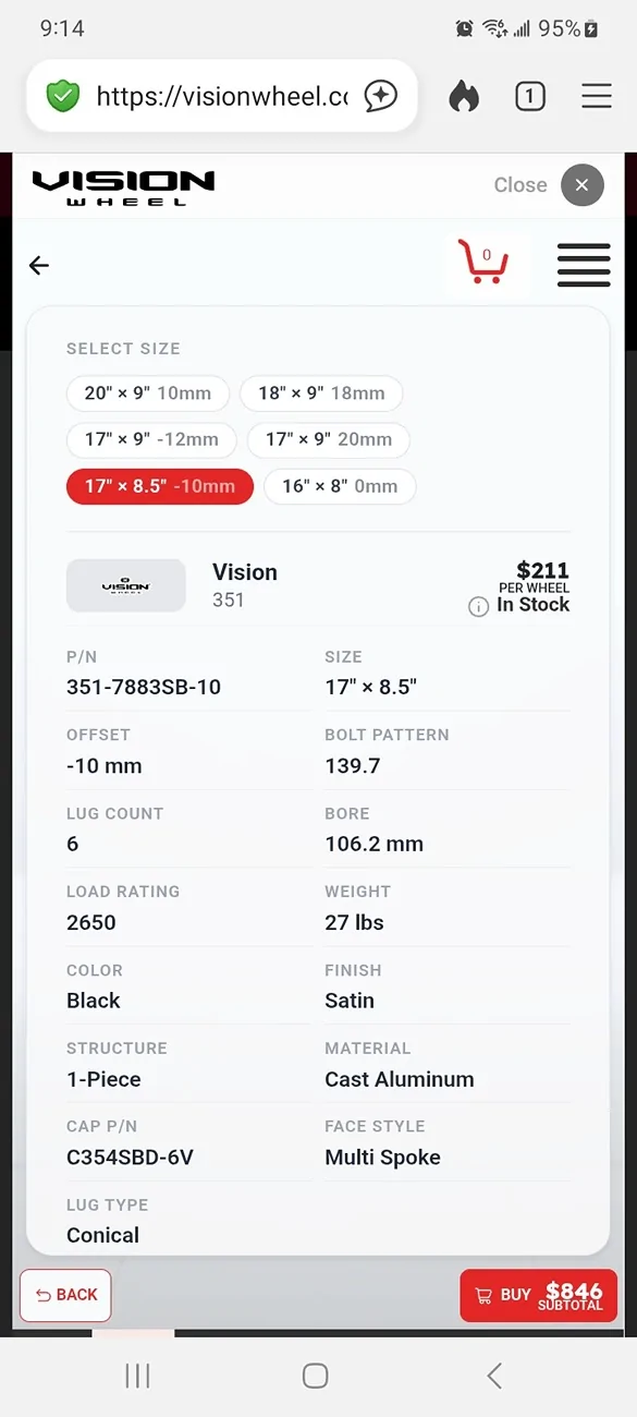

So when you buy new wheels, you meed to know your stock wheel offset and bore size, which is referred to as center bore diameter, centrr bore, or bore, as seen in the screen shot below.
Ford Ranger Visual thread for wheels fitting (explains offsets) Screenshot_20260512_211445_DuckDuckGo

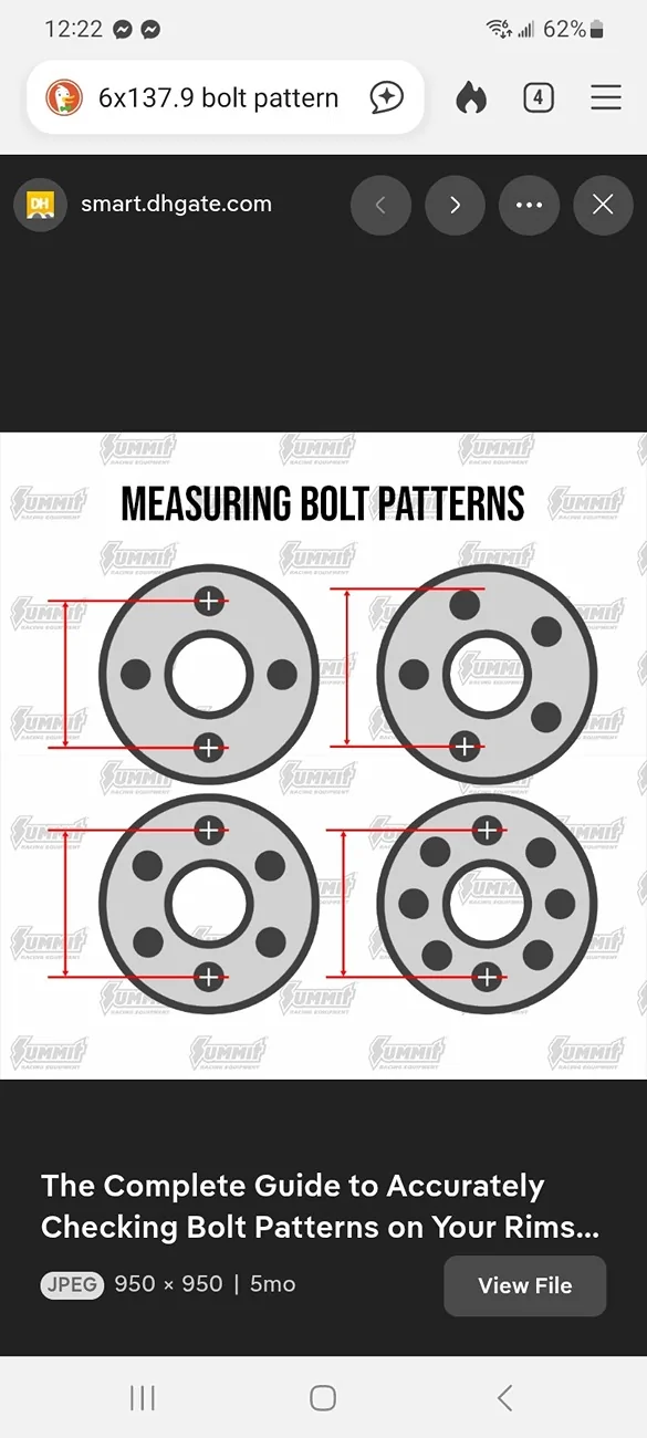

The above screen shot also has your bolt pattern, another needed piece of info when buying wheels.
Ford Ranger Visual thread for wheels fitting (explains offsets) Screenshot_20260515_122412_DuckDuckGo
Ford Ranger Visual thread for wheels fitting (explains offsets) Screenshot_20260515_122201_DuckDuckGo
Our trucks, stock, run a 6x139.7 bolt pattern. People will also call it 6x5.5 but that is also what they call thr f150 size, which is 6x139 so make sure your possible wheels are 6x137.9.

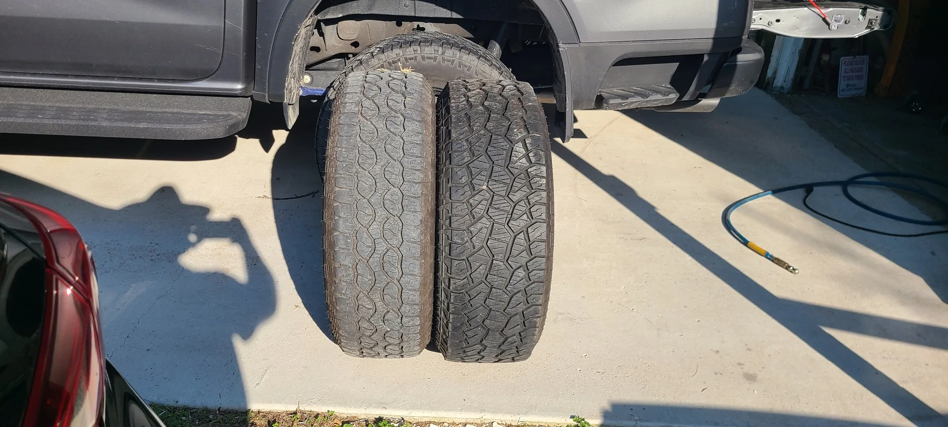

So now we are to comparison pics
Ford Ranger Visual thread for wheels fitting (explains offsets) 20260512_180309
25565/18 on the left and 265/65/17 on the right.

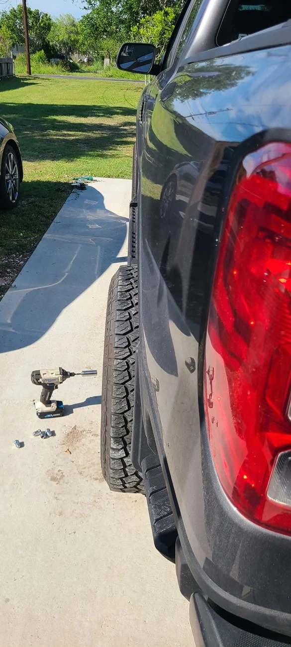

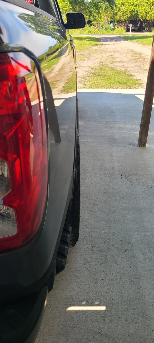

Ford Ranger Visual thread for wheels fitting (explains offsets) 20260512_171227
Stock wheel sticking out with a 25mm spacer. So only 30mm in reality (55-25).
Ford Ranger Visual thread for wheels fitting (explains offsets) 20260512_171219
-10mm sticking out
