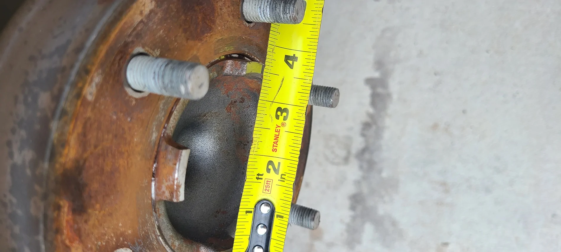

Ford Ranger Hub centric rings for wheels with larger center bore 20260517_103208
This is my axle mounting surface. I took a very rough measurement to show the size. If you end up needing spacers, your truck is 93.1mm as your inside diameter requirement.

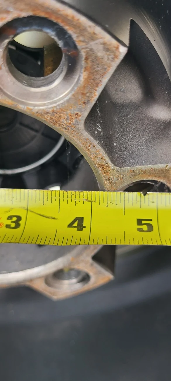

Ford Ranger Hub centric rings for wheels with larger center bore 20260517_103245
Here is my wheel's rough inside diameter. These wheels are actually a very common 106.7 center bore which also fits toyotas, dodge, and chevy so fyi, if you see wheels for sale from a private seller and their vehicle was one of those, its very cheap to put them on your ranger, like i did.

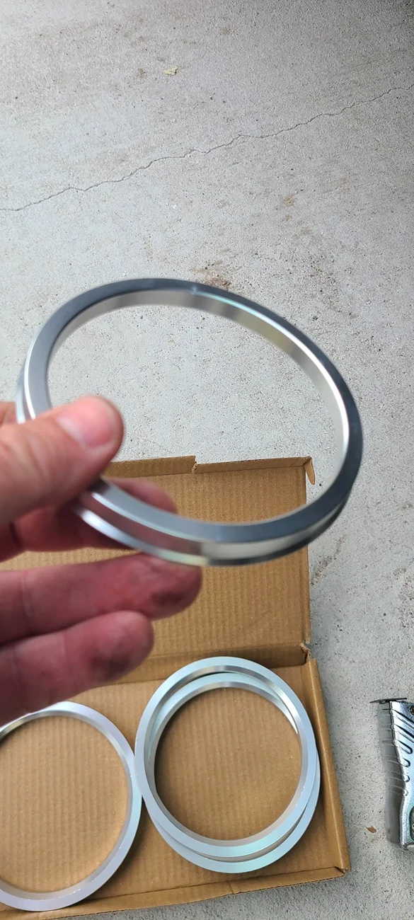

Ford Ranger Hub centric rings for wheels with larger center bore 20260517_103257
Here are my nice aluminum centering rings.

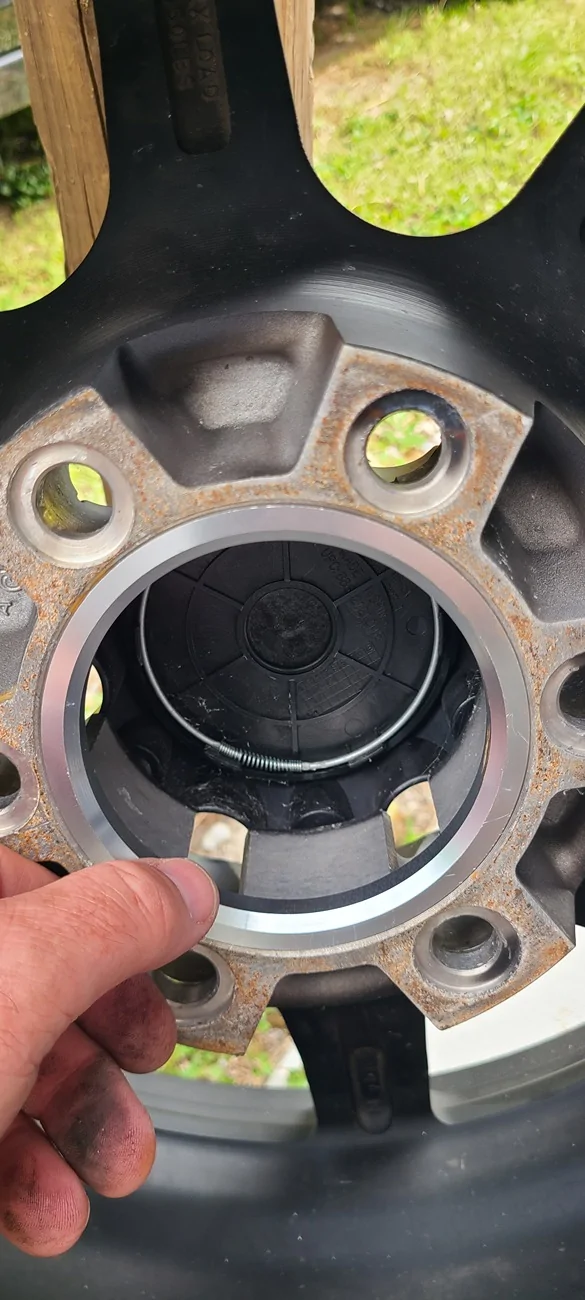

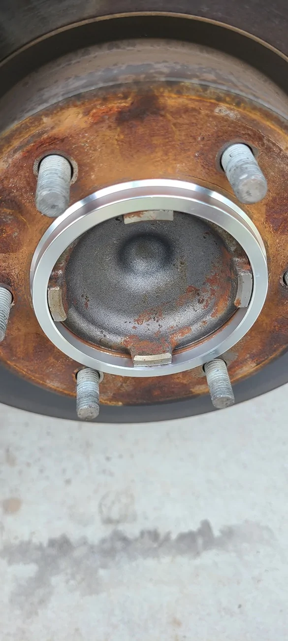

Ford Ranger Hub centric rings for wheels with larger center bore 20260517_103321
They fit right onto my truck hub and also fit perfectly into the wheel bore, exactly like the video dude was talking about. Sweet!
